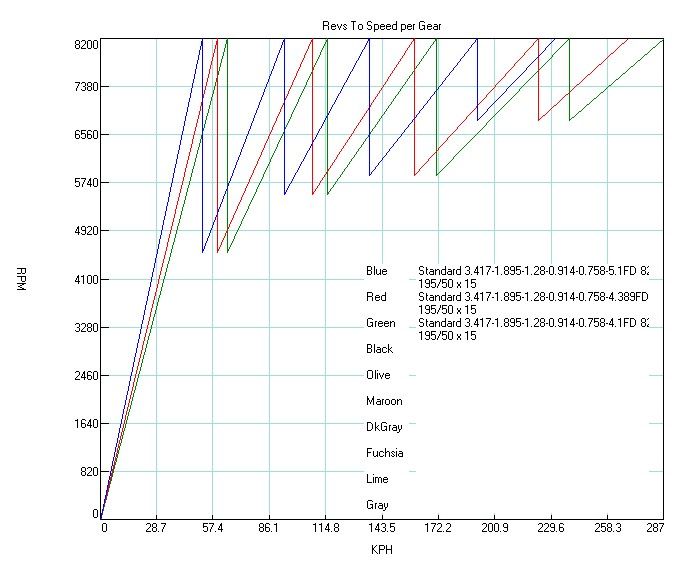

Heres a graph plotting standard gears with different diff ratio's using 195/50/15's, as you can see the road speed changes in each gear but the amount of rpm you drop when changing gears is exactly the same.
So changing from a 4.389 to a custom 5.1 final drive would change 1st gear from 60kph at 8200 to 51kph and 2nd gear would drop from 107kph to 92kph, the big problem there is 1st gear is way too low and the shift from 1st to 2nd means the revs drop from 8200 to 4500.

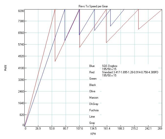

Heres a plot of what you have (red line) compared to a sqs close ratio gearset.
Notice 1st gear is taller but when changing into 2nd gear the rpms only drop to 6000 rpm, when I look at my dyno chart my engine only makes 65hp at the wheels at 4500rpm, at 6000rpm its making 90hp atw, thats 35hp more power to accelerate with :twisted:
