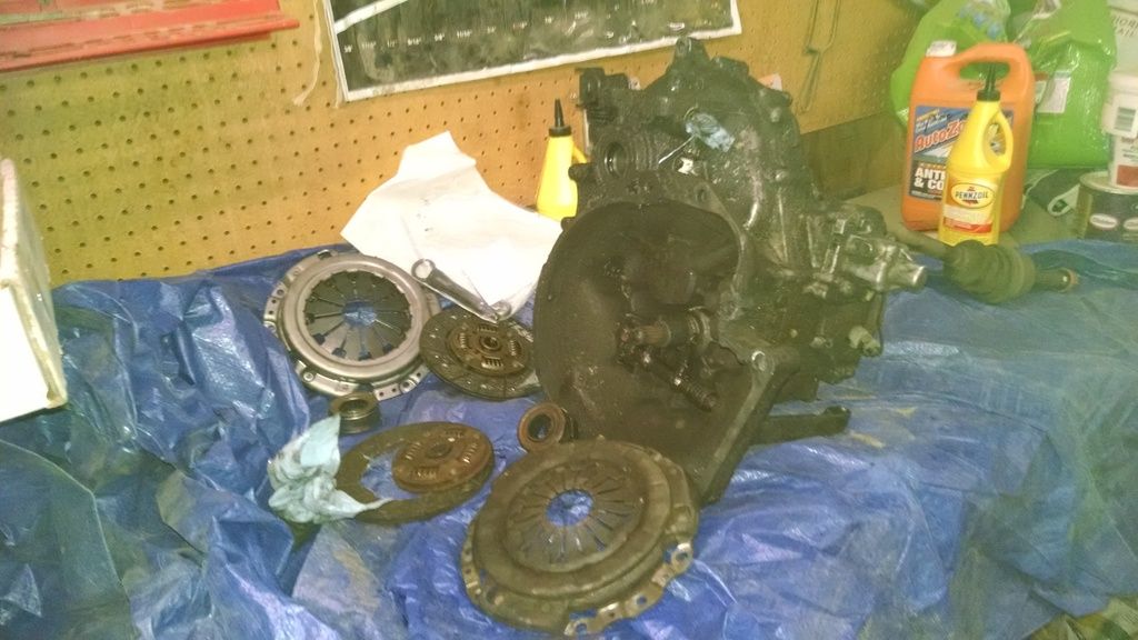

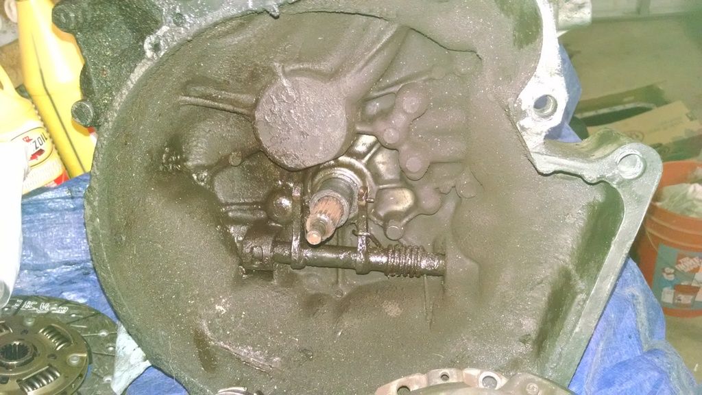

:shock: Kind of excited My first time pulling a trans but sadly I have a bad engine oil leak so its caked especially in the bell housing also I believe I've got a small leak from the trans. Sometimes I would have a hard enough time going into 1st and 2nd gear when its rolling from neutral.
questions:
What should I do with this trans besides the clutch kit while its out?
I think I might pull the engine also to fix the bad leaks and rebuild the head and rings. It seems like it would be an more convenient job while the trans is out.
93 Geo 3/5 with 97 sway bars glowshift tach and a really bad head gasket oil leak :)

nothing wrong with that clutch disk. :wink: if your having a hard time shifting it most likley will be the syncros. now would be a good time to do them, you can get kits for about $80 on ebay. but you do need to be able to press the bearings on and off. but with the trans out now would be the time.
lol that clutch disc is top notch for sure :-P

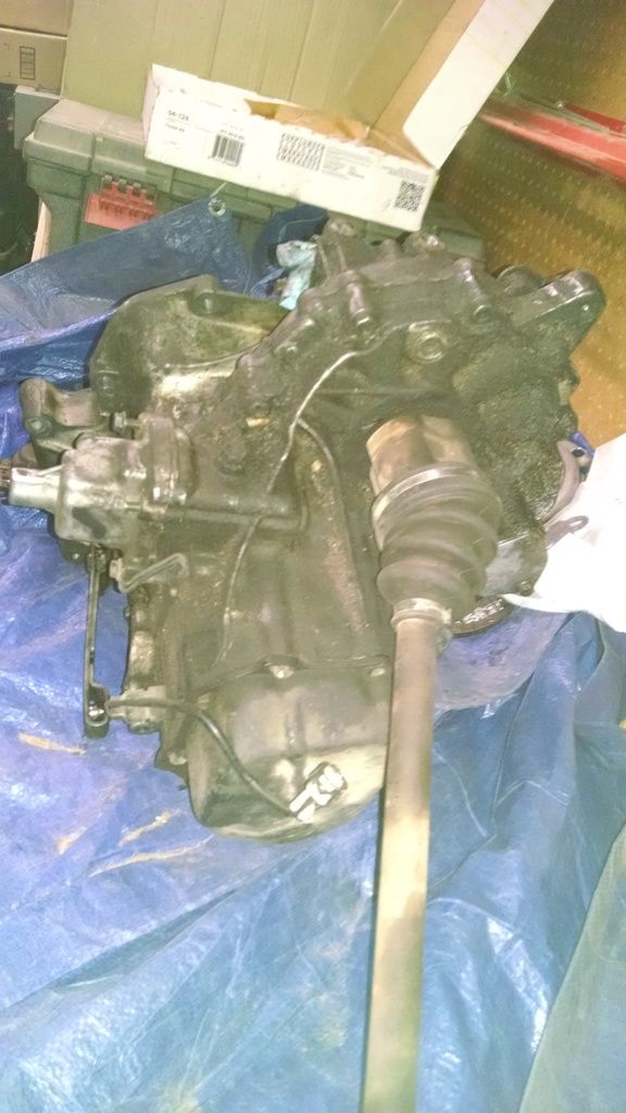

as far as syncros I've never done them before but I've read over some online guides, it doesn't seem like its the hardest thing in the world but the press part concerns me, maybe id have to take the trans somewhere for that? Could the main trans seal need replacing? I noticed a small amount of somewhat liquidish fluid near that. Cant tell if its oil or trans oil though since i had a bad oil leak getting into the bell.

i would also recommend fainya. but if that's not practical if you can separate the case half's and remove the gear shafts you should be able to take them to a shop and have them press everything on/off and install the syncors for you. it is easy but you need a press to do it. and yes. always replace all the seals well its out. at least the input and 2 output seals. if you get the syncro rebuild kit it should come with the 5 syncors and all the bearings and seals. including the shiftier rod seal.
