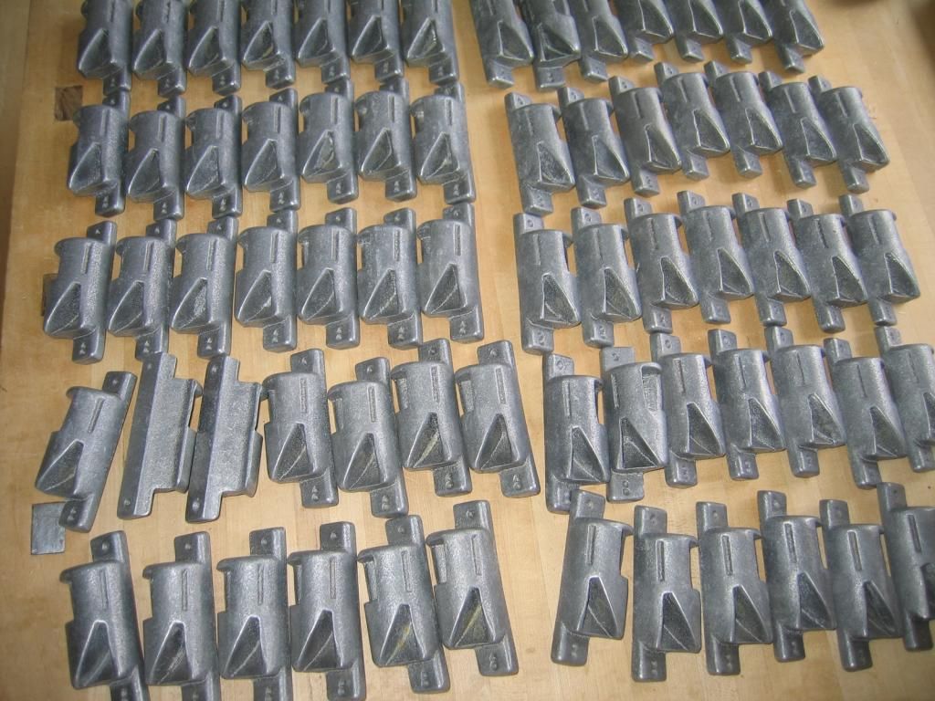

As promised here are the pictures of the latches, they are gorgeous.
I tumbled polished them, all to do is drill the holes.
I will do this and call each and everyone.
IF you want them FAST, paypal will be okay if you pay the fee. Something like $4.00 on a total of $74 plus shipping.
Of course a good check or international money order is fully acceptable.
I'll package and weigh each pair for each buyer.
Thank you for your attention.
