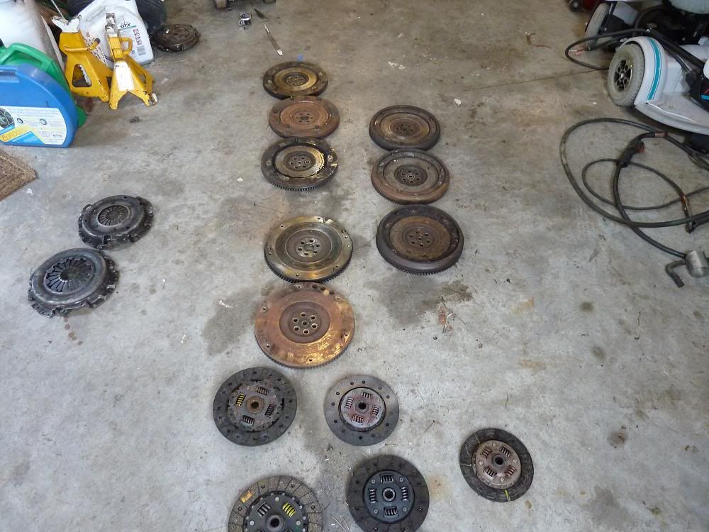

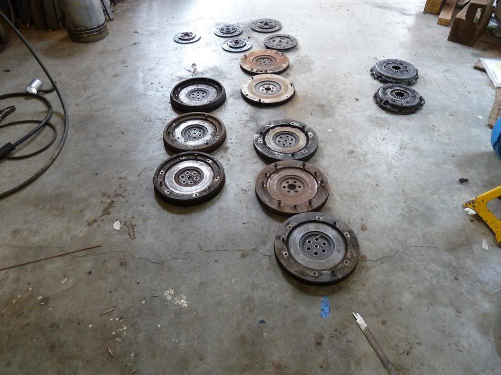

here's some pictures (these are all "G" family flywheels everthing form early G1.0 to late G1.3
the first picture is off a G1.0 (note no balance holes)
the one on the end that looks like yours is a SSGT flywheel...........................................sorry man

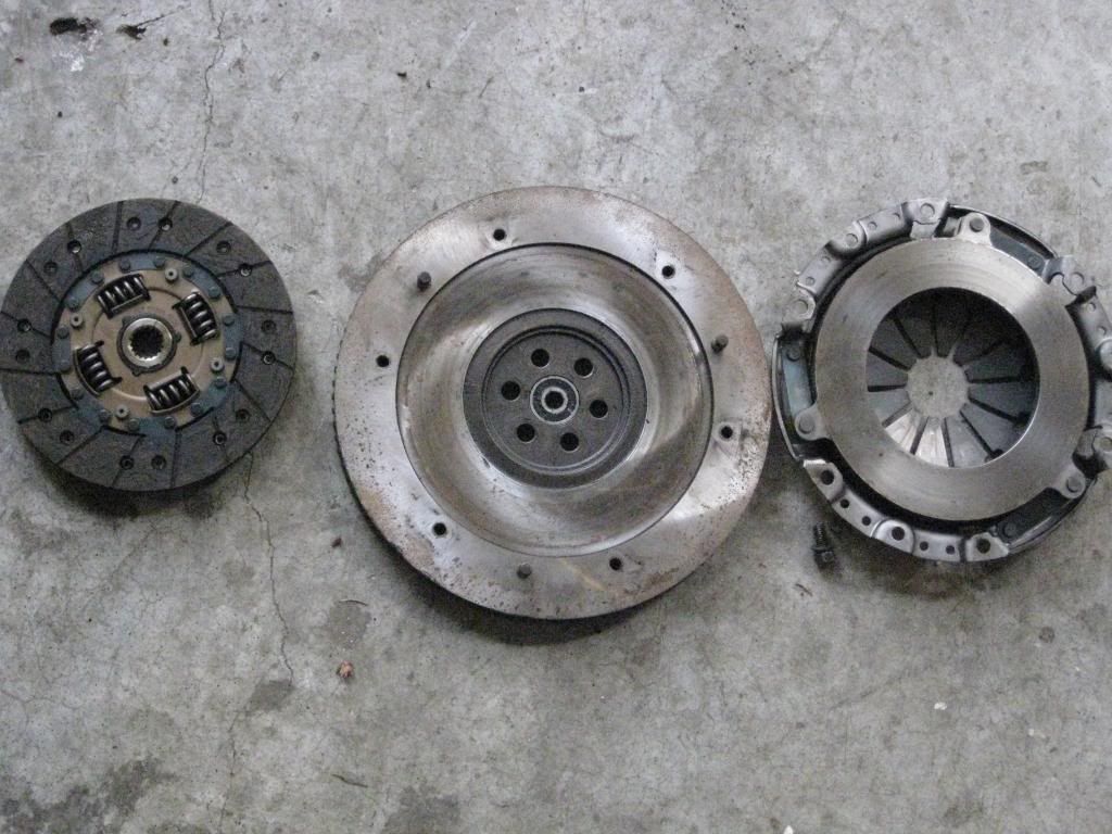

i looked at the g10 flywheel when i got it off and found the balancing drill points on the rear side of that. i looked at another one in the garage and it's the same. the machine shop says zero balanced, 2 tiny high spots on the face that won't amount to a pinch of shit. a couple ring gear teeth have their tops smacked, grinding machine marks are evident on the face - ship it! (to borrow a phrase from my buddy glenn. :lol: )

scotty had me all keyed up about flywheel balance. here's the rear face of the g10 and g13 flywheels. the balance drillings are on the reverse side on the g10. when i hauled it off the crankshaft i paid close attention to the position of those balance points and just as a precaution i mounted the g13 flywheel so that it's drillings were in the same position. also, the exedy pressure plate has an index mark on it that i lined up with the balancing drillings.
here's the g13 flywheel in place and locked down.
