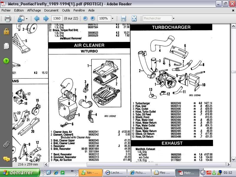

I have the Original part's number for some of the Engine Part's even the Turbo ! See here :
