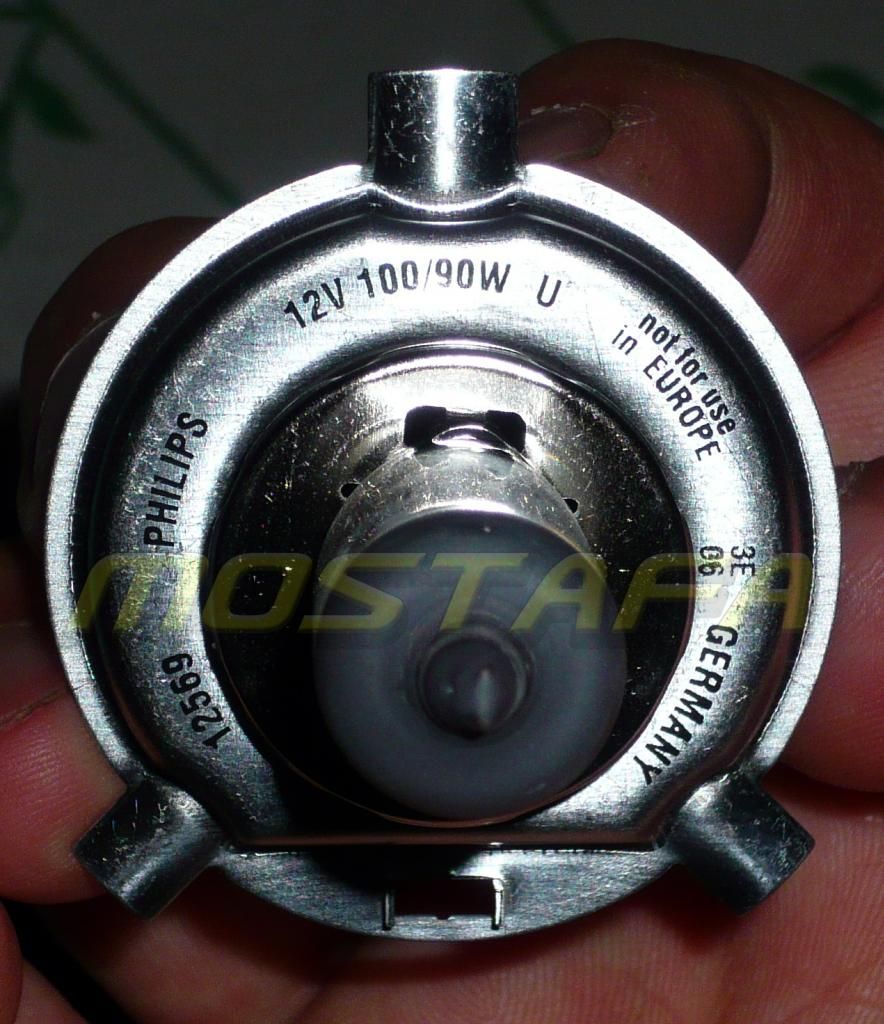

here n Egypt we used to do what you are talking about
in my Suzuki I'm using Philips Rally Vision with dual relay and completely external harness connected to battery
this gives me intense lighting in severe conditions, these lamps wattage is about 100/90 Watts
