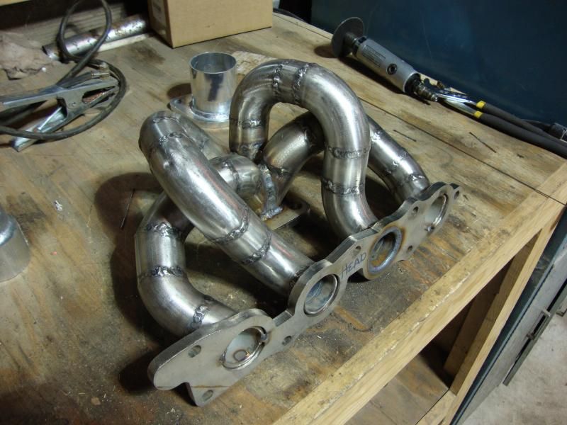

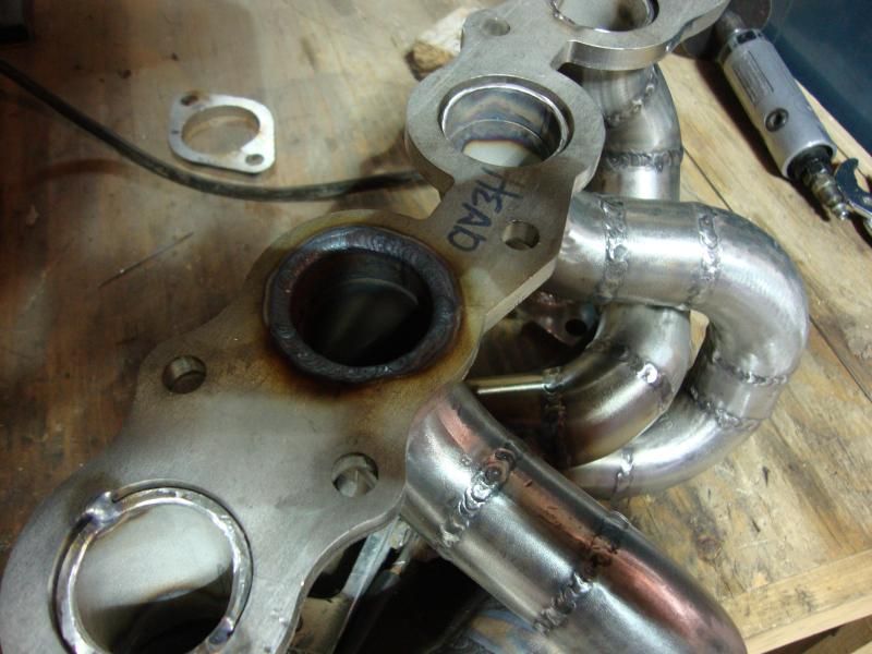

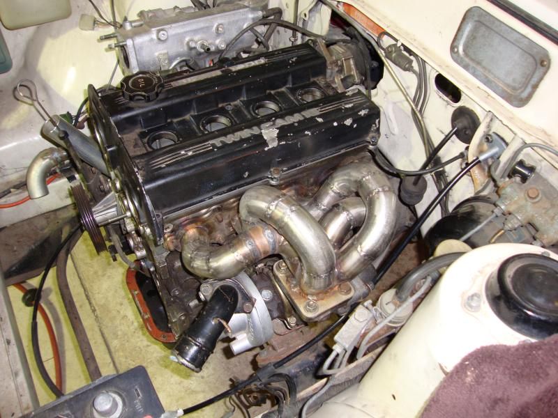

Got it back in the shop and started making progress again. Put my spare engine in to mock it up and teaching myself to tig weld. I'm happy with the results so far as it's my first attempt at it. Manifold is 304ss 1-1/4 ss weld elbows.

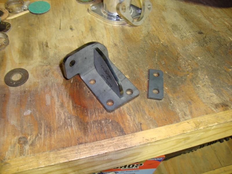

Got my clutch cable bracket lasered up and formed, ready for welding:
