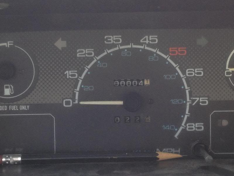

The 207,xxx miles rolled over last night. Note the fuel gauge reading and tripometer mileage. I think I have 407 miles on this tank of gas now and there is still more to go.

PostPosted: Mon Jun 10, 2013 8:23 pm
208,000
:shock: :shock: :shock:
Wow.
It just hit me.
Man you put the mileage on...
We have a fuel pump which makes a weird noise when we turn on the ignition, but you can't hear it when going down the road.
It is in this car:
which has 238,138 miles as of today.
Hopefully, you can turn back the hands of time during your next 30,000 miles on that body as you catch up to me.
Most people look at the mileage of a vehicle FIRST before buying it.
