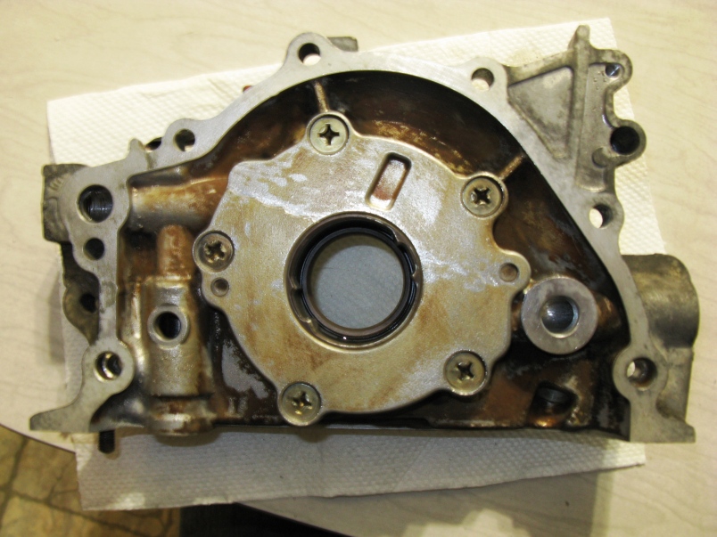

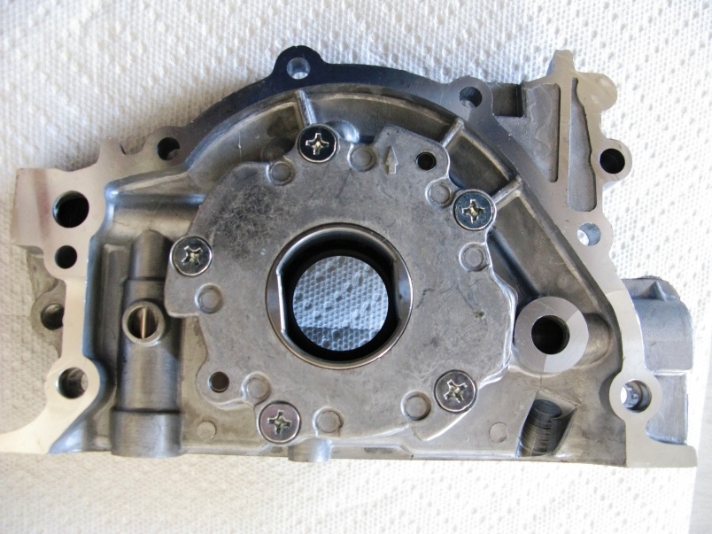

I thought this would be a good place to post the differences of the various oil pumps. I've seen lots of it posted around here, but finding any real compilation has been avoiding me. I've grouped the oil pumps to their respective engine series. I've also arranged them from smallest to largest in pump capability, but I lack the photo's to show the pump size differences.
G10/G13 SOHC 6V and 8V
Bypass Spring Height: 43.68mm
Bypass Spring Coil Diameter: 1.55mm
Rotor Size: 50.47mm inner and 60.40mm outer
Rotor Lobes: 10
Rotor Thickness: 7.97mm
Outer Rotor Diameter: 73.98mm
G13 DOHC - Still need one...
Bypass Spring Height: - - -
Bypass Spring Coil Diameter: - - -
Rotor Size: - - -
Rotor Lobes: - - -
Rotor Thickness: - - -
Outer Rotor Diameter: - - -
G16 SOHC 8V and 16V, 95 and earlier.
Bypass Spring Height: 45.93mm
Bypass Spring Coil Diameter: 1.57mm
Rotor Size: 54mm inner and 60mm outer
Rotor Lobes: 9
Rotor Thickness: 8.90mm
Outer Rotor Diameter: 76.01mm
G16/G13 SOHC 16V - Crank Position Sensor Equipped Models Specifically, atleast according to the aftermarket pump listings, appear to be the same pump as the G16 without the crank sensor provisions.
I'll be adding the pictures and info as I can get them.

The G16 also has a bigger diameter pickup pipe.
PostPosted: Sun Apr 17, 2011 11:47 am
Oh, and if you can afford it, do buy the OEM/Aisin pump as the casting and machining is miles ahead of what you get with the 'Made in Taiwan' pumps. The front of the pump doesn't actually line up to front of the block, it's off by a mm or two at the back corner, where the oil pan meets.
