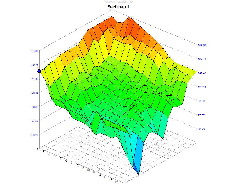

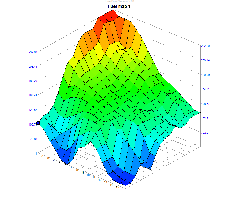

Fuel maps:
F6
I2/I6 (I can confirm they are the same)
210/340

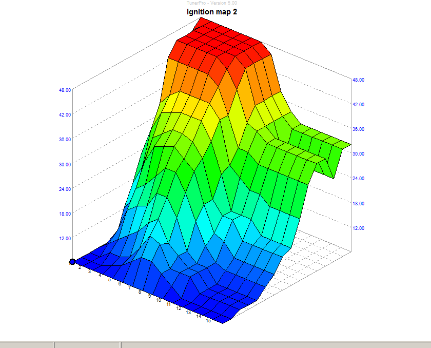

Ignition:
F6
I2/I6
I2 alternate fuel map ? (I did not capture this one, downloaded from Rhinoman)
210/340
I figured out what the socket booster is doing--it only reads the first 128k of the chip. Hence the OEM chip won't work, but the 210/340 chip, which has the program burned on it twice to work in both F and I series ECUs will.
All of the eproms I bought are written to FFs and need to be erased, so I'll need to pick up a pacifier sterilizer :lol:
Because the only empty chip I had right away was a 512k, as an experiment I modified a bin to use the 8600 rev limiter (or so I thought) keep closed loop, substitute stock values where the 210/340 was leaner than stock and use the 210/340 ignition table. I wrote it four times to make it a 512k .bin and successfully burned it to the chip.
Unfortunately I should have edited the rev limiter by hand because tunerpro wrote both values to 7310 instead, so when I went for a test drive the car shut off completely at 7310, confusing the crap out of me until I double checked what I burned :oops:

Teeth, what are the units of measure on the axis of the spark and fuel maps above?
 Post subject: Re: chipping ecus
PostPosted: Fri May 24, 2013 7:52 am
ABI wrote:
OK, now I'm interested in this thread!
I wish I knew! That's one of the problems with this approach--it's not too hard to find the tables in the code, but it's another thing to figure out what the conversions are in Tunerpro. Degrees of advance is easy enough, and it doesn't take too much thinking to figure out which axis is MAF and which is RPM, but units for fuel? Unit conversions for RPM and MAF? We're dependent on Rhinoman as apparently the only person in world (or at least on the internet) that has created an .xdf definition file for use in Tunerpro.
But it doesn't seem to be impossible to figure out--I plan to look at some other .xdf's available for more popular cars to see if I can learn how it's done and start adding the unit and axis information.
The software is free and you can get a head start by downloading Rhinoman's .xdf. I've attached the bin from the I6 chip so there's something to play with if anybody want's to help!
The bin file is NOT a .zip file, just change the extension back to .bin. Not sure what's up with the forum's limited attachment options :(
