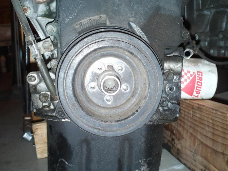

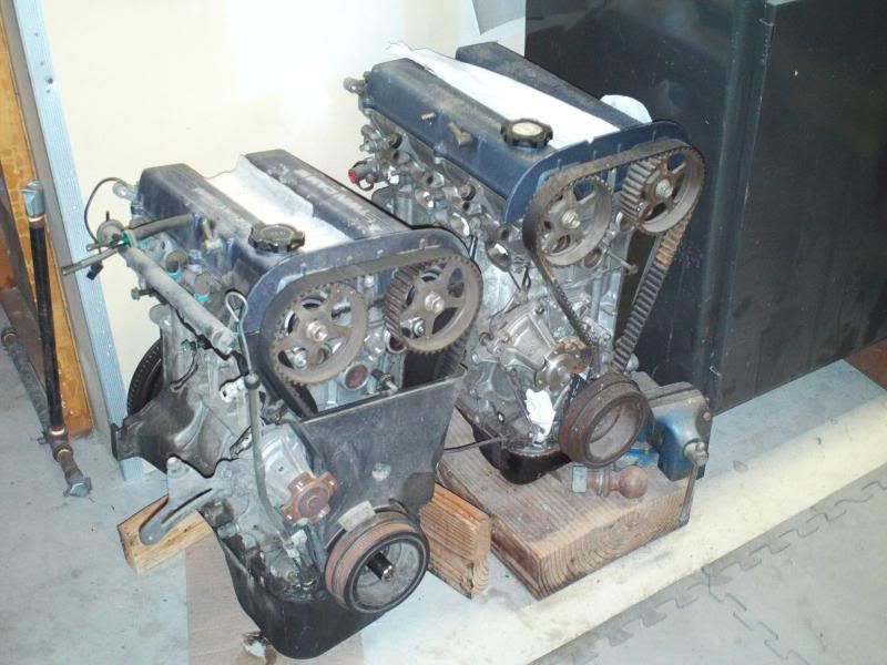

I started to pull the engine on the left apart and ran into a slight problem.
The bolts which hold the main crank pulley (missing from photo) were 5 mm allen heads.
Your typical allen wrench wouldn't touch 'em.
Don't waste your time.
You'll end up screwing up the heads of the bolts or worse.
Get the right tool for the job.
That meant a visit to Fleabay and a purchase of a 5mm allen/socket.
Sometimes you've got to be patient. If you get in a rush (in this instance) you'll be moving one step forward and two steps backward. Best to wait until the right tool arrives.
Patience was rewarded with a simple yet effective $4 tool
and this little rig was all it took to pull those 5 bolts out.
Nothing was damaged and they will be reused.
They may have had a little loctite, because I had to give them a pretty decent whack to break them loose.
So, if you run across those allen heads, take the time to clean them thoroughly and let them dry.
Don't try to use an 'L' shaped allen wrench visible in top of last photo above) and remove them by hand. You'll screw up the heads. If you are trying to do this with the engine in the car, I don't envy you.
Hit 'em with an impact rigged up with a 5 mm allen as shown. Don't be afraid to give them a good whack.
Problem solved.

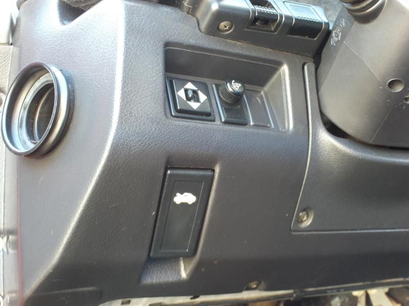

Back to Rrrr:
Thanks to my friends to the North, I was able to take this:
(a hood pull)
and make this:
look like this again:
The only way they could have broke the original was to put their monkey hands on the top of the
lever and push down.
A civilized person would use ONE FINGER and simply lift from below to achieve Nirvana.

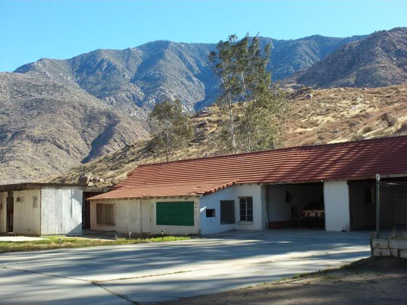

It has lots of potential, but will require rolling up your sleeves and getting off your duff...
The main attraction for me wasn't the three car garage:
(which needs doors :oops: )
I like the other side of the property which has a 75' by 70' shop:
which will house all of our cars, bikes and trucks with room to spare.
All good things come to those who wait, or so it is written.
In this case, it will take some elbow grease also.
