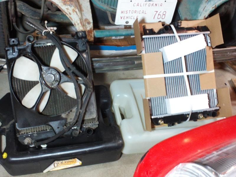

While I was in L.A. I snagged a new radiator for very little money.
After the axles were in and tight, I tied off the automatic transmission lines
unbolted, unhooked, and unplugged the whole mess then pulled it straight up and out.

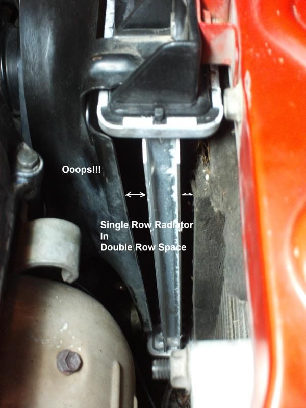

The new radiator side by side has all the correct inlets, bolt holes, transmission coolers, and outlets
BUT
it seems to be a bit thin:
Last night, I took it out to the 'drive through' for a burger and the temperature never went above 2/3.
However, when cruising along the freeway, she drops down to 1/3 on the gauge.
What do you think?
Is it a keeper, or should I put in a double row?

Leave it in for now because it's the start of winter but when you start seeing Floridian type temps I'd keep a sharp eye on that guage. If you find in the warmer weather it isn't working for you, I know someone in cooler climates who would probably take it of your hands. :lol:
 Post subject: Re: Phils toy
PostPosted: Thu Oct 06, 2011 2:58 pm
I had one of those in my MK1 for a short while,
seemed to hold the same amount of coolant overall.
Never did see a problem with the temp.
You might want to work up a seal on the sides,
the fan is going to pull air from the least resistance
and you won't get proper airflow through the rad
with those big gaps.
I was using duct tape as a quick fix,
which I'm sure makes you cringe, the purist you are. :-P
I was going to work up a sheet metal or aluminum plate
mod, but eventually upgraded the rad to an aluminum
one from Ebay. Very nice and priced around 2 bills.
It didn't sit right with me, the thin core and plastic tanks,
not that it didn't function correctly, but the aesthetics of
it all.
The alloy rad was for a swift, and I had to file up the holes
in the top mounts a but for a perfect fit, but I'm sure it would
bolt up just right on your rig.

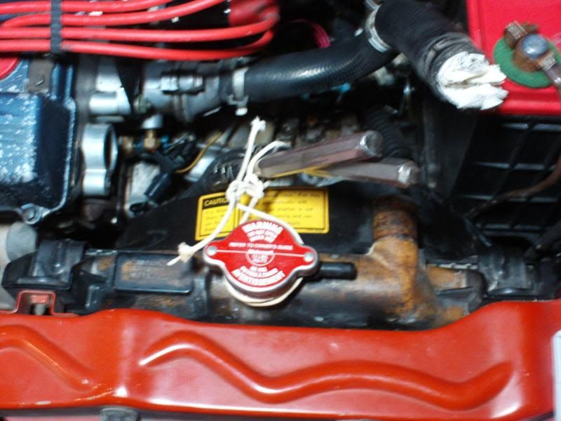

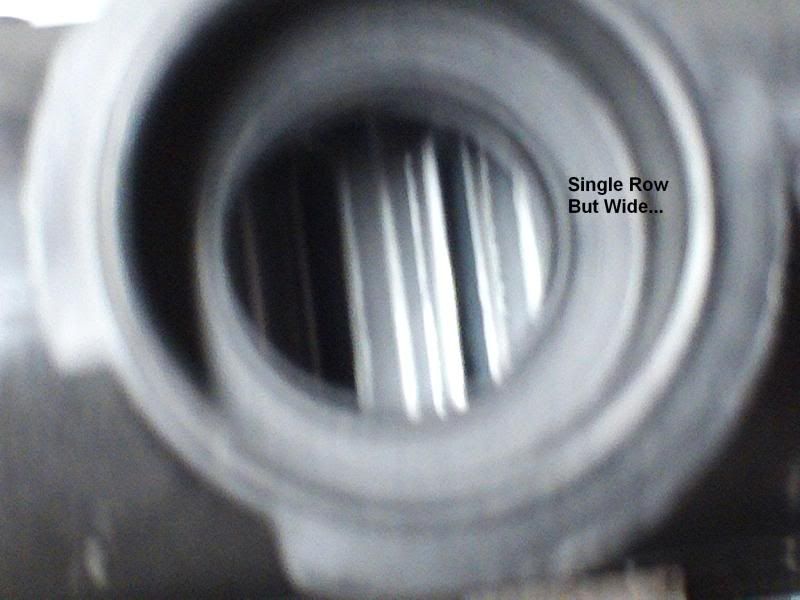

Ah...back to the update:
It's been about 3 weeks, and progress is one step forward, two steps backwards:
The new 'one row' radiator got returned.

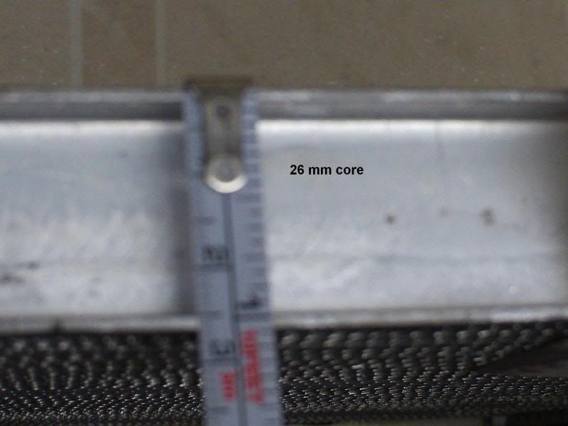

Its capacity was decidedly less than the original 2 row. It probably would work for a SOHC 8V Swift, but this DOHC probably deserves better.

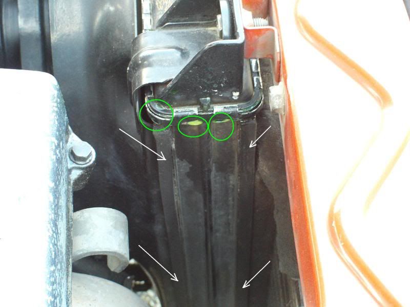

The old radiator got a good soak in white vinegar for a couple of days.
Then, new foam rubber (white arrows) was put on to replace the deteriorated stuff.
The radiator cap was leaking, as evidenced by the green circles.
We've swapped in an old cap from a different car and blotted up the antifreeze to see if that fixes things.
The overflow tank has been at the 'full' mark for the past 3 weeks, so it is a minor, minor seep.
According to "The Boss", the old two row radiator is doing a better job now.
She is going by her temperature gauge, which isn't too 'scientific', but I trust her vision better than mine.
That means the vinegar soak and new foam rubber were good things, but returning the one row radiator was an unfortunate backward step. It would have been nice to have it work because it only cost $50, but sometimes you get what you pay for. As time progresses, we'll get a new two row; certainly before Summer.

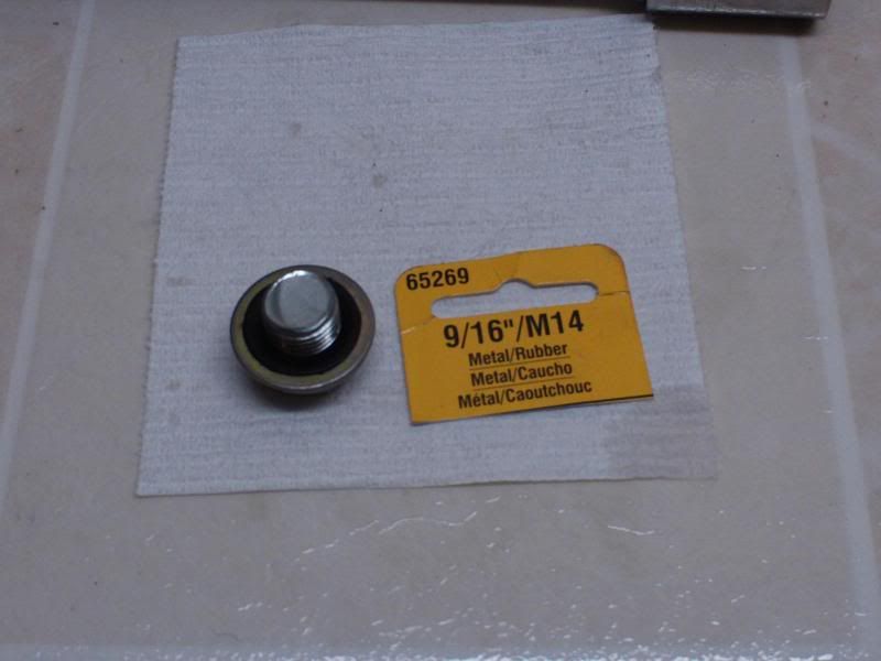

It has almost been two weeks so here's a little update: the idle valve replacement gives the car a much more 'tame' personality on start up, even in cold (20F) weather. There is no 3500 cold idle anymore. It fires right up, and barely hits 1500 rpms until it the engine warms. That is a big help, as with an automatic, you don't want to slam it in gear when the idle is at freeway speeds. Also, in the cold North America weather, if you decide to warm up the car, it isn't out in the yard screaming like a banshee while the neighbors are trying to sleep.
Although I am not completely satisfied with the engine oil leaks, it was time to change the oil.
We had some Mobil 1 Extended Performance oil and filters in the garage, so I stuck some of that in it.
It is a nice oil, but what I wanted to mention was the oil plug.
If you are changing oil, some people change the oil plug each time.
I don't.
But I do swap on a new oil plug gasket/washer.
Here is what I use:
complete with a part number.
You can use that washer and plug combination several times with no oil leaks.
Every couple years, I've been switching in a new washer, and still no leaks.
Also, if your parts are clean when you put them back on, you won't have to torque them so tight.
It seems every oil drain plug I remove has been over tightened by the previous owner.
I understand you want to 'err' on the side of being too tight, but you can damage the oil pan threads.
With the new washers, even if the drain plug is barely more than finger tight, it won't leak.
Next time you change your oil, think about using one of those metal/rubber washers.
They are pretty substantial and were not available years ago.

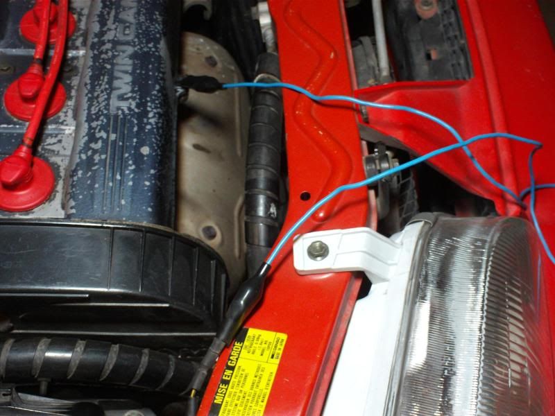

After that oil change, I noticed the oil 'idiot' light was out on the dash.
This weekend, the opportunity to fix it presented itself.
First, I removed the garnish and pulled the instrument cluster out just enough to reach those little bulbs in the back. No way it was possible to reach up from underneath with my big mitts.
After installing a replacement bulb, the light still wasn't working. :oops: :oops: :oops:
That meant the problem was somewhere else.
On a GTi, you have to pull the oil filter to get at the oil pressure sending unit, and when it was visible, it looked to be a new unit.
Aha. Maybe the previous owner had a problem with that light as well.
I clipped a wire directly to ground and then to the place where the spade connector attaches.
Still that oil light wouldn't light.
So, still using my 'high tech' instrument:
with one side of the alligator clip on the bullet style connector behind the headlight (routing for the oil pressure sending unit is different than a Metro) and the other alligator clip to a good ground the oil light on the dash would light. That meant the problem was between the 'bullet connector' and the oil pressure sending unit, leaving only one piece: the wire. Somewhere, it was bad.
I pulled the wire
and cleaned it up with the usual (toothbrush, Purple Power/Simple Green, water rinse) and then inspected it with a digital volt/ohm meter. The wire needed fixing at the end where it attaches to the 'spade type connector' which attaches to the oil pressure sending unit.
Once this connection was cleaned up, a new length of fresh wire was inserted and crimped, the oil pressure light on the dash worked as originally intended.
Total cost: $0.
Knowing that the light works? Priceless.

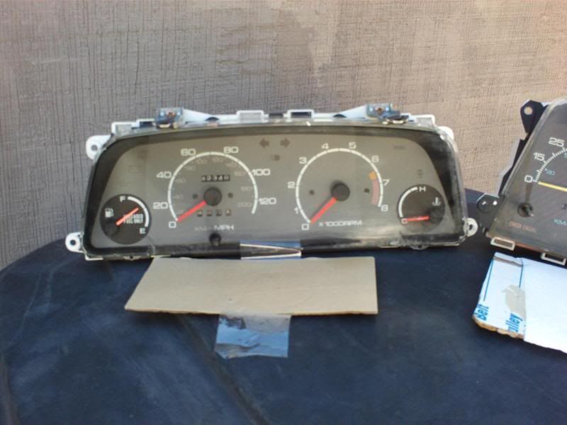

They came from the factory, with a speedometer and tach.
As far as I've seen, only one year (1989) had the automatic stock.
It's the same transmission as the Sprint and early Metro.
And she keeps it under 4500 rpms (hopefully :oops: )
The damn thing is hell on wheels.
I would tear it up if I was to drive it on a daily basis. :twisted:
She'll probably never wear out the tranny as she's a lot easier on the car.
If I was to stuff a different instrument cluster in there, it would have
more numbers on the speedometer.

Last week we did the steering wheel cover.
Today the new radiator arrived...
It was a bit of a disappointment.
The core size is a little small, at 26 mm:
and it arrived well packaged and unharmed.
I called the guy and he claimed that he had the warehouse check visually and verify.
They said it was a '2 row' radiator.
Although it does seem to have wide 'rows',
that looks suspiciously like a 'one row' radiator to me.
It is a Spectrum Premium CU1168 radiator for the automatic, and the inlet and outlet are correct, as well as the rest of the dimensions.
Perhaps it will bolt up and work for most applications.
Maybe I'll run it and see how it does during the hottest part of the summer and some real traffic with the A/C going on high.
They included a little insulated piece of 16 gauge wire, so you can ground the thing.
However, there's no flange on the sides of the radiator to put a sheet metal screw.
So, just a heads up on the Spectrum Premium radiators.
They are packaged well, and will bolt up fine, but they are not 2 row.
