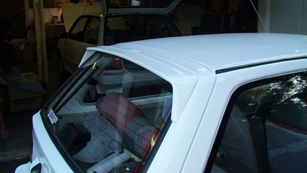

Hey Meenhaj. The Spoiler came from a seller in Newcastle Australia. I went to Reglinegti.com and searched for people selling mk1 parts and just sent emails to everyone selling mk1 parts. I got lucky :D The lip came from a friend of mine here in the Bay Area. I restored it myself.

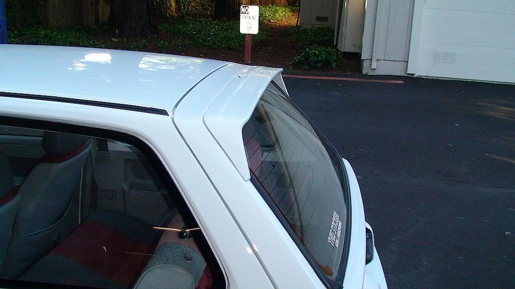

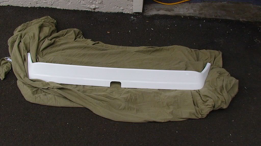

I got the spoiler back from the paint shop yesterday :D so today I headed over to Taiso’s place. I can safely say that we are now experts at attaching mk1 spoilers. We used 3m double sided tape as a gasket material , had to adjust the screw holes slightly, and make a couple trips to the local hardware store, but in the end it was worth it.

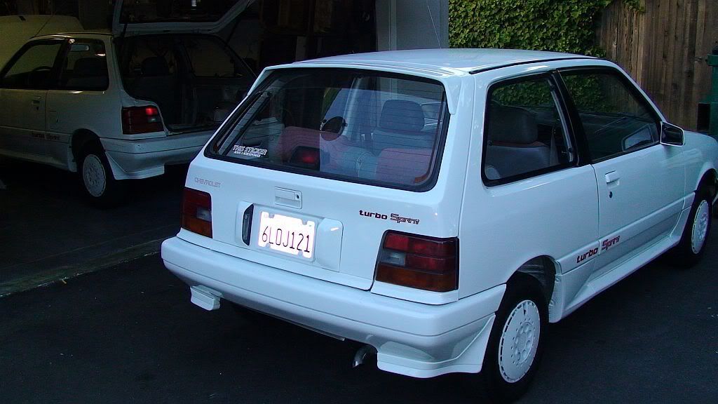

Thanks for the posting the pic, that’s DTM GTi’s Swift I believe. I’ve seen some pics of it before, it’s a really nice mk1. It looks like he crafted his spoiler out of a sheet of aluminum, it’s really nice and possibly weighs a lot less then an oem wing.

You are correct; that is indeed DTM GTi's car in the picture above.
He did have to fashion some minor adjustments for his engine mounts.
When he took me around the block in it, the car seemed fairly peppy and is the only Euro Specs I know of in the USA.
It was surprising to hear that his spoiler does not look OEM, but rather something fashioned from aluminum.
I was under the impression he had simply done as you,
and bolted it on from his donor car, like he did with his Euro Specs front bumper.
As they seem quite similar.

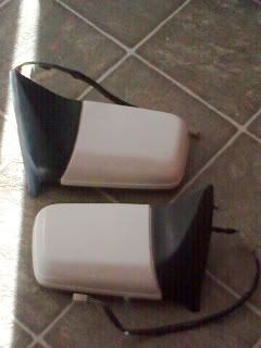

His mirrors certainly don't look like mine.

Regarding the spoilers, my main point was that his car looks incredible and both spoilers look great.
Regarding his mirrors….
They're mk1 Swift GTi spec. I picked up the set and I was going to put them on the the Sprint before it went to paint but I decided to keep it stock at the last minute. Maybe someday I’ll do the change up.

Yes, your spoiler is quite nice.
Perhaps his is Lexan.

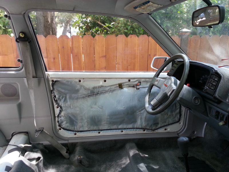

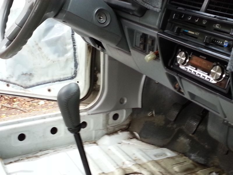

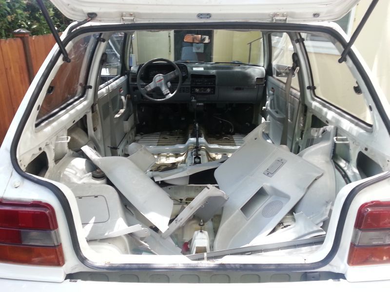

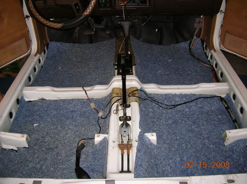

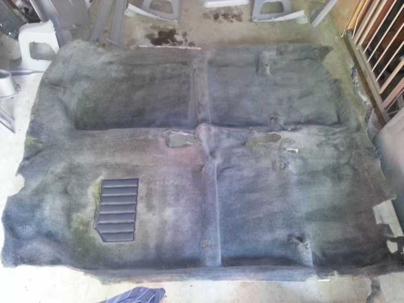

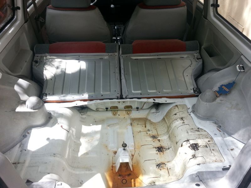

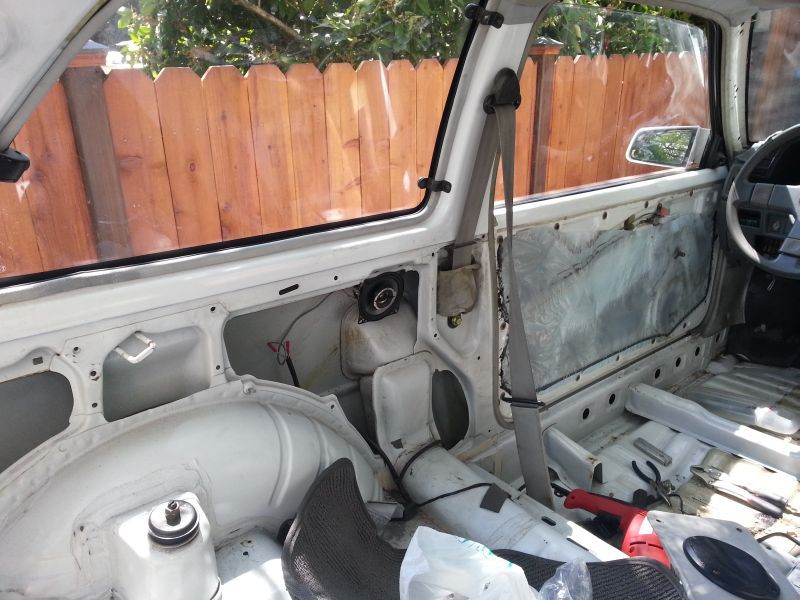

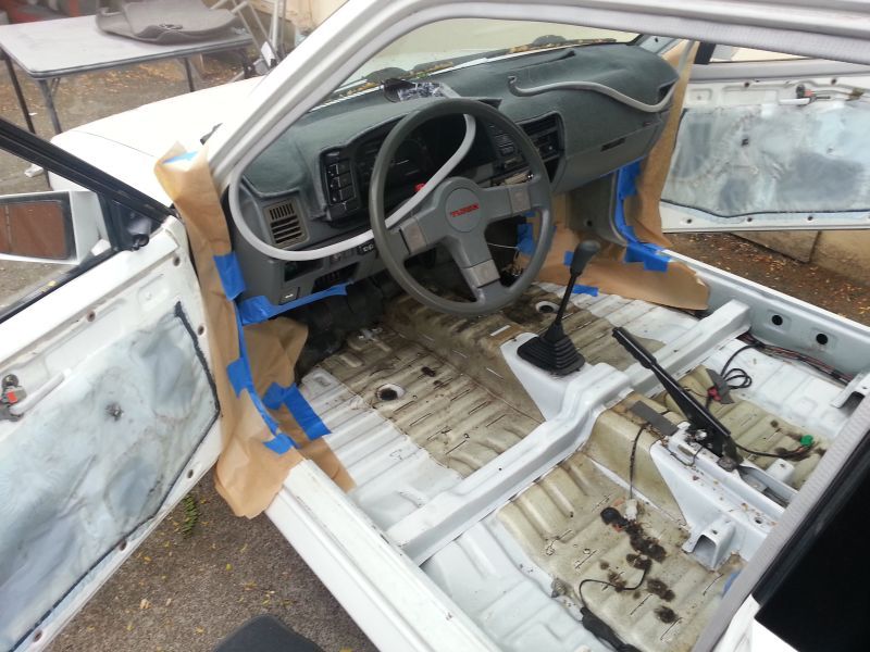

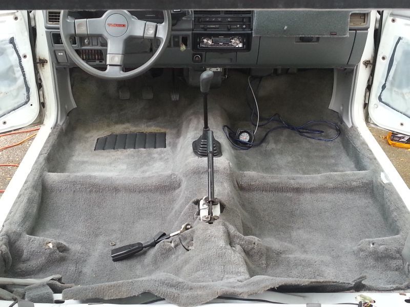

Had some time on my hands so I called up Taiso and we proceeded to strip the interior out. I was also able to deliver the seats to the upholstery shop. This weekend will be about cleaning and dynomating.
Before:

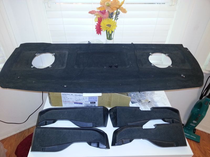

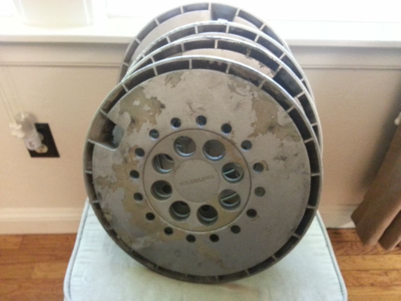

I received some more goodies from down under today. I'll have my upulstry guy recover the tray in vinyl color matched to the vinyl on the seats and the wheel covers will go to the paint shop to be cleaned and resprayed in Cue Ball White :D
Rear package tray + 2 sets of mounts, draw strings and attachments.
13" 24 hole wheel covers!!!!!

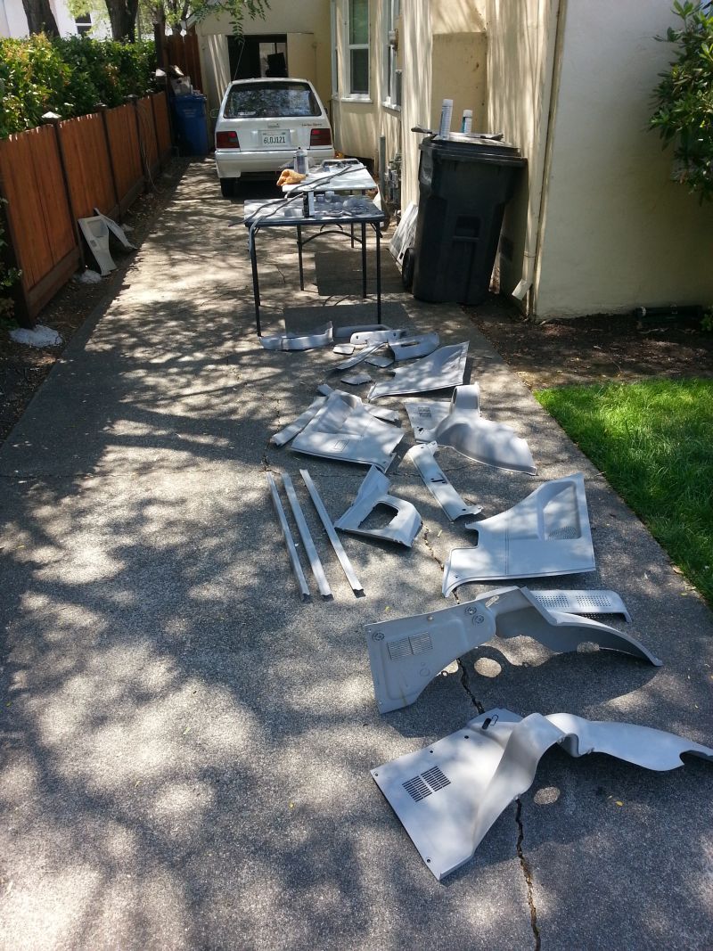

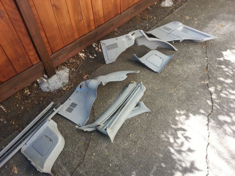

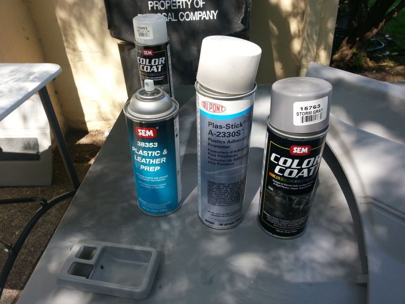

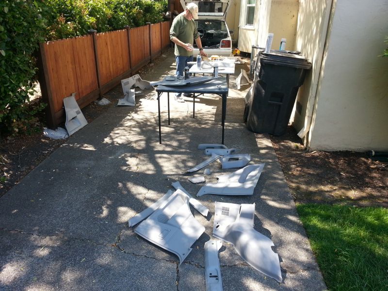

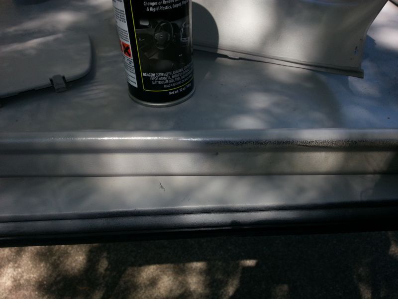

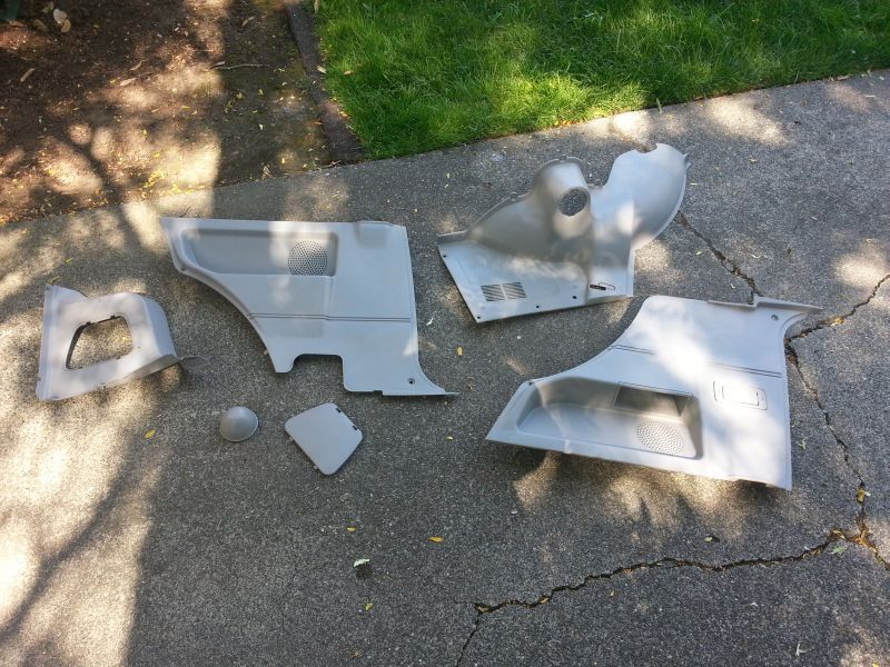

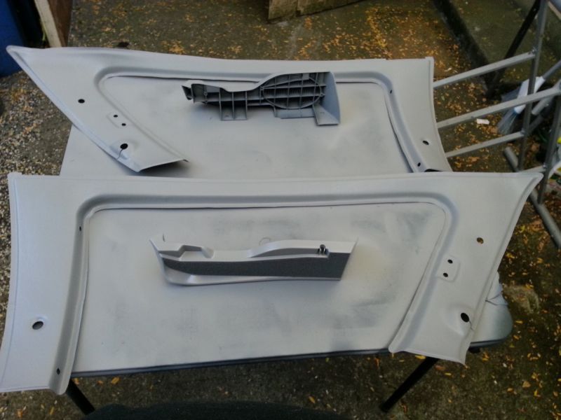

Today was the perfect Northern California Summer day, it wasn’t too hot or too cold and there was a light on shore breeze. The birds were chirping and the squirrels were playing. It was the perfect day for setting up a hammock and falling asleep, OR setting up a interior panel restoration assembly line and working your butt off .

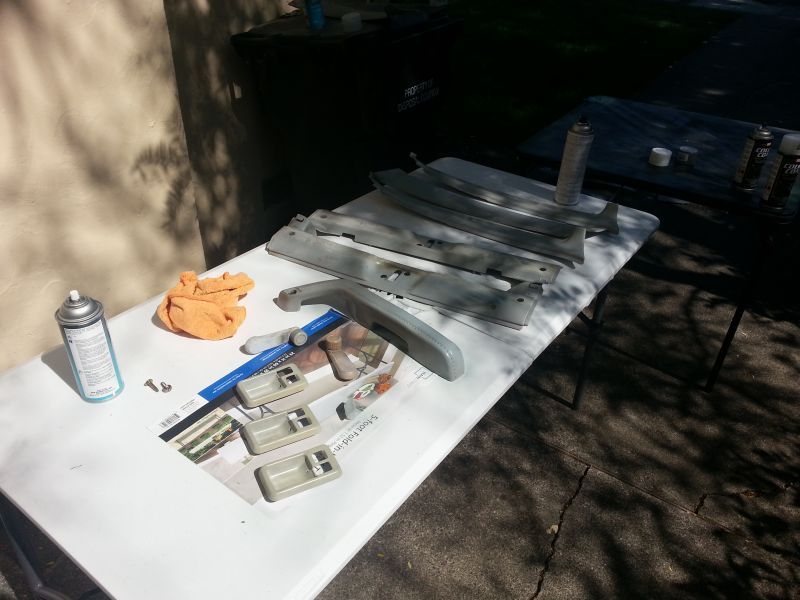

Ben came over and we set up a system Henry Ford himself would be proud of (maybe.) We took all the panels I have acquired (at least 3 of everything. Many will be for sale in a few days) and lined them up next to the fence.
We set up the white table as a cleaning and prep table
and the black table (slowly becoming the grey table) as the paint table.

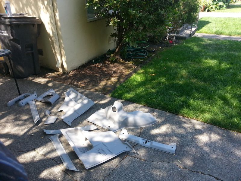

We started by cleaning everything with a rag and SEM Plastic and Leather Prep. Next we sprayed Dupont Plas-Stick to everything and let it set. Lastly we applied SEM Color Coat Storm Gray which is an almost an exact match to the stock panel as it was new. The finished products were then set on the driveway to dry.
As the morning wore on the completed section kept growing and growing.
Ben in the background while I slack off and take photos.
The results speak for themselves. The re-painted piece is on the left. The darker section on the right piece was covered by the rear seat and faded less.
Re-sprayed half on the left.
The door panels seem a bit more tricky so I’m going to take them to my upholstery guy and see if he can redo them.

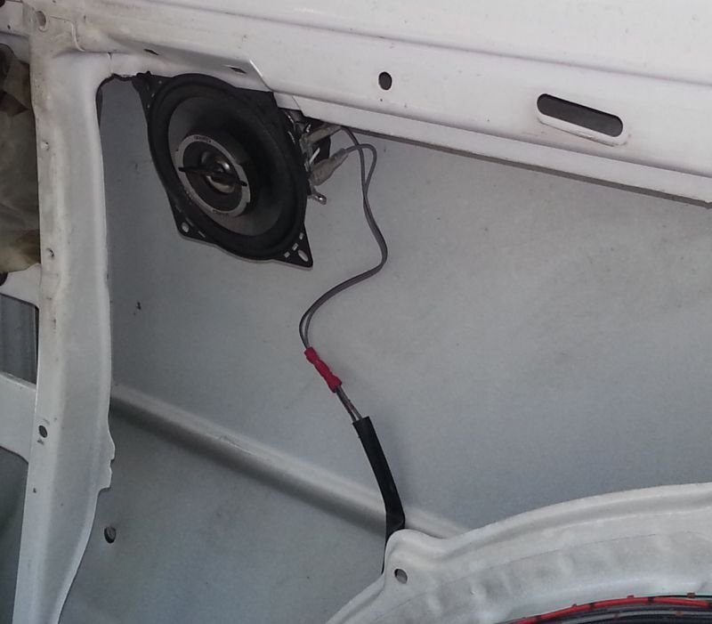

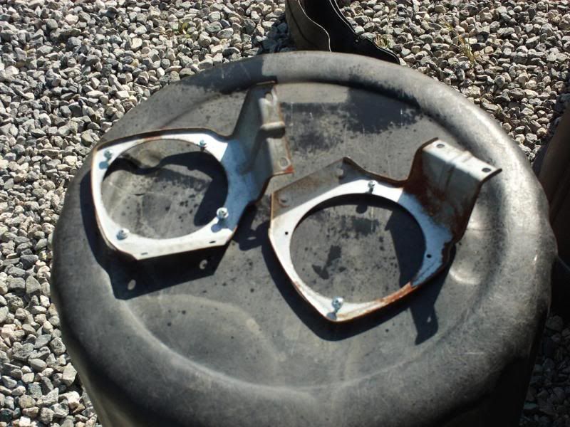

On another note. Yesterday my good friend Aaron came over to help with speaker installation in the rear seat panel area. I didn’t want to cut up any panels so the gaping holes next to the rear seats seemed like a great place to start. He found that Suzuki had already run speaker wire to each side of the rear seat and had just left it there ready to hook up. Thanks Suzuki!!!
The wires coming out of the wheel well to the red connectors are stock.

PostPosted: Wed Jul 11, 2012 11:24 pm

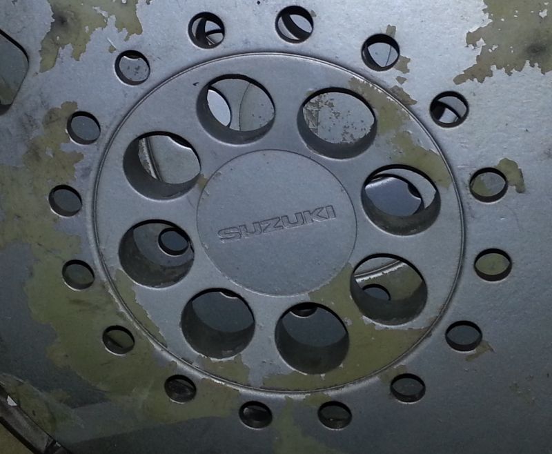

Have you seen these?
8)
Cody up in Canada says they are the little known MK1 rear speaker mounting brackets, and ...
I'm not going to argue with him.
:lol:
PostPosted: Thu Jul 12, 2012 12:03 am
Posts: 164
Location: Santa Rosa, CA USA
OHHHHHHHHHH..............actually it makes sense. The 2 screw holes for mounting line up perfectly to the 2 holes above where i put the speaker.
WOW, I never thought I'd see something like that, didn't even think it existed.
Thanks Phil. I was totally content in my ignorant state and you had to go and educate me. :D
Now the search begins for speaker mounting brackets!!!
PostPosted: Thu Jul 12, 2012 9:16 am
Somehow, I KNEW you'd begin searching for a set.
...and the other two holes line up with the vertical mount.

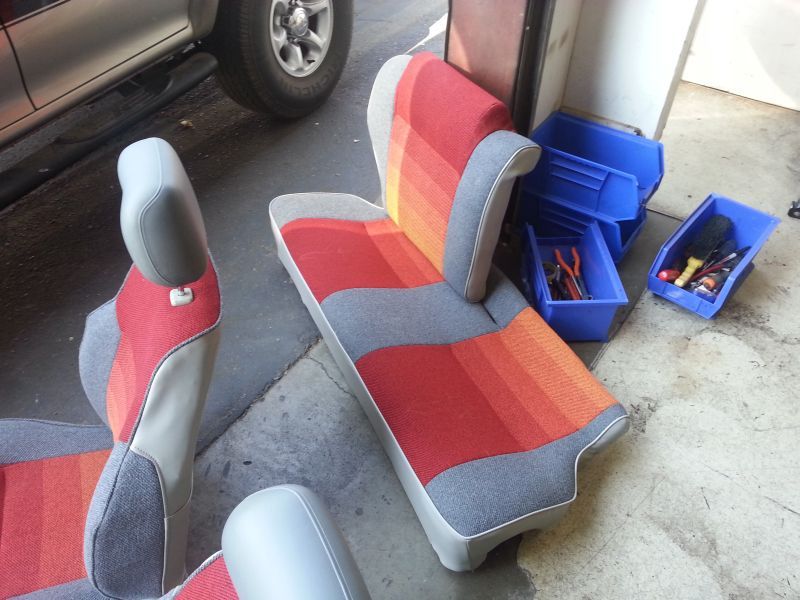

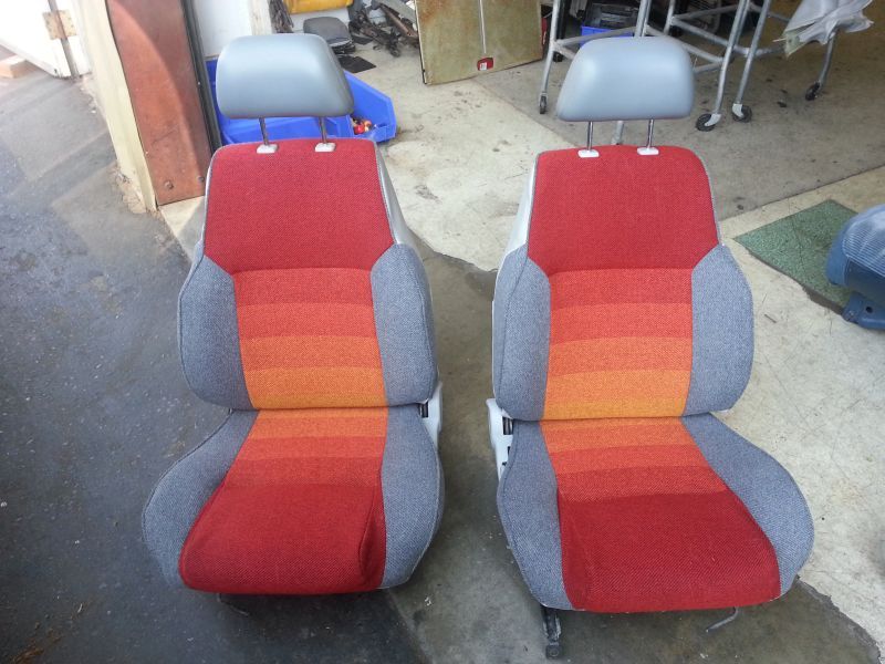

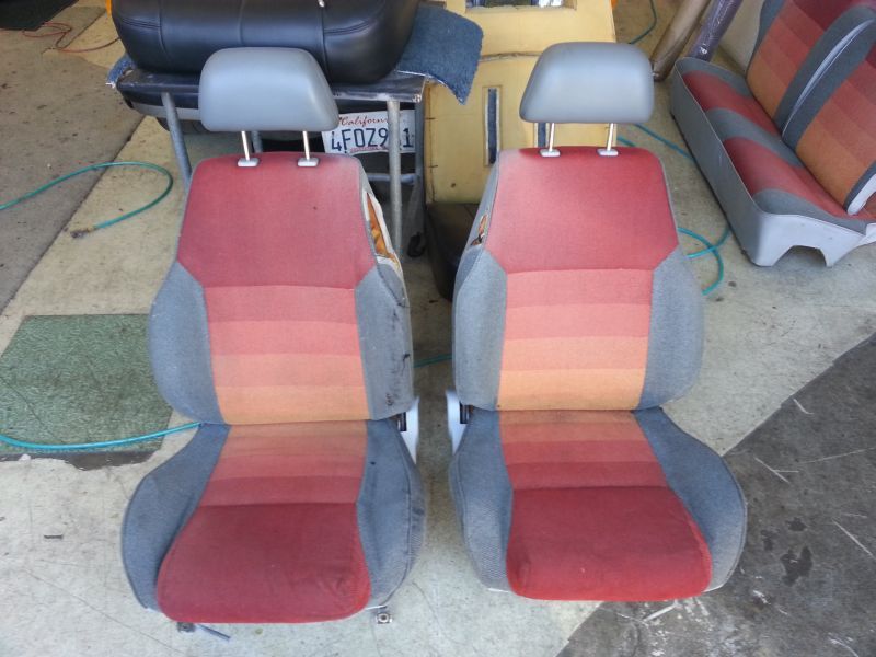

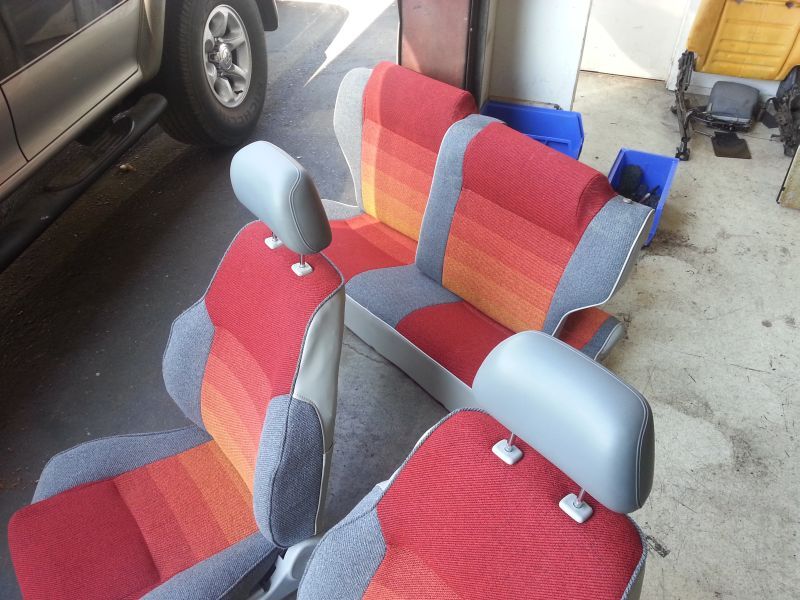

When things come together and start happening, there is this snowball effect. After nine months of getting nothing done with the Sprint as I searched for the right seat fabric, everything is now happening at once. Last week we pulled everything out. Tuesday the speakers were installed. Wed the panels were painted, and today the carpet was professionally cleaned.
OH, and I got the seats back from Carlos!!!!!!!!!!!!!!
So without any further adieu. I give you……..The before & The after…….Enjoy
Before
After
Before
After
These seats were made possible thanks to Carlos and his incredible team at

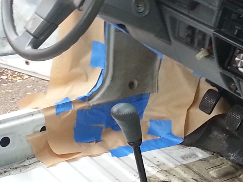

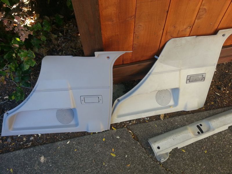

I taped off, prepped and painted the kick panels
Before
After

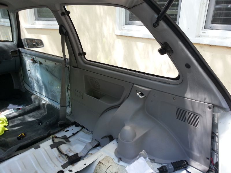

Ben came over and we installed the carpet
We then re-painted, and installed the rear upper quarter paneling which requires the removal of the rear window and the rear window trim.
Lastly, the door trim, the scuff guards, and the A pillar panels were installed.
