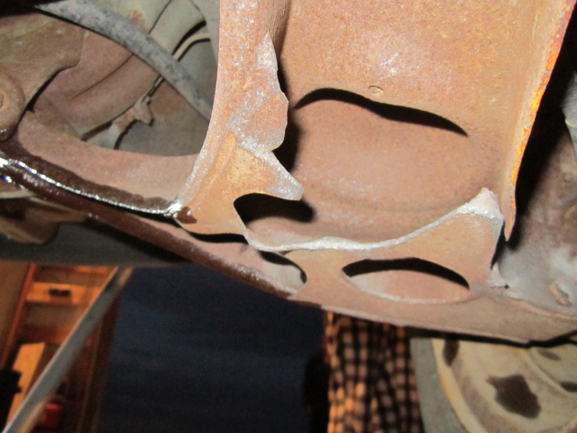

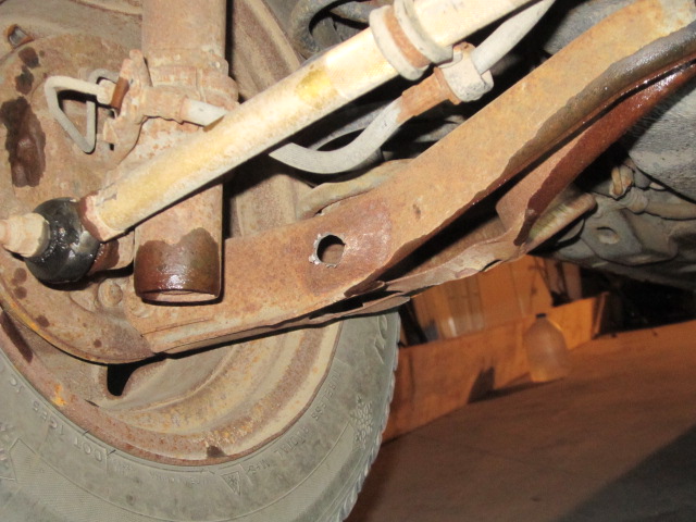

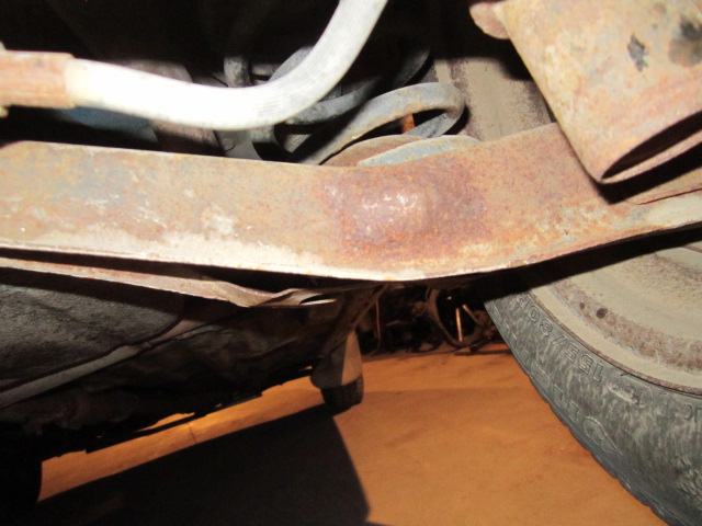

noticed some suspension damage on the rear.....damn gravel roads pounded a hole thru the suspension arms....looks like a bullet hole
other side is almost pounded thru
in rough shape
go thru my pile of parts, find a good pair, do some welding on them to try to prevent this from happening again :roll:

oh my! a patina of rust as is on the bottom of your car would drive me to distraction! :twisted:

A little rust? Nothing to worry about. A little WD-40 (and/or < insert Eastwood product name here > ) and she'll be as good as new!
PostPosted: Thu Oct 15, 2015 8:37 am
:-P the gravel road keeps the mud from sticking ANYWHERE on the bottom of the car.....kinda like sandblasting, only a lot more aggressive..... :shock:
that's why I want one of my cars as a daily driver, gravel is murder on anything under the car....even the rockers are ''gravel-blasted'' clean.......had to replace exhaust pipe at curve around the fuel tank, that was hammered almost flat.... rear bumper skin has holes/ cracks from the gravel.....gas filler tube all chewed up as well....
mudflaps help a little bit, but even those are showing signs of wear :roll:
once a year I spray the underside with ''gravel-guard''- but I may need something more durable than that, or spray it more often...... :-P

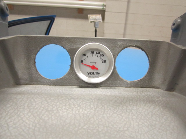

finally mounted my gauges- :roll: they had been flopping around under the cup-holder in the center lower console :roll:
volt and oil pressure in there currently, extra hole for temp gauge. now to mod a t-stat housing for a sensor.

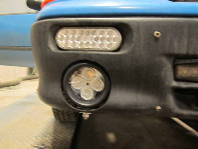

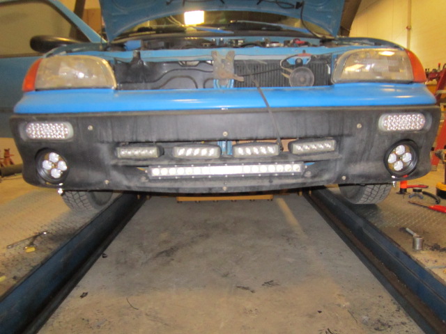

installed more lights in the front bumper
40 watt 4 inch led lights, spot beam spread. add another relay and switch for them as well.
now to add extra bracing to the already flimsy bumper :roll:

PostPosted: Tue Feb 09, 2016 8:37 am
I like the work I'm hunting those light now.
Can you tell me were you got the MR16 light.? ( the round L.E.D.)
How much.?...thanks......jvs
''BLAZER INTERNATIONAL ''brand led, part #CWL510
I think I paid $70 or $90 each.....cant remember :huh: (Canadian prices :roll: )
3,500 raw lumen, 2,500 effective lumen (damn bright 8) )

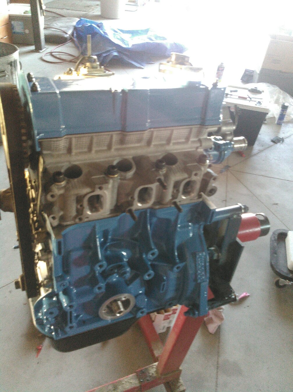

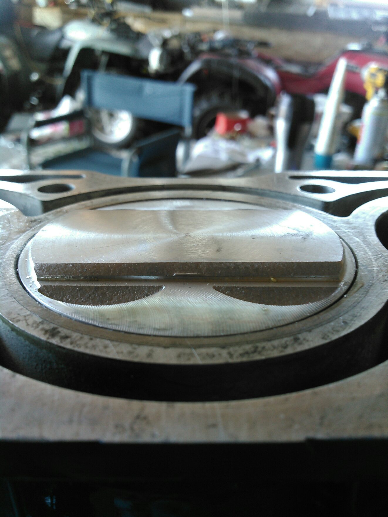

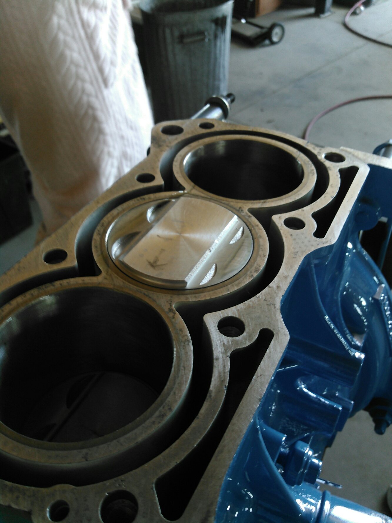

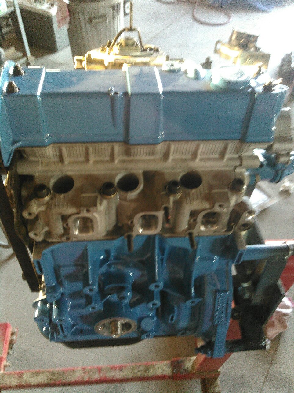

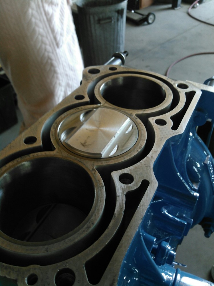

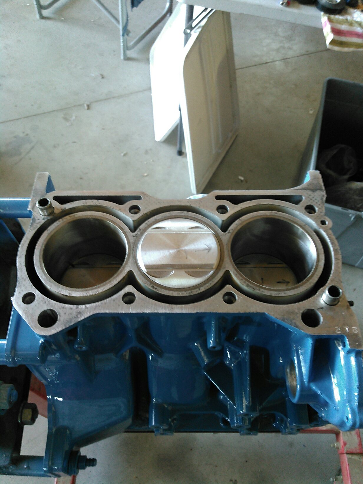

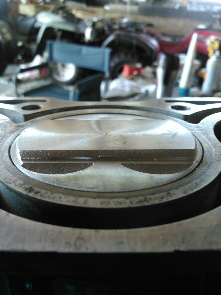

So some progress has been made on the engine rebuild.
Pistons are installed, oil pump and other bits. All clearances were within specs.
Painted the block and oil pan last night, also spent some time port-matching the cylinder head.
P-29 pistons, 11 to 1 squeeze ratio!
that was my long week-end. now to get a timing kit, water pump. those bits are on there for mock-up only, just to make sure it all turned easy, made sure there were no odd noises.
PostPosted: Tue Sep 05, 2017 6:33 pm
Posts: 8042
Looks good. Curious to see a compression reading with those pistons
