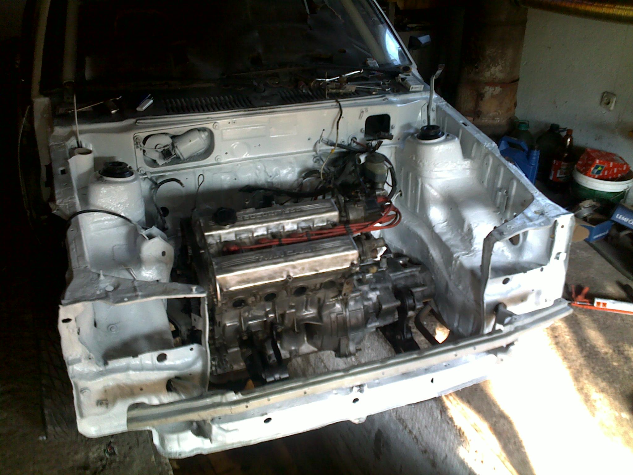

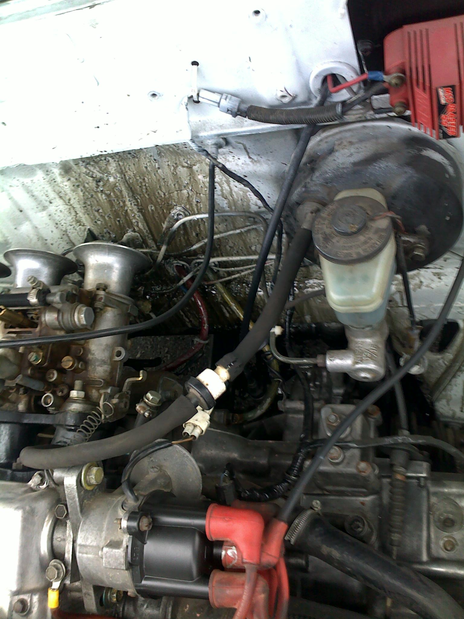

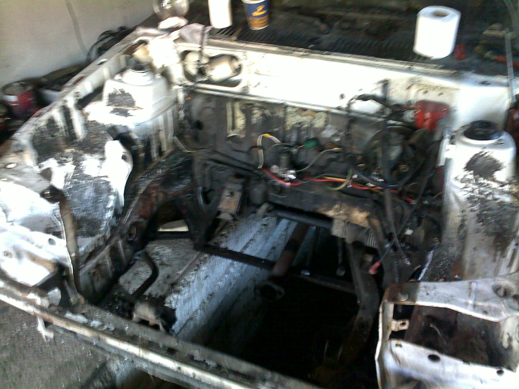

Cosmetics...engine bay painted and the whole front of the car was spot welded .Also changed the gearbox.

When you say spot welded, what is meant by this? I have heard of seam welding for racing cars...is this the same? I would like to do this with my celica alltrac. Any pics of the welds?
Cheers!

I cleaned everything the I welded 2cm with a 2 cm gap.
From what i've heard continous welds aren't good for the car .
Oh, is that because you would still want to have some degree of flex in the unibody chassis?

Exactly, if you weld everything without leaving gaps you could develop cracks around the weld since it won't have any room to expand or contract or flex.

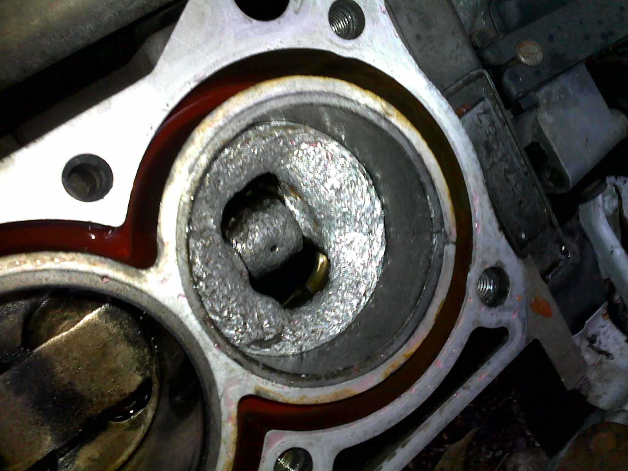

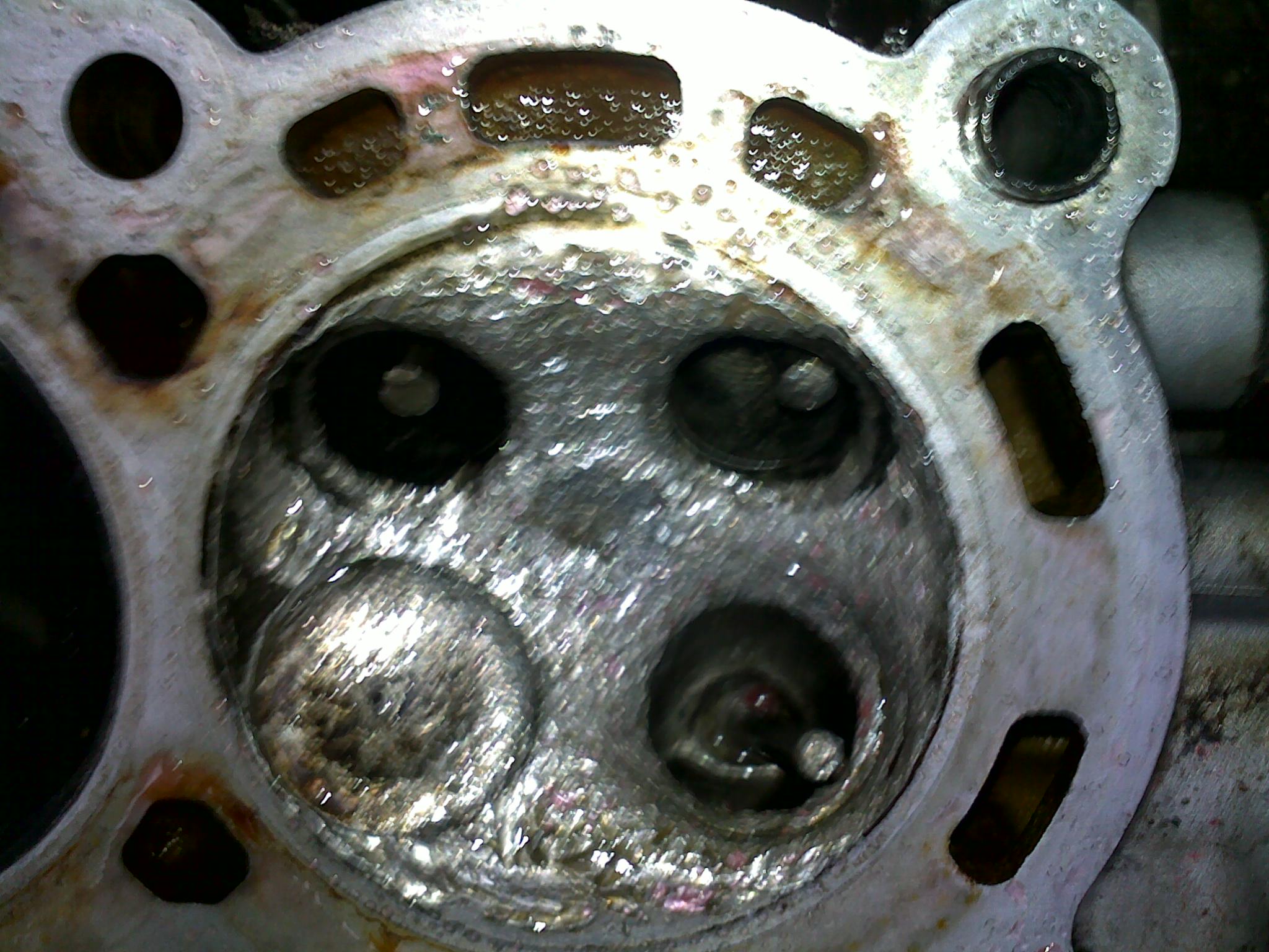

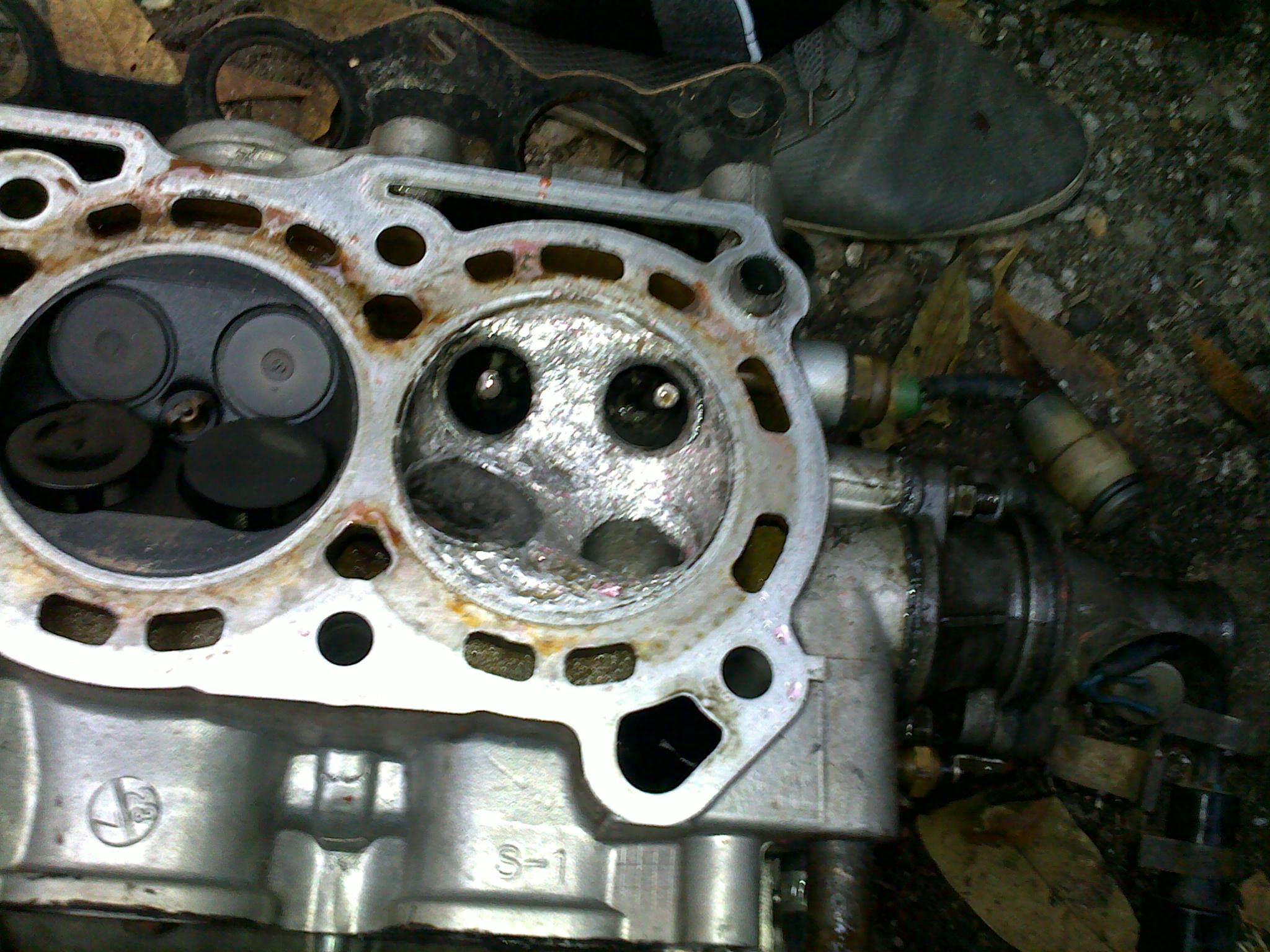

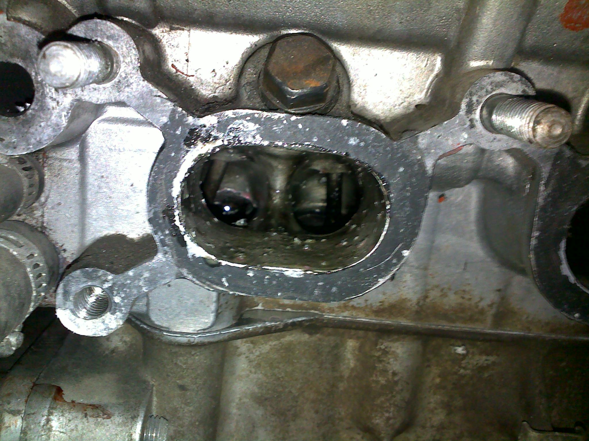

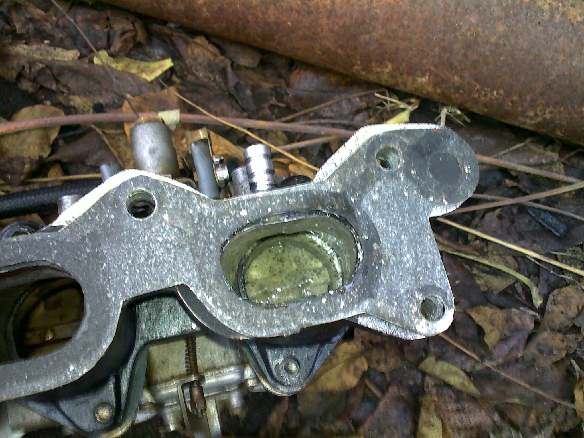

This year ended rather badly , I missed 3rd and shifted to 1st while doing 9000 rpm in 2nd.
Still no1 in the 1.4 class but the damage to the engine kinda put me down. This winter will be all about rebuilding the engine .

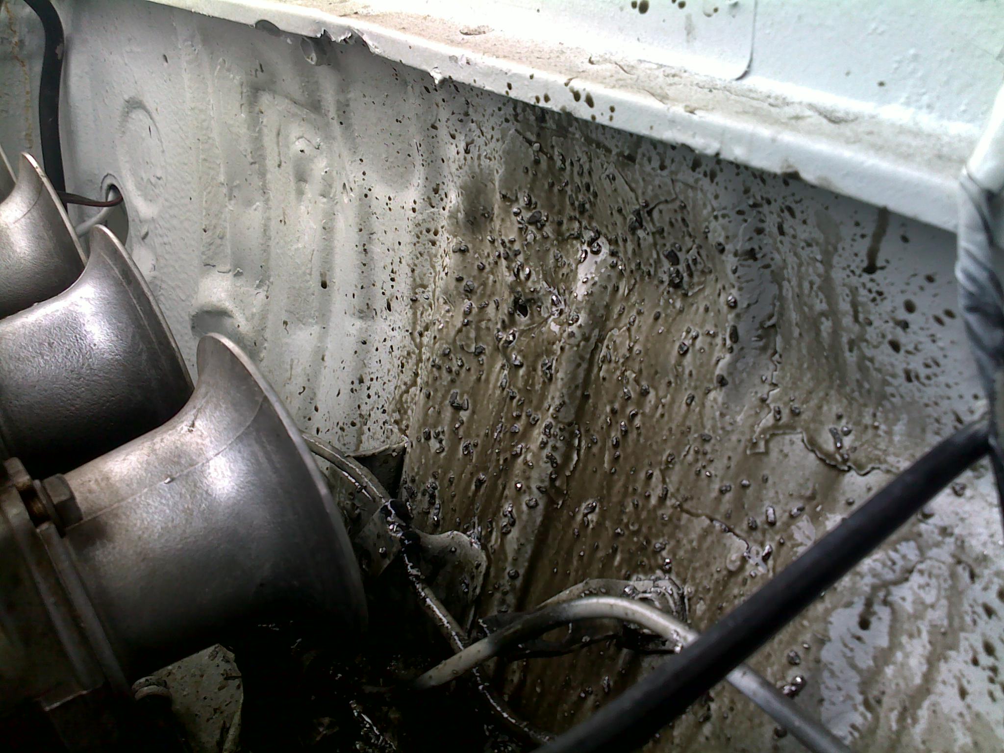

P.S : The oil and aluminum fragments came through the carburetor trumpet....odd thing.The engine block is intact and there is no obvious engine knock.

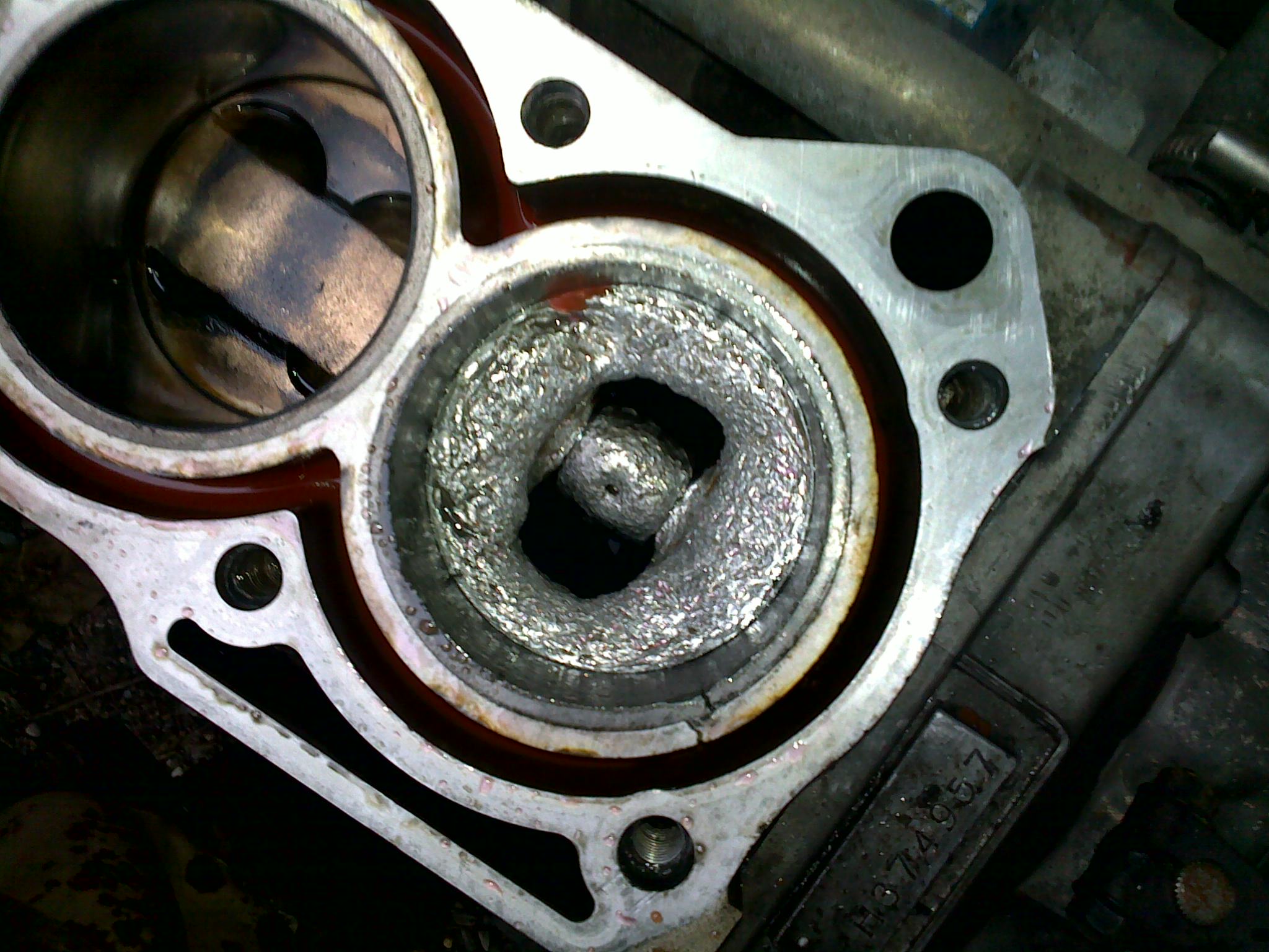

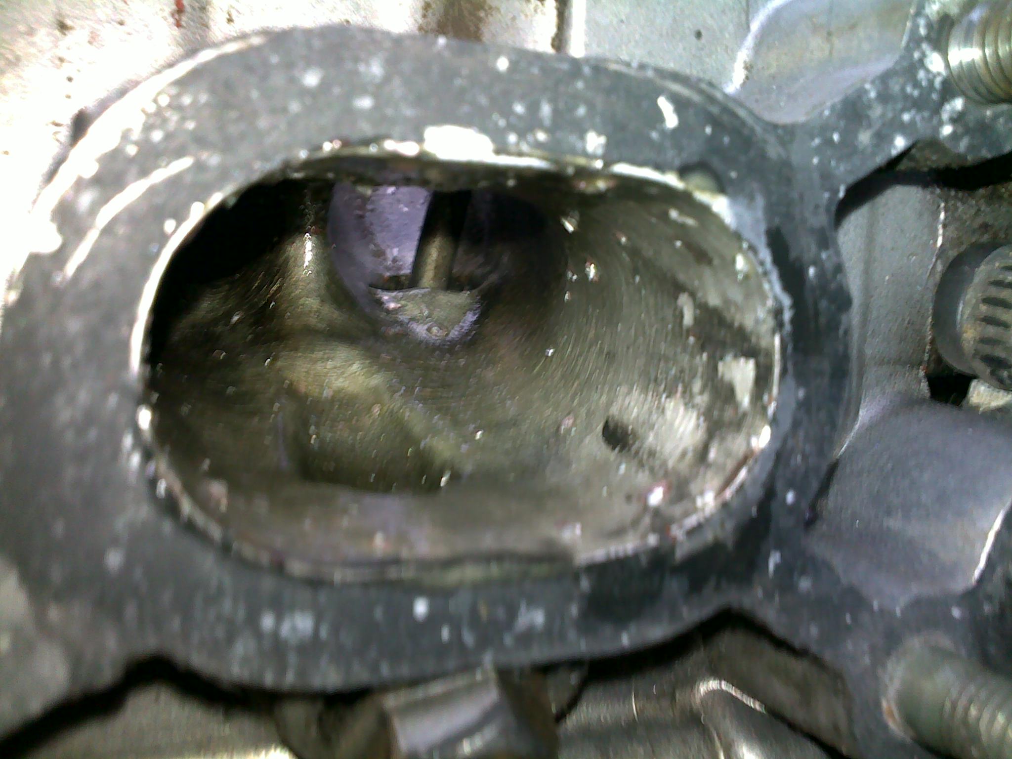

Unfortunately the engine gave it's best, nothing seems salvageable , I will have to check the crank for straightness and see if i can recover the arp rod bolts.
The only things that are ok are the cams possibly the lifters and springs ,3 pistons and rods , possibly the crank ,all bearings since the wasn't knocking water pump oil pump .
I think the cause of the failure was a valve that had a flaw or something .My next engine will probably have ss valves if they aren't too heavy.

What are your thought in terms of ss valves.
Do you think i should be running them?Can I run them with stock springs and lifters?
Could this have happed only because i over revved it?
Did you or have you heard any other guy running a g13b about breaking valves when hitting close to 9000 rpm ?
G13B 1.3L 16v 115hp
PostPosted: Sat Nov 24, 2012 7:02 pm
Do you have a rev limiter? cutting the spark on over rev would help somewhat.
I'm probably not the most qualified person to ask but I would say the over rev is what killed it, there other guys running well past 9000rpm but I think you need solid lifters at that rpm.

ding dong! that looks like the piston crown reached critical mass and the whole cylinder went up in a nuclear explosion.
gets my vote for the "carnage of the year" award. :twisted:
PostPosted: Sun Nov 25, 2012 2:38 am
Joined: Mon Mar 14, 2005 10:19 am
Posts: 361
Location: Canberra, Australlia
+1. It's a late entry but looks like our winner this year. Sorry for your loss :cry: . Hope next year you are ready with bigger and better from what you learnt in this years racing. Good luck!

Yes , valuable lesson learned .
No, i don't have a limiter , just a shiftlight.
So, are SS valves a must for high rpm or was this just an accident?

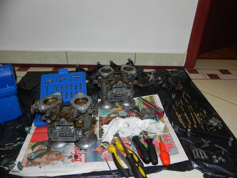

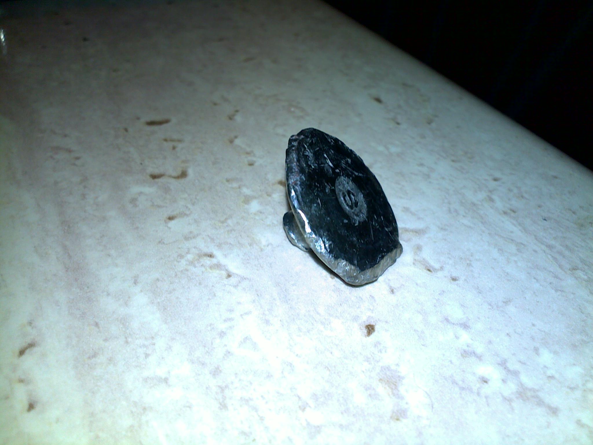

I got a consent form my wife...what would the holiday spirit be without car parts...
File comment: I found this little thing stuck between the chocke and butterfly

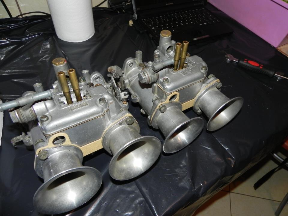

File comment: proper dhla rebuild after 2 years

Carbs are all cleaned and rebuilt. Ready for the next year of racing.
