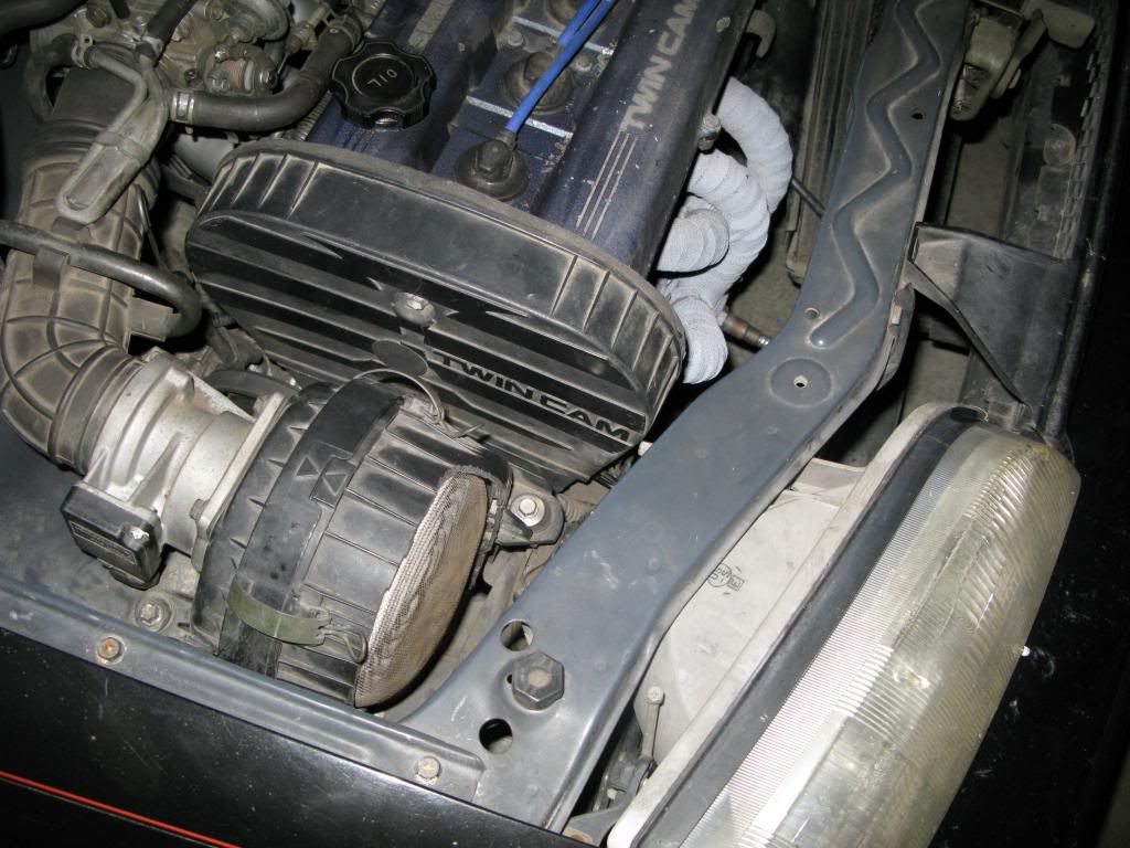

i put together this one for my 92 gt.
this is a little different one i built for my twincam vert.
i recommend frozen boost for air filters, thinwall aluminum bends, stainless steel t-clamps, and silicone hose components.

it's not all that hard to fabricate something better than the stock induction set. the stock intake tubes are old enough that they are pretty rotted out so almost anything else you come up with is an upgrade.

the red one is a hump hose, a section of a 90* bend, and a straight hose coupler.
the black one is made with sections of 2 45* bend hoses and a straight piece (a cut off piece of the end of the 90* bend i used on the red set up.)

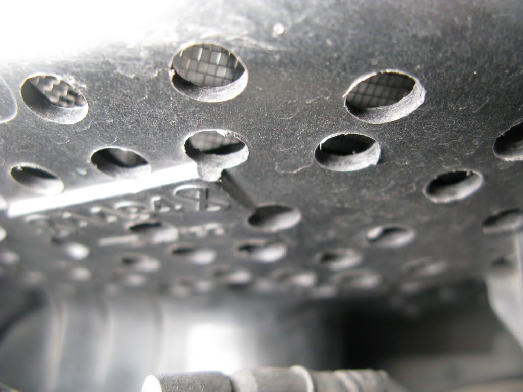

If you're really cheap, here's what I did:
I drilled a bunch of holes in the stock cover and put a screen from a kitchen strainer between the cover and the paper element to keep out large debris.

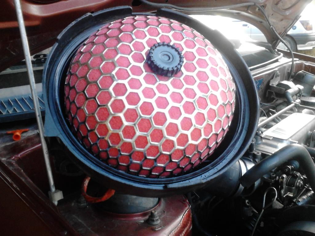

this is my set up, in the built stage
used the foam filter, removed the back and glued the foam and net into the stock part with high temp silicone, and then put in the other half of the stock filter housing, the car pulls great, and i can ear it sucking the air
