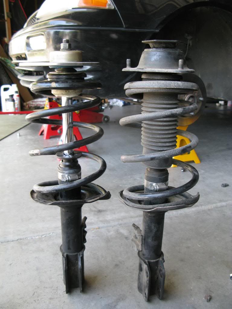

Stock height:
After cutting 1 1/4 coils front, 1 coil rear:
I may still remove the rubber isolator from the rear to get rid of a little more "stinkbug".
Coils were short enough in the front after cutting that had to make up and weld to the lower seat some tabs to keep the spring in place when topped out.
The sway bar link under the exhaust is hitting, so I'll have to cut / weld the hangers to raise the muffler / pipe some. Without looking under the car again, I'm wondering if it's low enough now to flip the sway bar under the control arms instead, but that's just a thought.

PostPosted: Tue Apr 23, 2013 8:07 am
I recommend photobucket.

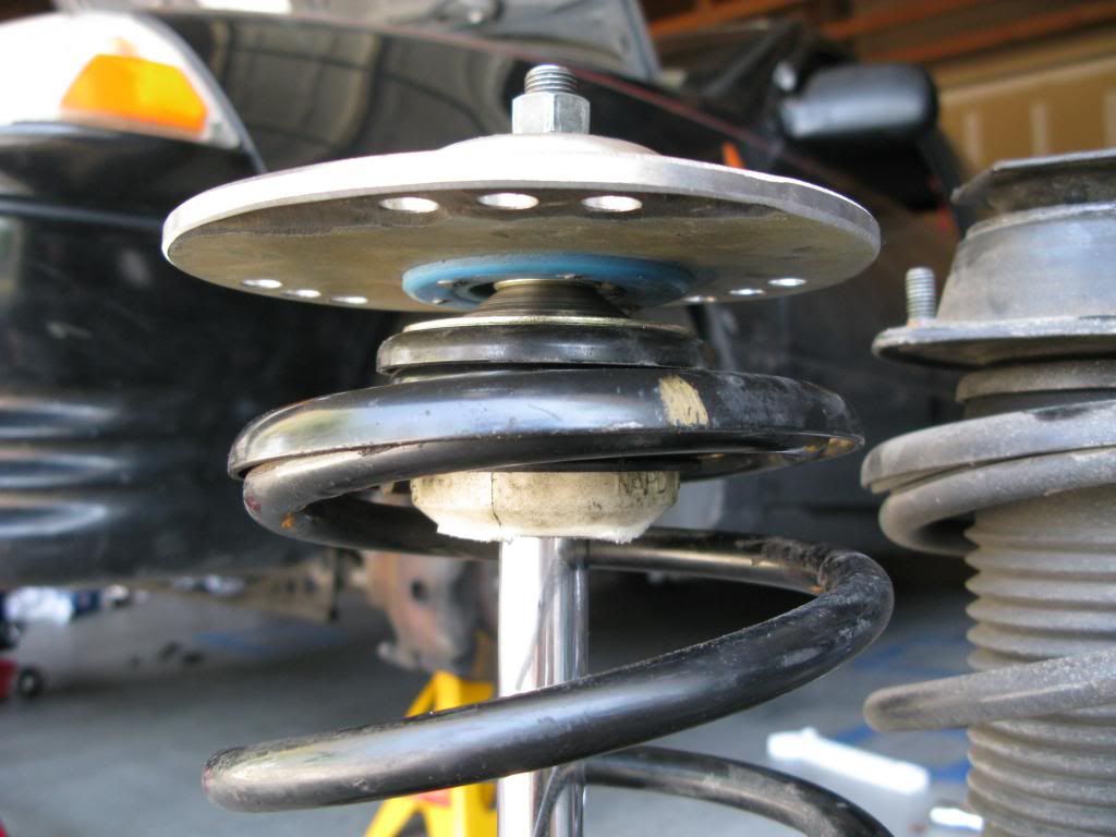

Strut mount set up on cut springs:
Still trying to decide to trim another .25" off the springs to put my ride height back to where it was before the strut mounts. It's not much, but I only dropped the car about 1" to begin with.
Are those upper mounts drilled off-centre for the strut rod to allow caster / camber changes? Very nice. Thanks for the photobucket recommendation.
PostPosted: Tue Apr 23, 2013 10:29 am
T3 Ragtop wasn't kidding. Trusting Teamswift to keep your photos is why so many of them are missing. Hopefully whomever administers the Teamswift servers doesn't lose all the text and the image hosting services don't lose our photos...
Yes, and thank you! We'll see how they work at the autocross this weekend...
