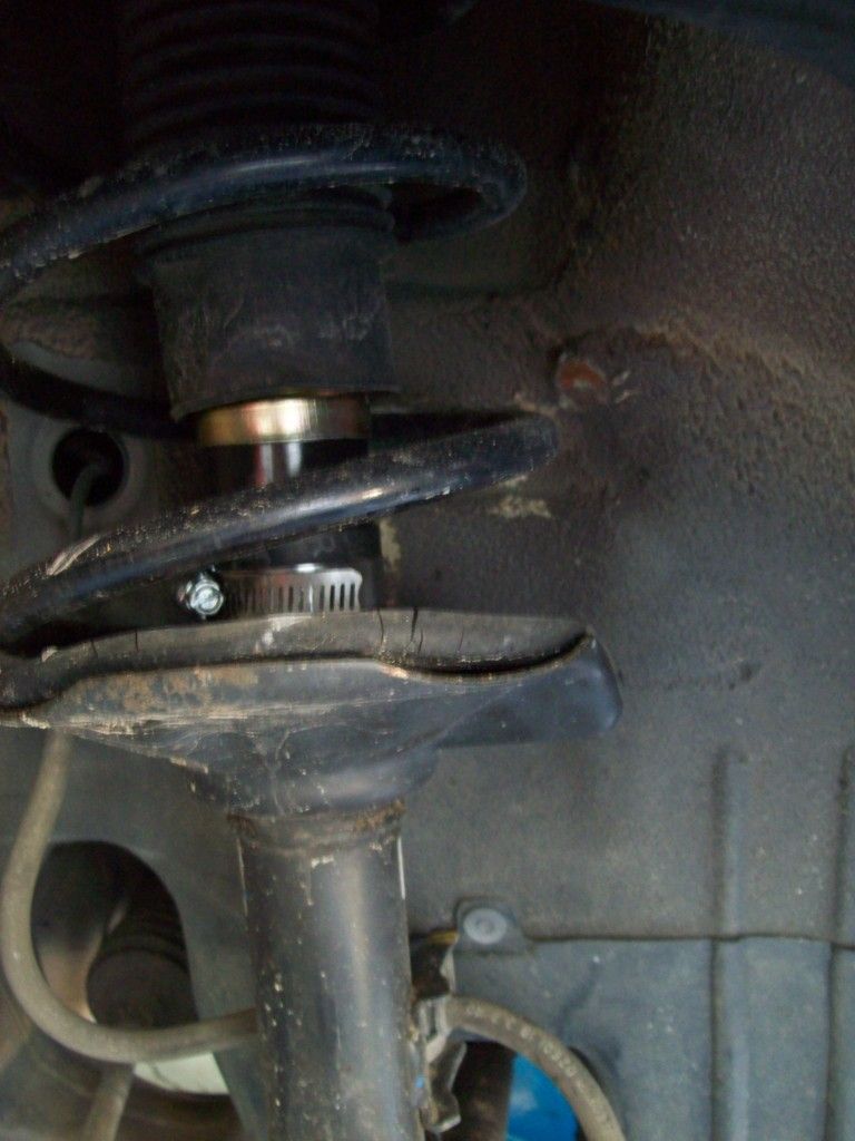

Success!
I chose to make my first attempt at Phonis out of Mk4 junkyard struts that clearly had issues. The first thing I did after installing the refilled struts was to take the car on a 3,000 mile road trip from Louisiana to Colorado and back.
The results? Better ride than stock--maybe still ever so slightly under-damped but much, much better than OEM struts with the cut springs. Maybe the valving on my OEM GT shocks (they are in good shape) would be even better?
This was all on the front only, I got new KYB's for the rear. The combination seems to be working quite well.
What I learned:
1. Use a small drill bit. Because I am not very smart I thought I would drill 1/4" holes and weld matching nuts and bolts to the outside to seal them for convenient refill, if necessary. I drilled forever before giving up and trying a smaller bit that would just clear the tip of my "flavor injector" syringe. 9/64" bit punched right through.
2. It takes lots of pumping to get all the old crap out of there--keep it up until the resistance is almost completely gone. I tried not to completely bottom out the shock, in case that was necessary.
3. It's hard to overfill. I lost count of how many syringe-fuls I had put in there on one side but I had enough trouble getting the right amount in the other one that I just tried to fill it as much as I could before the oil started running out and have had no problems. It's hard to describe, but I did have to gently move the piston up and down a little bit to get all the fork oil in.
4. The bit of inner tube and hose clamp method of sealing is also working so far for me.
Cheers
PostPosted: Mon Apr 23, 2012 5:34 pm
And a picture of my "phonis".
I thought I had taken a picture of where I drilled the hole, but it's pretty obvious given where the hose clamp is--which hasn't leaked and is still working just fine, incidentally.
I do think the one on the left side is getting a little softer than the right one already though--it's odd that it isn't so apparent when driving but I think I can tell a slight difference when I compress that corner of the car by pushing on it. Still working better than the OEM, mind you, but I was worried that that one wouldn't last long from the outset as it was in pretty bad shape to begin with. Below is a picture of scoring that was already visible on the shaft when I pulled it:
So, now the question is do I just replace it with a better junkyard Mk4 strut, or, now that I know how to do this and I am convinced it is going to work well for me, do I drill my GT struts, which are probably in slightly better condition than anything I would find in the yard. They don't look the same either, though, so I wonder if they have different valving that would behave differently with the same oil? Anybody else try both GT and Mk4 shocks?
Hmmm...
Anyway, this has now been working well for thousands of miles and I am definitely going to continue the experiments--even if they don't last many tens of thousands of miles, OEM struts are easily pulled from the local yards for next to nothing.
