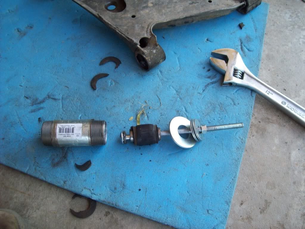

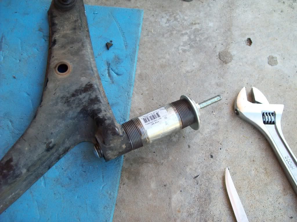

This this thread meanders around the topic quite a bit and has a lot of old links that are still good but don't match the current formatting. If you are smart enough to skip to the end, this link provided by Whattheee at the beginning (but now difficult to notice as being relevant) has the most critical information:
http://www.angelfire.com/de/ksj/suspension.html
If I had read this right away I would have scaled down my bushing replacement ambitions considerably and made smarter shopping decisions. As it stands I bought the entire SuperPro kit and so far I have replaced the back D bushing.the inner rear bushing and the swaybar bushings. The round inner bushing is especially difficult to remove in the back as Whathee alludes to. There is a thin metal sleeve that must be peeled up with a cold chisel and pounded out. That's in addition to getting the rubber bit out, which is more difficult than in the front--Wahttheee's method probably won't work. I had to torch mine before I could hammer them out.
The differences between the front and rear bushings are a bit odd--they look almost the same but in the rear the big D bushing just slides off, but in the front you have to wrestle it off or use a press. The rear inner bushing in the back has the extra metal sleeve and is a royal pain to remove, but the replacement slid in without too much fuss. Up front the round inner bushing comes out easily using a puller made from a carriage bolt and nut, a piece of pipe and some washers:
Unfortunately now getting the new one in is a problem. First I tried a vise to squeeze them in (that worked fine with the rear ones). Then I tried the hydraulic press. Then I tried the washers and pipe again, which didn't work either but got closer than the other methods:
I guess it just isn't made to the right tolerances because it does not want to go in there. At this point it looks like I will have to give up and get another lower arm from the junkyard and just replace the D bushing with the offset one and leave the inner one alone--anybody else have trouble with this? Have a ninja bushing-stuffing secret? I tried really hard to find and peel up a metal sleeve in the front but it really doesn't look like there is one. Am I missing it somehow? It sure isn't easy to pry up if it's there somehow and I'm just not seeing it or able to catch the edge with the chisel.
Very, very frustrating.

PostPosted: Fri Apr 20, 2012 11:58 pm
cut the bushing in half and install each half from either end. :idea:
PostPosted: Sat Apr 21, 2012 7:12 am
BRILLIANT 8)
Thanks for the brainpower--don't know why that didn't occur to me to begin with as some of the bushings come like that already anyway. Now the question of the morning is utility knife vs. hacksaw. The knife would be the obvious choice except it will be hard to get that deep and keep it straight (though that probably doesn't matter as long as the pieces fit together).
I was actually about to try chamfering the edges of the hole, but cutting the bushings in half is a much better idea. I would still love to know if this is something everybody has to do with these or if I just got a weird set.
Thanks T3!

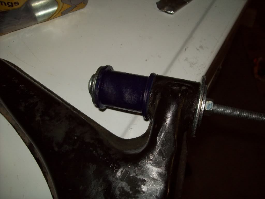

It's difficult, but it's possible to mount them in one piece! I mounted them with a piece of thread like you did, but guided the bushing in a tube so it couldn't collapse like in the pictures. A bit of vaseline took care of the rest. Good luck!
PostPosted: Mon Apr 23, 2012 5:04 pm
I also tried stuffing the bushing in the slightly larger diameter pipe I had used to pull it out first, but had trouble getting my threaded apparatus to grip enough to pull it in. I ended up cutting them in half after all, figuring that if I ever want to replace my control arm they'll be a hell of a lot easier to swap. Chef's knife from the kitchen turned out to be the best implement.

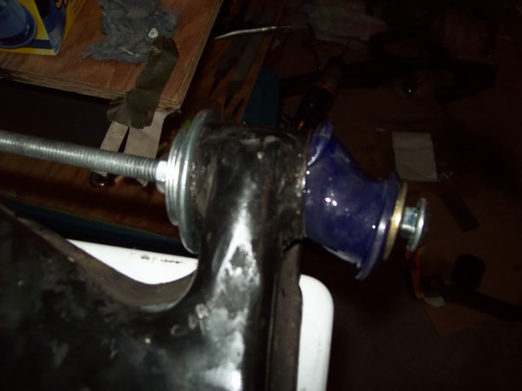

I still needed the carriage bolt to push the crush tube in and make sure both halves were seated properly.
Here's everything almost back together. Since I got the Superpro caster bushings for $20 on sale from 185 performance, I did not get the shims that come with the Whiteline kit. I added an extra washer in an attempt to get just a little more caster--I haven't seen any pictures of anybody else's bushings in place, so I hope I did this correctly.
Here's everything completely back together :D Notice that I had to swap the lock washer with a thinner one to make everything fit and that the bolt is now just flush with the retaining nut, so that's as much caster as I can get with shims and bushings I guess.
The effects are fairly subtle in ordinary driving, but the car does seem a bit better planted--I expected steering effort at low speed to increase dramatically, but not so much after all. I had already gotten the front of the car much more grip by removing the front swaybar entirely, but, for what it's worth, I can now take the average freeway ramp around here at better than 50 on my cheap DD tires, so grip is good, and where I was a little too loose before I think the stiffer bushings helped to tighten things up again in spite of any further increased grip at the front. I am now just about perfectly neutral with the ability to get oversteer with trail braking if I want it--follow the Spanish Inquisition Racing thread in track talk if interested in the rest of the set up.
