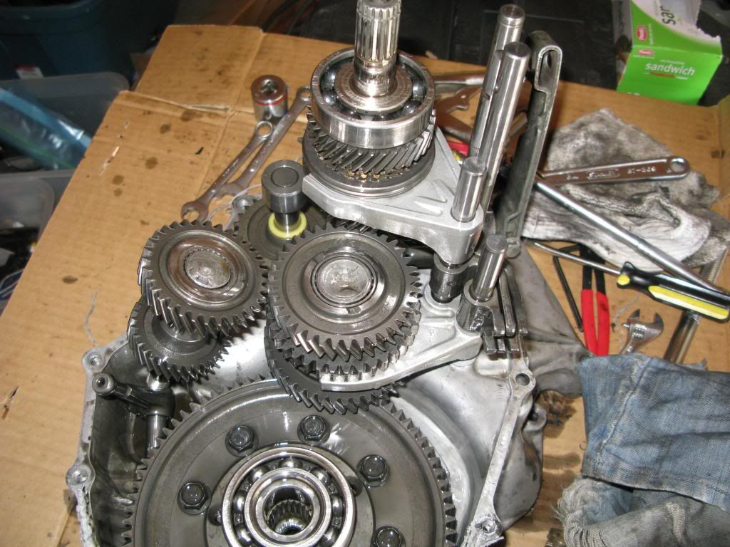

I have an 89 GTi transmission and a 93 metro transmission in swap sone stuff around on.
A spring fell from somewhere when u was removing the gear set. I have the 3 springs from the top of the trans. I'm not sure where it goes.
And a washer I have no clue where that goes.
Help please!

I think I figured out where the washer goes
But the spring I'm still not sure. I'm looking through the service manual and can't find anything. It's shorter than the gear locating springs.

Because I am a nice guy, and because I also feel no guilt about potentially misleading the ignorant with unverified falsehoods which they should know better than to take as fact without diligent research, in my highly questionable recollection those parts are: one of the springs that holds in the detent balls for the shift levers (under the three bolts/screws on the top of the trans--probably not the middle one) and the shim that provides the correct preload on the input shaft bearing where it meets the retainer plate, respectively.
As far as that shim goes, if you can get the shaft seated on the bearings at exactly the same depth as it was before then presumably you can use the same shim, however, I have yet to be able to get this quite right and the FSM specifies that you will need to get the correct shim to match whatever you measure when you reassemble. While the shims can still be purchased from either Suzuki or GM, you are then stuck at that point of reassembly until you order the right one unless you keep a full set in stock.

It was not one of the shift detent springs. I set those aside separately due to them being different sizes and that stuck out to me so I set those somewhere safe. The missing spring was the shifter input detent spring.
