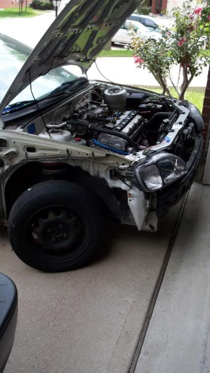

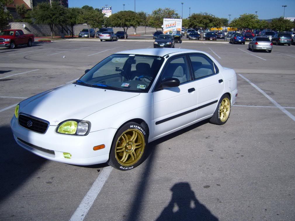

Hey, I was looking for pictures on google about the J18 crank and came across you guys. You might have seen my vids on youtube. :wink: Anyways, I was wondering if you still have or have specs on the J18 crank. I want to do a build up to maybe a 1.9L using J20 parts. but Want/need specs on the J18 internals before I decide to go and buy a J20 for parts. I am/was a mod on Clubaleno. The owner recently pulled the site down. I am trying to buy it back to get it online again. I still have not heard back from him. Wish me luck. :mrgreen: Heres my car as it is atm.
What it should look like when I am done.
and my other leno 8)
>>>CLUBALENO<<<click me
Image2000 Suzuki Baleno (DD)Image2001 Suzuki Baleno (Overhauling)
PostPosted: Mon Nov 24, 2008 10:43 am
Joined: Sun Nov 23, 2008 11:06 pm
Posts: 49
Location: 日本, 埼玉県(Saitama, Japan)
BTW, the white one is going to have the engine taken out is why I am inquiring about this. I may have to just rebuild it if I cant get the money in time to do what want to do with the J20 Dont want the whole J20 engine swapped in, I just want to build it up to a higher comp from the 9.8 to 10.5 if I can do it with OE parts. This car needs to be ready to go to Japan after May. Will need to ship it AFTER I get a Japanese license, that will take a while. :?
