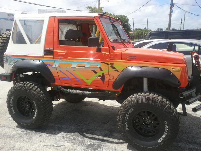

I have a G16KV installed in my Samurai and am wondering since I am pulling it to rebuild it, is there anything I can economically do to help in the horsepower area? I know it would be a stretch but, can a DOHC head be adapted to my block? Otherwise, is there anything I should or could to to get all I can out of my motor to turn my 33" tires. I have owned the motor for about 5 years and have to stick with it since that is the harness I have installed and cannot afford to start over from scratch. Wish I had found out about the swift engine sooner. Any suggestions are more than welcome and appreciated. At this point it only has a SS 4 into 1 header and 1/14 inche exhaust that I had when the 1.3 was in it. Unfortunately I had just put a hotter cam in before I did the engine swap. Dollars down the drain as I figure that cam cannot be used in the current motor. My motor is out of a 97 Suzuki X-90. Thanx for any help you can provide. Getting ready to order the rebuild parts so need to start accumulating the info soon.
