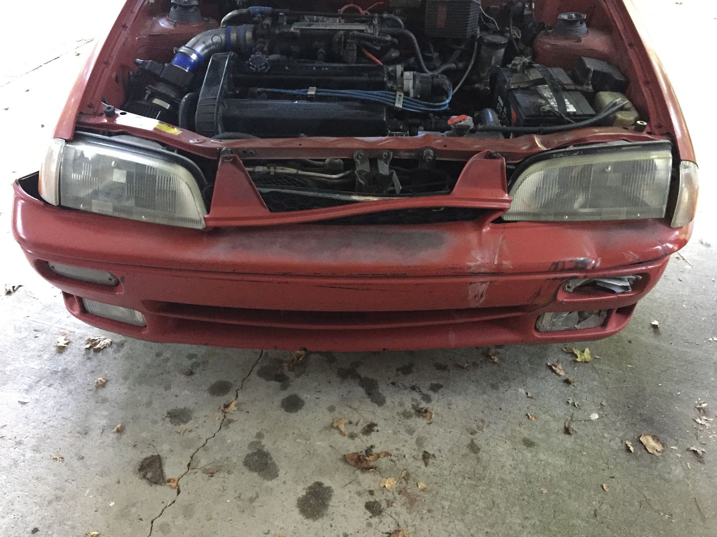

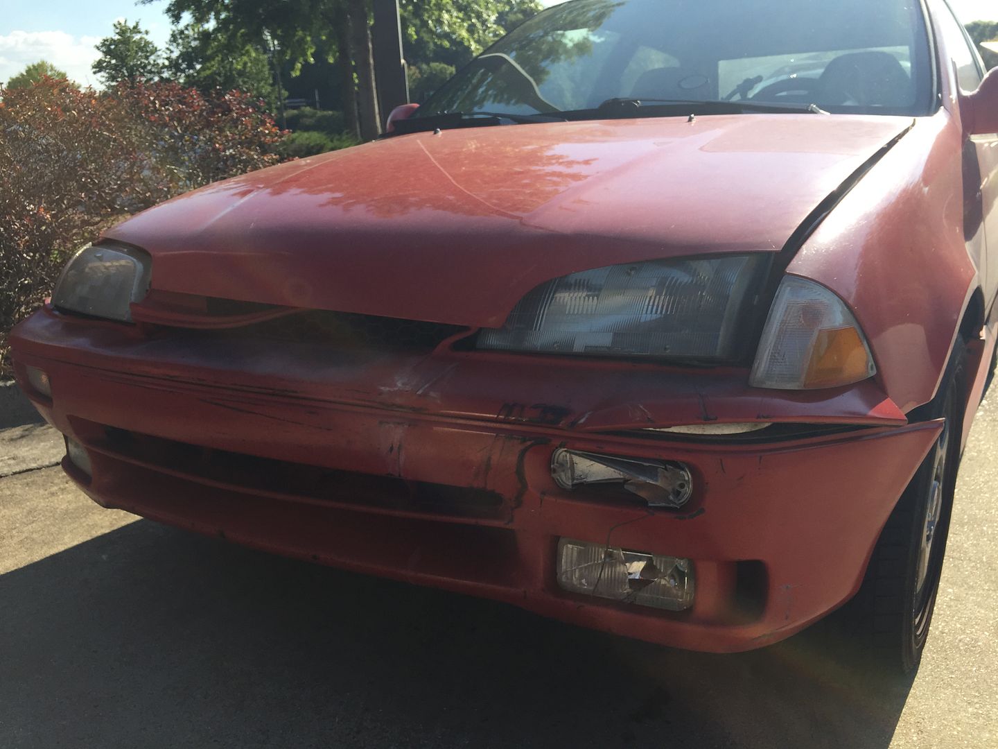

Ok, so a few months ago a jerk pulled out in front of me and I wrecked my 89 GTI, the front end was pushed in and everything got all scrunched up. I have been driving it, but there are some problems like the headlights not working because they were crushed and stuff like that that prevents me from using it all the time as a reliable car. I have been accumulating the parts needed to get it back to normal, but I have noticed that one of the front crush zone on the drivers side well got crushed. It maybe fixable, but I think the motor really needs to come out to make more room for a proper repair if one is even feasible.

That's one of the main reasons why I want to get the engine out of the way is so I can have a proper look around and make sure nothing else is damaged to badly. Hate to see a GTi destroyed, it drives pretty good I have some wheel shake I believe that is from flat spots on my tires where I was standing on my brakes. Also the front lights are damaged so I can't drive it at night and I can't fix them because there isn't room to put replacements in properly. The upper and lower core radiator support are bent as well. Everything else looks ok, it was a dead on hit although the drivers side got it slightly worse.

I already posted these on GMF awhile ago, but I am going to toss them up here as well for everyone to gawk at, I've already gotten a few messages about repairing my GTi since posting so I figured I would just satisfy everyone's curiosity.
