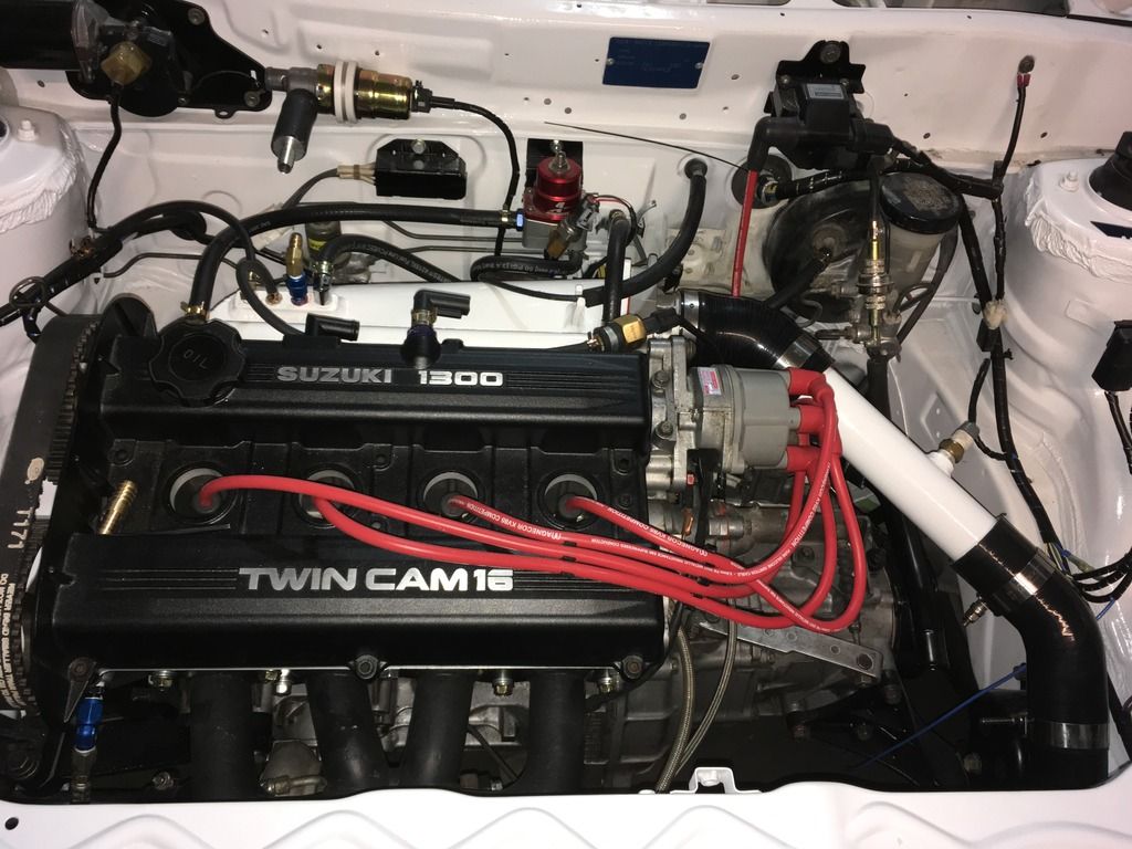

Not yet.. getting very close. Still a few wiring bits that need buttoned up. Here a few pics including the grinding on the girdle I was talking about.
Im going do a full write up on the setup once it's back on the road.

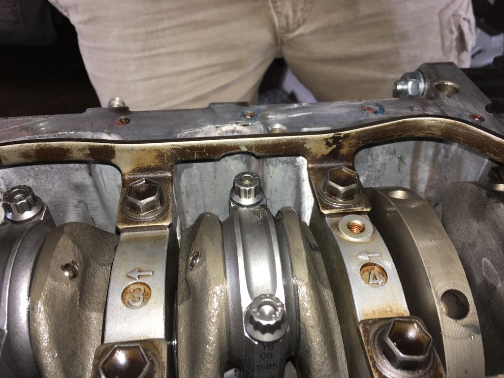

I'm only NA so these rods are massive overkill in my engine.
They are not heavier than a stock rod. Stock rod....423 grams. Stock rod with arp bolts....437 grams. Maxpeeding rod 417 grams.
Why did I put them in? I'm just daft that's all. Bought them before asking anyone.
To be honest I balanced my engine and to do the gti rods plus replace the little end bush and hone...check roundness etc was going to be half the cost of these rods...so I had em...I put em in.
The longer heads on the bolts definitely hit the girdle. I have a friend that just got rid of the girdle and used proper washers. Said he could not see the actual use of the girdle....he is turbo....engine runs well. I didn't have washers handy so I filed the girdle down in four places to give clearance.
My bore is now 75mm. I can tell you the rods go close to the bottom of the cylinders....hard to measure but they do not hit. I had the shells measured in the rods....I can tell you they are round....the little end bushes are perfectly sized....the arp 2000 bolts are nice....the caps lock in tightly on the dowels and the rods balanced to within .5 gram from the factory.
The holes....my understanding is.....not needed....a lot of newer cars are coming out without those holes. Yes....it may help to cool the piston crown.....but I emailed maxpeeding and they do not believe the holes are necessary....others have run them without the holes and found no ill effects. So boom....in they went without the holes and...good pressure for those big end bearings as well!
If we miss a change and rev #$&@ out of the engine at least these bridge girders won't let go.
I like them....Chinese made...yes....but most of what we have around home is too....it's all down to quality control and they seem to take that seriously. Hope any of that helps
File comment: Nice rods.
File comment: Girdle....file out a bit.
File comment: Head just back
File comment: Honda Pistons. Three tech.
