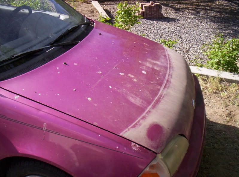

This is now:
This is the dust that's been under the bra all these years until we peeled it off. (Copper Top is in the background. )
Now I wish I had left the top up!

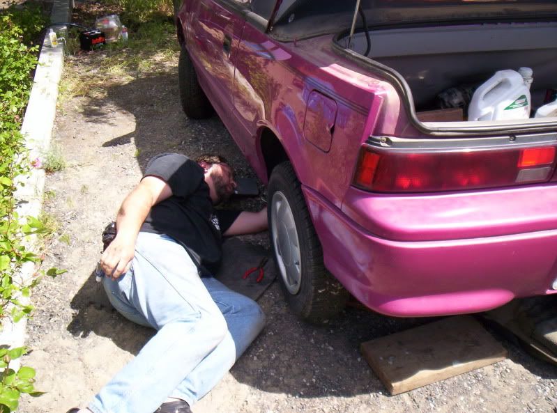

[G-Wiz starts on removing the fuel filter and relocating it to the engine compartment (where it should've been already)]

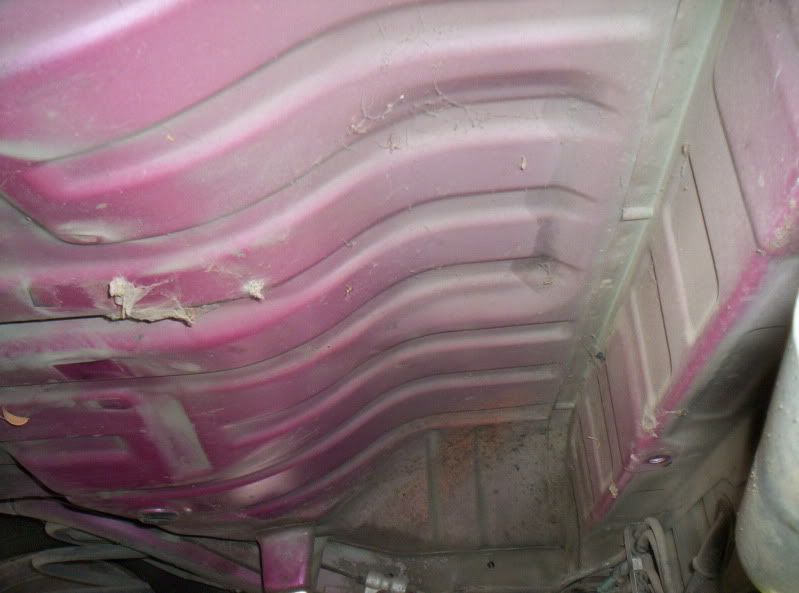

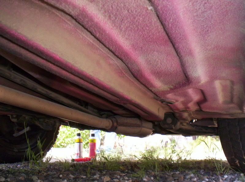

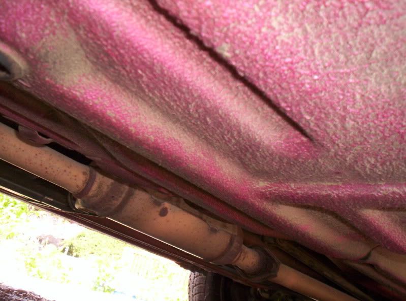

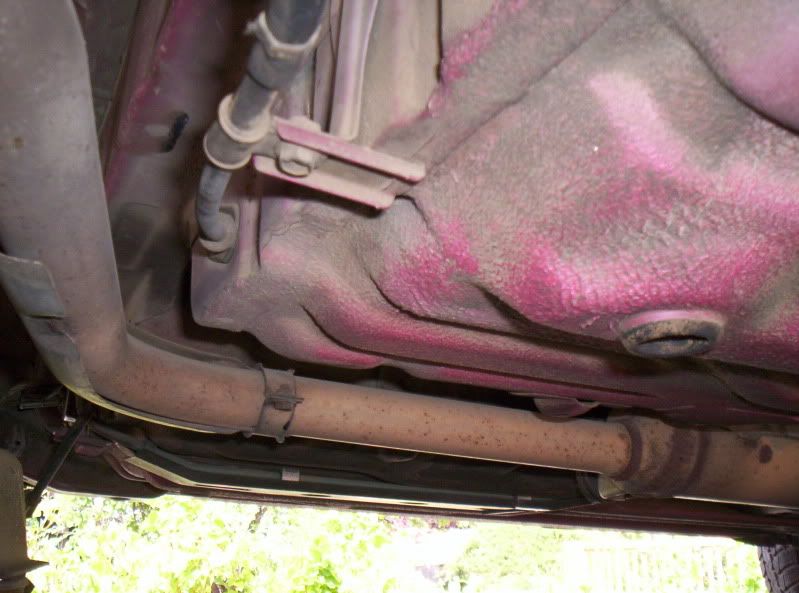

I've never seen such a clean underbody!

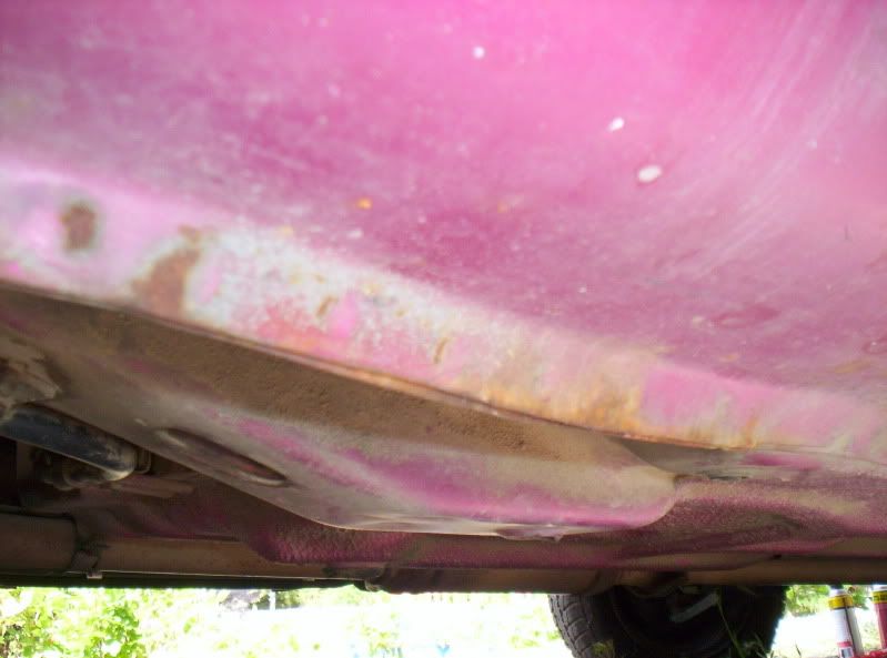

[The only rust on the car besides around the trunk lid keyhole. It's on both sides.]

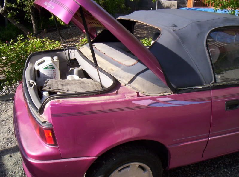

[You can see the dust built up under the trunk lid where the top is under it. Thick and nasty.]
[I spit cleaned a spot where the dust was under the diintergrated old bra. The paint should buff out if we're lucky.]

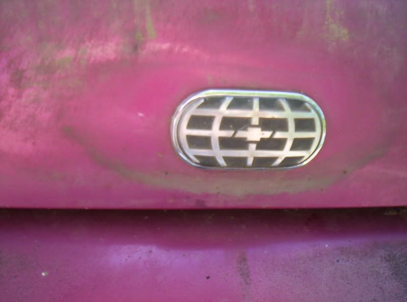

[Pleasent surprise! The hood badge is almost immaculate because of the bra.]

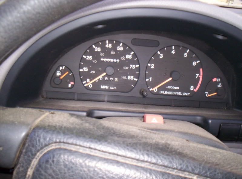

[Sweet, it has a tach!]

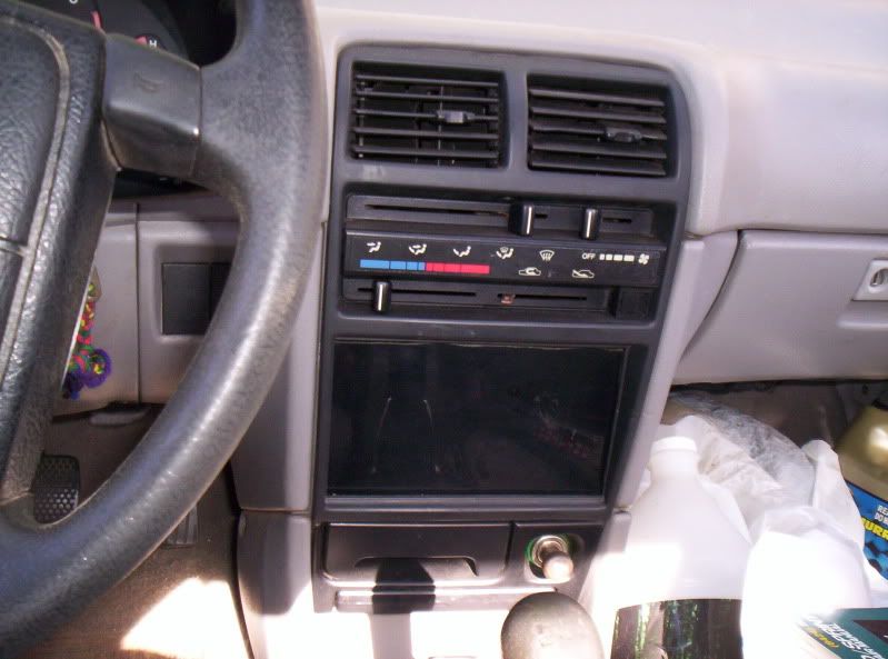

[Big blank spot where the CD player will go later.]

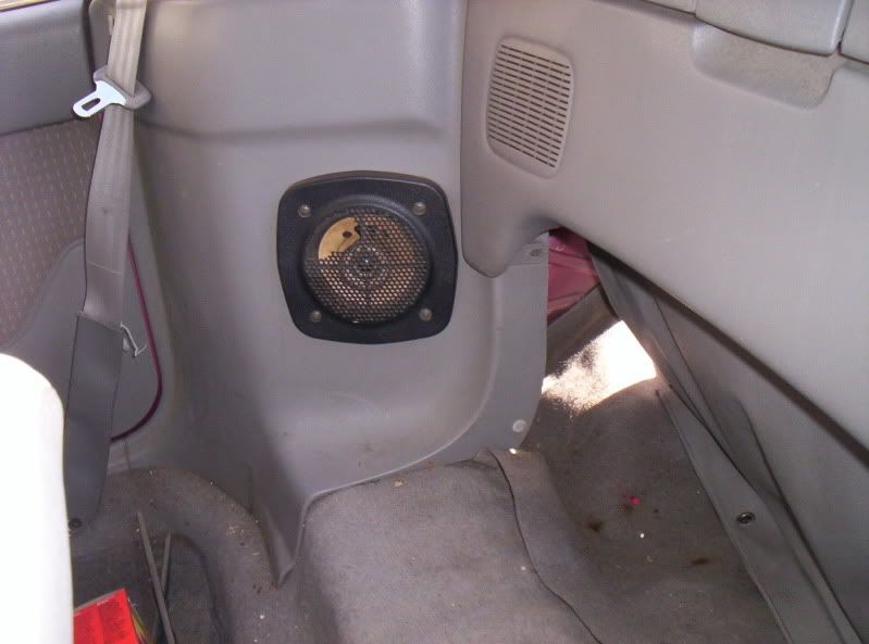

[Poorly installed cheap aftermarket speakers. These have to go!]

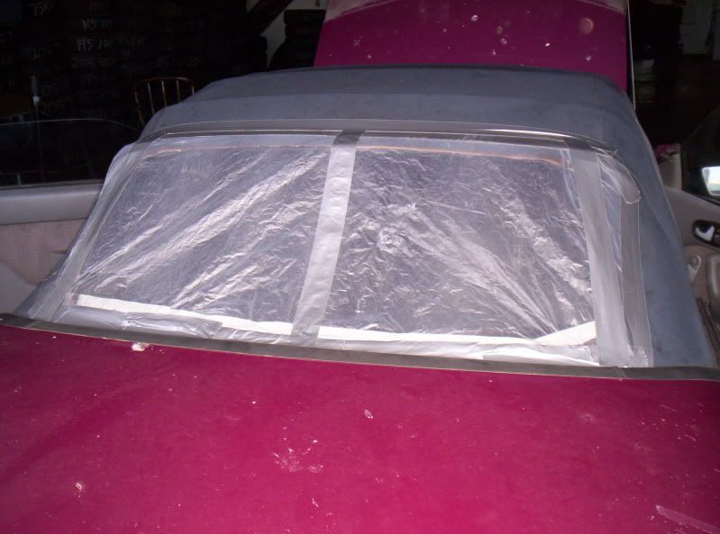

After 7 years of sitting, one or more tires were bouncing and vibrating the car like crazy. Once we hit the road, it took a good 60 miles for them to settle down to just an annoying level of vibration.
Right after we struck out for home, I absolutely had to stop get this looked at! The one of them balanced just fine, but still, started to vibrate when spun up to speed. I had the tires rotated before we struck out, but it only helped marginally.
Whatever sensor/engine problem that originally sidelined the car back then was still there. It cuts out and back in and seems to be coupled with the trouble code 2-3 (manifold air pressure sensor probably unplugged while the motor was running).
