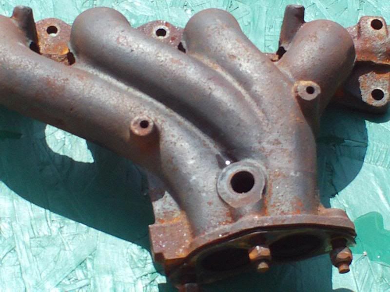

PostPosted: Sat Jul 03, 2010 5:37 pm
Only thing sticking out in front of the engine with a wire on it:
Should go in that hole, eh?

Thanks for the picture. I know for a fact nothing was sticking out from around that area, so tomorrow I'll take a look and see if a hole exists there.

PostPosted: Sun Jul 04, 2010 11:51 am
If there is no wire going there, then you have the reason why your car is getting bad mileage. Without the O2 sensor present, the computer will never go into closed circuit mode, and will run the car very rich.
This is bad because all that extra gas will contaminate your oil, and wash the cylinder walls down, so the piston rings literally are grinding on the walls, and this leads to bad compression in a hurry.

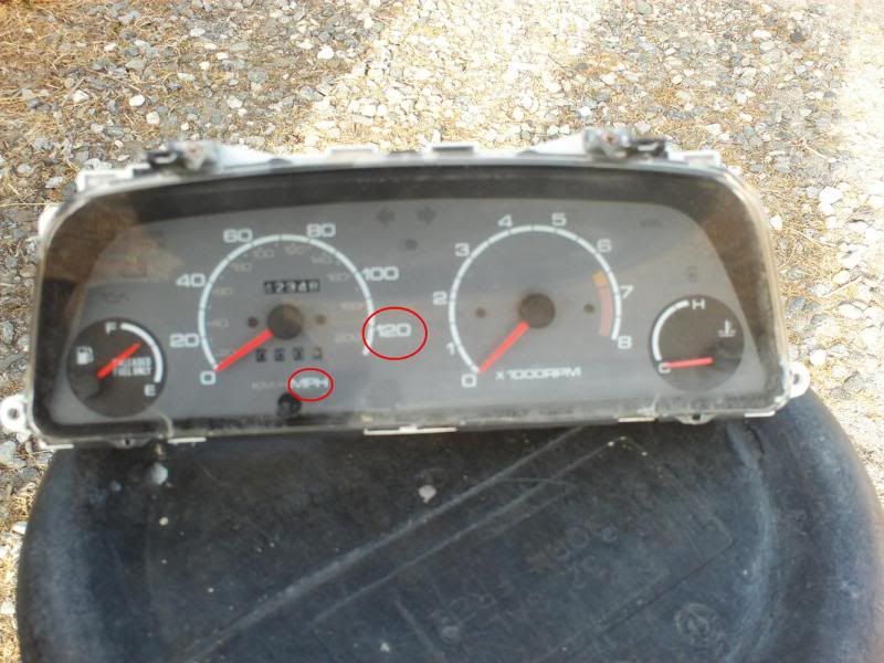

This is your lucky day; I happened to take a few pictures of just the things you're talking about and upload them this morning. So grab a pencil and paper, make a few notes, and here we go:
First, here's a late model MK1 instrument cluster for identification purposes.
Note the tach, which means it's not from an ER or automatic transmission type car:

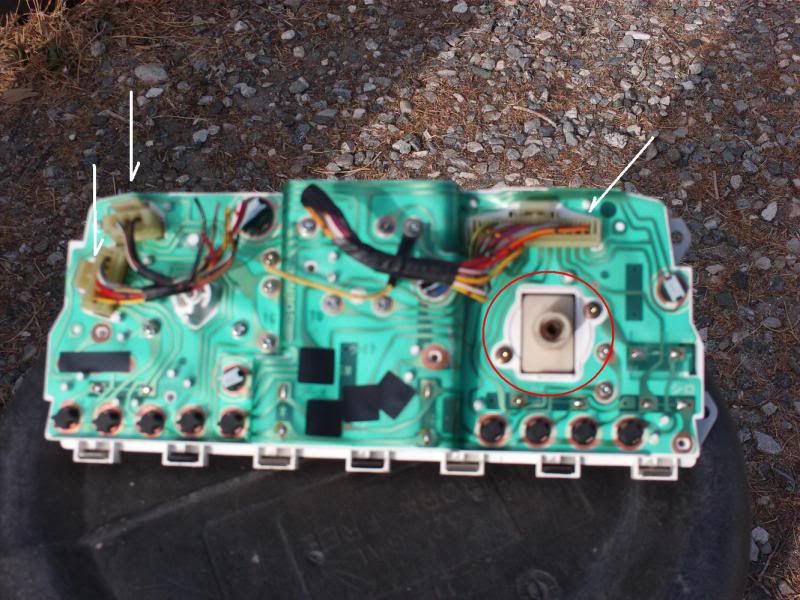

Now take a look at the back.
Circled in red is a rectangular white plastic piece held in with two phillips screws. It is the VSS (vehicle speed sensor). Also, I've pointed out with white arrows the 'other half' of the cluster to get when you buy one. These white plugs with a length of wire help if you plan on splicing into a wiring harness (e.g. for a DOHC or turbo engine transplant).

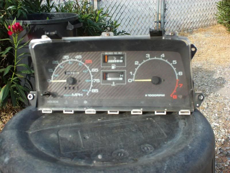

Now, let's look at the MK2 speedometer.
This one is particularly interesting.
It's in MPH, so it's not a Canadian version, and
:WTF:
it's probably pretty rare, as it goes past 85 mph to....120 mph:

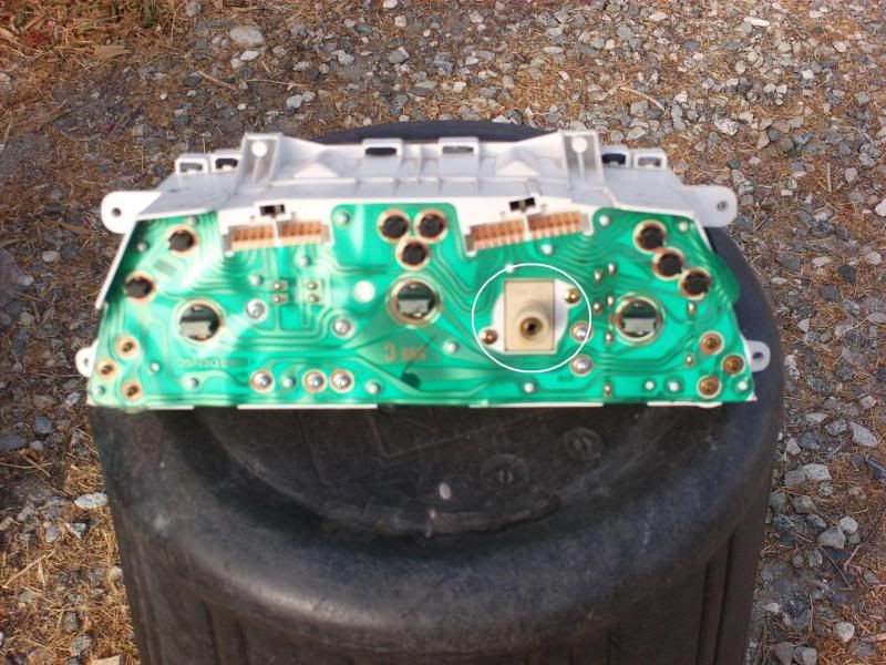

Let's take a look at the back.
It would appear that Suzuki did not reinvent their earlier model ('85-'88) VSS.
Indeed, it's the same part, looking at it from the back, circled in white:
If you have a problem with the later model ('89-'94) speedometer cable, the transmission oil can creep up the cable and interfere with the VSS, causing a 'code' to blink while you're driving. The fix is covered elsewhere on this site. Additionally, drivers complain that oil is soaking their carpets, shoes, and under the dash.

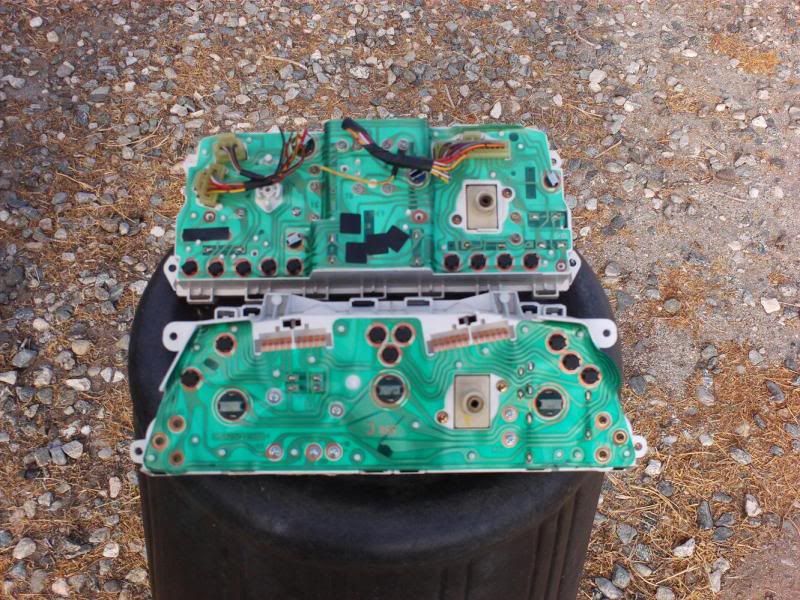

Now, one last time, take a look at the two instrument 'clusters' from the back.
Note the boxy, square early version on the top (MK1) and the lower and wider profile of the MK2.
Yet they both have the same vehicle speed sensor!
In conclusion, there are VSS in all the Suzuki products with ECMs (North America MK1/2/3). The automatic transmission cars may have them in a different place, but still they're there. Notable exceptions may include early MK1s with Aisin carbs, but I don't have a cluster from one to compare. Perhaps someone in Canada or Northern Europe has a spare and can post some pictures for you to see.

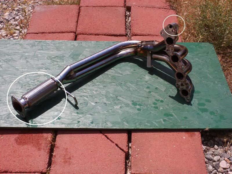

My VSS post was just a little information, especially for swift 13b, so don't take offense.
The picture of the exhaust manifold with the hole for the oxygen sensor is a stock set up and readily available on line for $75 or so.
If you have a custom built exhaust manifold (what most people call a 'header') your O2 sensor may be in a different location.
Here's a chrome header with an O2 sensor hole barely visible on the side where the #4 cylinder exhaust runner has its second bend, about a third of the way between the two white circles:
That's why we can help more if we see what you've got.

Location: New York
Very interesting. That probably explains why the fan is ALWAYS on from the moment I turn the key to the first ignition. I will get the thermostat fan sensor then :). One thing though, wouldn't the thermostat fan sensor be connected to another thing from the other end?
'87 Chevrolet Sprint Turbo
'89 Suzuki Swift GTi 16v 1.3L DOHC - Sold
 Post subject: Re: POOR fuel economy?
PostPosted: Wed Jul 07, 2010 11:43 am
Joined: Wed Oct 14, 2009 9:27 pm
Posts: 321
Location: MO, USA
The sensor is wired direct to the fan, it tells it when to come on.
Warning, looks like you have a plug in that hole, otherwise antifreeze would be dripping out. Remove the plug, retap those threads before you put a new one in, and make sure its wired direct to the fan and that the 'always on' fan wiring is corrected.
89 GTi Zippy (sold)
Search Teamswift via Google
PostPosted: Wed Jul 07, 2010 12:23 pm
No, it looks like the sensor, just the idiot who owned the car before took a hammer and smashed off the connector, cheap and very stupid.
Check the wiring to the fan, it sounds like the numbnuts just wired it straight to the battery.
