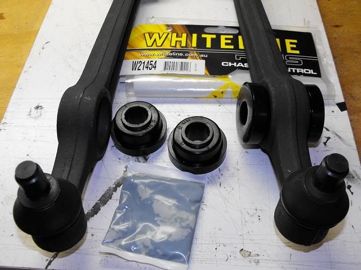

PostPosted: Tue Dec 27, 2016 10:35 am
Good luck finding OE bushings.
The normally aspirated ones do not work, MK1 Turbo has a larger diameter swaybar.
You can cast your own, a little pricey after all is said and done just for 1 set,
and you need a good donor set. Gotta buy the mold kit and urethane.
Whiteline is pretty much your only option, however they aren't quite rounded
like OE, but they will work.
PostPosted: Tue Dec 27, 2016 1:52 pm
Joined: Mon Jul 09, 2012 11:32 am
Posts: 150
Location: Pennsylvania
Any way to machine the bushings? (I'm thinking if the plastic hard enough to machine, it's too hard.)
PostPosted: Wed Dec 28, 2016 10:31 am
Look at the fit, what are you going to machine?
You would have to take a larger bushing and machine it down to size.
mxmikie has claimed to have done this on a lathe, he has/had a whole barrell
full of donor bushings.
PostPosted: Wed Dec 28, 2016 12:13 pm
Posts: 150
Some Russian guy on youtube made some bushings for his Citreon (!) Trick to turning was to press the bushing on a mandrel - this preserved it's roundness and gave it support. Clamping in a chuck maybe for drilling the hole - he didn't get in to that operation, but I'm guessing it was straightforward. To soften the bushing like he OEM, drilled small holes spaced along a centrally located diameter.
