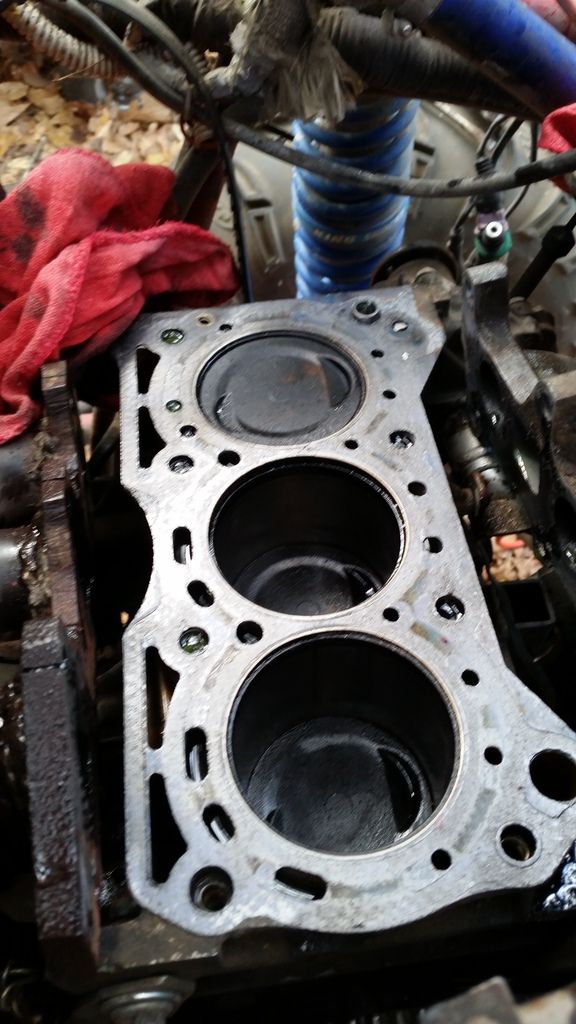

I have not installed the injectors yet ,,, I convinced myself my issue was head related. The popping or blurb I was getting out the exhaust reminded me of when I had a bad valve.
So I started pulling spark plug wires.
When I pulled cyl 3 wire it ran
When I pulled wire 2 it continued to run
When I pulled wire 1 it died telling me cyl 1 was carrying the others.

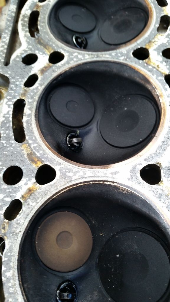

So I pulled my new plugs that have only been run on the trailer.
Plug 1 was black and was a shinny black like wet but not oil fouled.
Plug 2 was exactly the same as plug 1
Plug 3 was a dry black almost a fluffy snow looking with a few white spots showing through.
So now I've convinced myself my issue is cylinder 3 and possibly 2 also.
Time for compression test. Compression on cylinder 1 was 125 warm not hot. Of course my compression tester failed to hold the pressure after testing cylinder 1.
Not one to let proper procedure stop me I yanked off the head.
All valves were black except the number 1 cylinder exhaust which was tan/brown.
I flipped the head and they all held gas ( update,,,, the number one exhaust valve ended up leaking. It's the brown / tan one in the pic ) but once I added gas I could see sparkles mixed in with the carbon soot. I found this in all three combustion chambers. They were not attracted to a strong magnet.
I'll disassemble the head tomorrow and inspect the valves and seats but so far they look good.
Pistons have no pre ignitin damage and cylinder walls look good,you can still see my hone marks but the sparkles are coming from somewhere. Bearings possibly so at this point I'm so far in I might as well pull the block.
I did notice when looking at my block on the intake side there are two large water passages by the corners. The passage located on the front of the engine near the water pump is mostly blocked by my head gasket with just a sliver open.
I've tried to load up some pics but for what ever reason my new phone won't load them up to my photo bucket account.
I've been down this road before so I should be good but I welcome any comments or input.

The brown valve eventually failed the gas test for leaking.
"She wasn't much of a wrestler,,, but u should of seen her BOX"
PostPosted: Thu Nov 24, 2016 2:17 pm
Joined: Fri Dec 05, 2014 5:39 pm
Posts: 426
Location: United States
The wet look is from the gas I used to check for leaking valves.

PostPosted: Thu Nov 24, 2016 4:46 pm
FloridaEdd wrote:
The blocked water passage is in the upper right corner.
No not water passage.!
that a hole stick a screw driver in it you'll see it outside it's a casting hole
