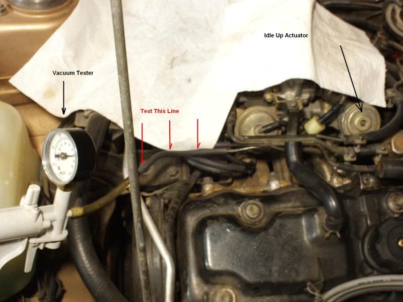

This is an easy way to find out if the fuel pump is not working, or the fuel filters are clogged, or you are simply out of gas. And it is the FIRST thing you should check. If you can't answer this question, you need to stop and ask yourself if you are serious about fixing the car.

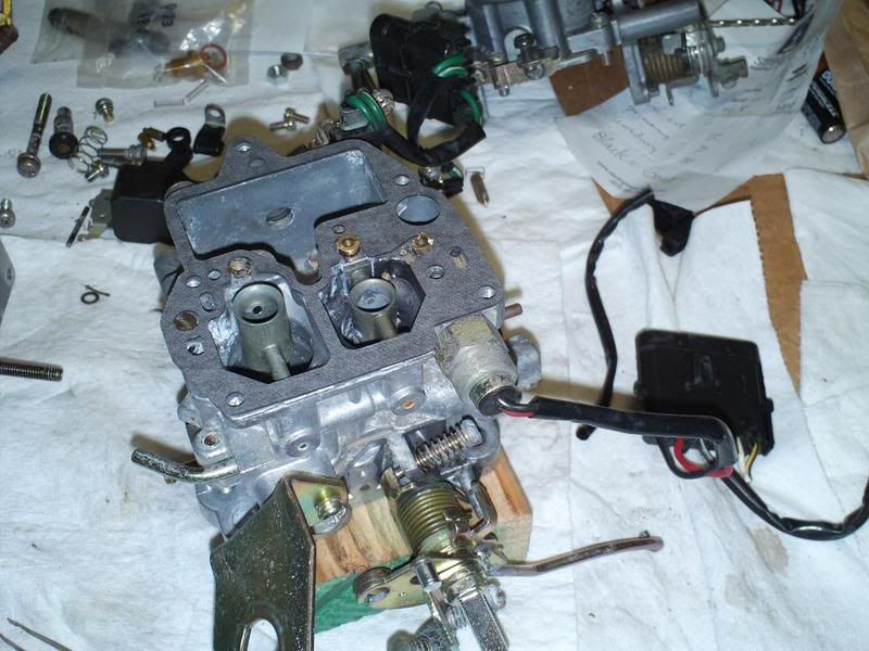

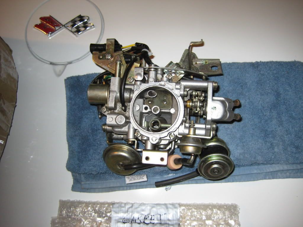

Let's say you get it to this point:

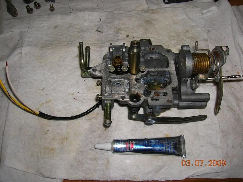

Here, you've cleaned the body and base and are starting to put it back together.
The 'Fuel Cut Solenoid' is screwed into place, and there's a new gasket on the body.
Next, before you install a new Mixture Control Solenoid, you need to set the float level.

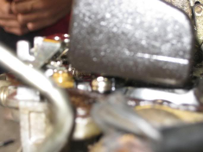

Get your seat and screen (sorry for the blurry picture) and the little gasket that should come with most rebuild kits, and put them into the cover:

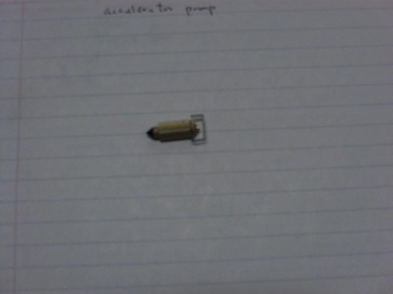

Now you get your needle valve and clip

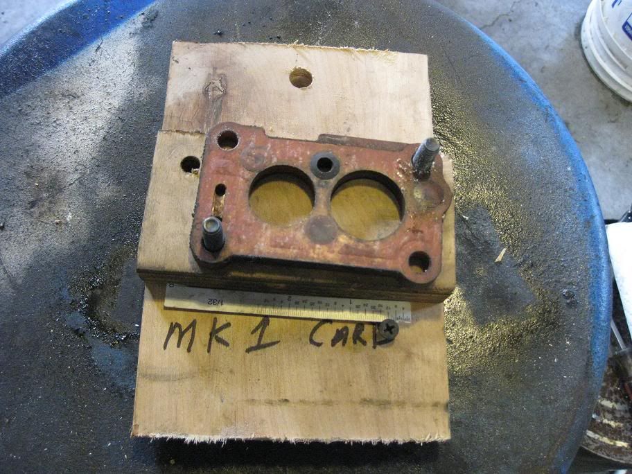

Just wanted to adds some pictures
here i made a simple stand to hold the carb & my carb stx
you can adjust the float on the car use a fine messure stix and adjust by MM at a time till you get it spot on
note the float has a line on it but you can use the bottom edge farthest away from the seat
yes i used the vac- tool bowl to charge the carb bowl to see were the float level

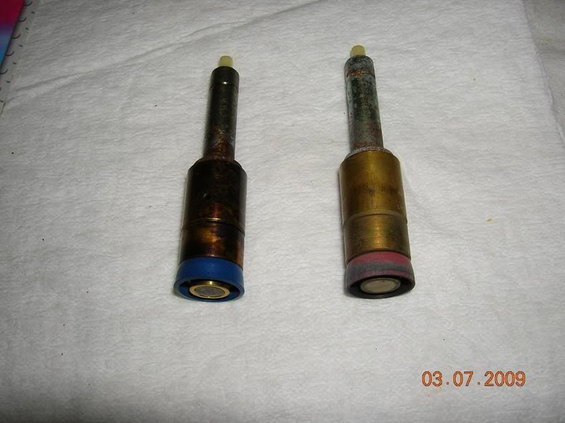

Here's what I'm talking about:
Going from the old (on the right) to the rebuilt (on the left) is not a piece of cake.
Here you can see one that was ruined in the rebuild process (on the left):
...the accelerator pump on the right is still rebuildable, the one on the left is trash.
The rebuild kit is that funny two piece set in the little separate plastic (on the right).
One simple mistake and you've ruined your carburetor, unless you can find another accelerator pump.

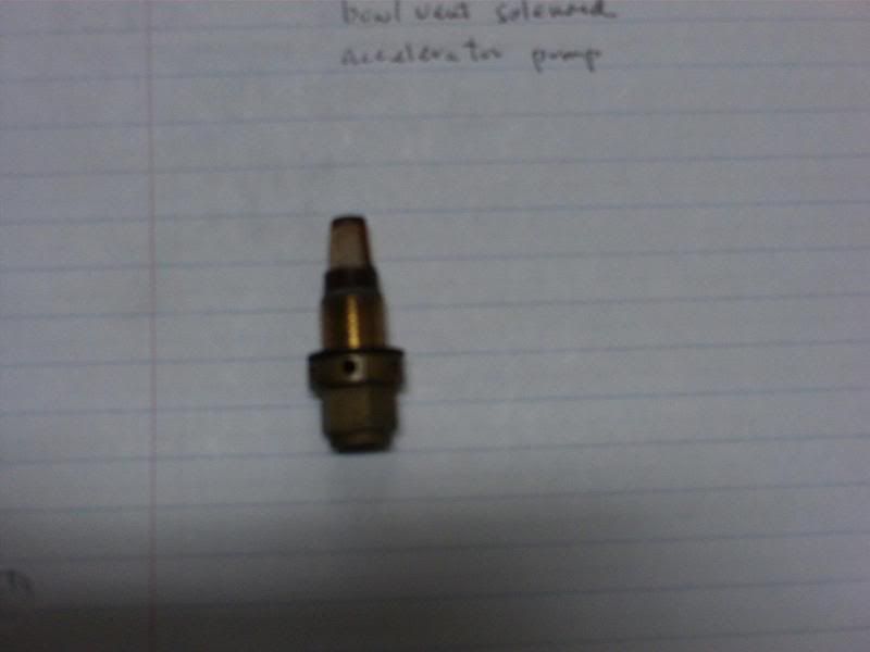

The next time I rebuild an accelerator pump, I'll take a picture of the hollow brass stem which most people accidentally break.
The pump on the left:
has no such hollow brass stem (typical broken pump). The pump on the right has the stem, accelerator seal, and screen assembly intact, waiting to be rebuilt.
You won't be left hanging; when I have a picture of the technique, I'll post it.

This thread is 'bench work'. You want to pull the carburetor and do this on a bench (above, I used a Ducane Barbeque).
No one volunteers to do an accelerator pump rebuild DIY?
(Usually you can just reuse your old one.)
A couple of things come to mind, and I thought I'd add them to this thread.
(We are talking about the USA Hitachi carburetor...)
First, the Float Adjustment, using the technique that Fal, Duke Nukem and I have explained is necessary because the replacement float valves and seats are not OEM. Aftermarket kits, which may supply these parts will also include a set of instructions with measurements. Unfortunately, the little washer which goes under the seat, as well as the seat and needle heights vary. So you can't use a measuring device and get accurate results. It's better to do it like we've outlined above, and it will take a bit longer, but is the most commonly overlooked and most common problem with the 85-88 carbureted Chevy Sprints.

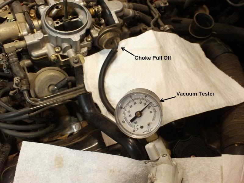

Fifth: Sometimes the 'Choke Pull Off' will leak. Again, we're talking vacuum. You will have to find a replacement, either in a junkyard or ????

Although we haven't had any takers on the challenge to post an 'accelerator pump rebuild' post in this thread, we have had a new member read this thread, rebuild his carburetor, and describe his experiences. He successfully rebuilt his accelerator pump.
You can read about it here:
viewtopic.php?p=369318#p369318
Rebuilding the accelerator pump took some finesse. I took a box cutter blade and cut the rubber plunger off and then wrapped the body of the pump with a cloth rag and grabbed the body with channel locks, I then very gingerly turned the pump cap with a pair of needle nose (very careful to not kink it on the shaft) while pulling upward. Once I put the new plunger on I put a rag over the top of the cap and the bottom of the main pump body and used channel locks to press the cap on. I probably could have taken different measures to ensure safety but it worked so I'm fine with my methods
Skamaniak's method of accelerator pump disassembly is a bit scary and the easiest way to break the pump.
Accelerator pumps generally last a long time, and rarely need to be rebuilt.
Again, here are the two pieces you are replacing when you rebuild an accelerator pump:
1. He's putting on the blue and brass colored pieces to the right in the picture above.
2. The top white arrow shows what happens when you break an accelerator pump.
3. That particular pump was broken when someone used a screwdriver to pry up on the space indicated by the lower white arrow.
4. The black (2 pieces) rubber is the old, removed plunger...equivalent to the new blue piece.
The lower pump is still rebuildable, the upper pump is fish line weight.
Any better suggestions on how to remove the brass piece to the right of the lower white arrow?

If you are still having problems, then you probably need to take the carb apart, clean it, and put it back together. Here is the post where this procedure is illustrated:
viewtopic.php?p=378427#p378427
and a thanks to mkc1962 for posting that.
Remember to follow his instructions carefully, especially the part about drilling the 'plug'.

Where you see 'vacuum leaks' (#1 above), it might not be clear.
Let's illustrate.
This will have an added advantage for those who think you need to rebuild the carburetor, when it is actually OK.
First, let's test the 'vacuum holding' capacity of the choke pull off.
Here is how you do it:
There is no need to pull a huge vacuum; just put the needle up there and see that it holds steady.
If you have to keep squeezing your vacuum tester to get the needle up and it won't hold still, then you have a leak.
As you can see from the pictures, no one is holding the tool and the needle stays in one place.
Next, let's do the secondary diaphragm:
Again, this is a simple procedure and we are looking for a steady needle at about the 3 o'clock position.
Last, let's do the idle up actuator:
The vacuum tester is all the way out towards the hood prop rod, and you are checking the line all the way from the vacuum switch to the idle up actuator.
This completes the checks of the 'vacuum pots' on the carburetor. If all of the needles hold steady, you have a rebuildable carburetor / good core.
Moving away from the carburetor, you can continue to check for vacuum leaks.
You can easily check the second air valve, using the line directly above the one you just checked.
Once that is done, you can check the two or three (depending on your car) lines coming from the gas filter.
