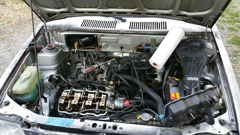

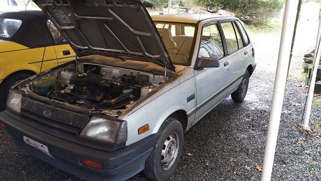

My son's Car.......
1988 chevy sprint 4dr
it was a freebie
been driving it for almost 3 yrs rattle and all
he wore the clutch out so I have decided to UX the motor and trans
with a spare I have rat holed for this very reason
Here's a video let me know what you think the noise is from after the ux I might tear into it to see what the noise from
........jv&s
https://www.youtube.com/watch?v=5oEPhonZd8Q[album][album][/album][/album]

Valves badly out of adjustment? Mine sounds like that all the time, flat tappet cam shaft. Noisy valve train. Check the oil too.ensure there is enough oil at idle.

sounds like valves and a hogged out crank key

I would normally agree about the valve chatter but this rattle is low behind the water pump
My guess is rist pin

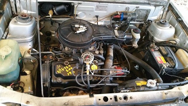

did a compression check (hot) on the motor coming out
#1 185,
#2 200,
#3 190,
prep the spare motor inspected T-Belt parted trans although the disc was used wear was not bad %60
put in a new disc because of driver
The boy goes through 5 Clutches 3 motors & 3 different cars
Daughter..still one her 1st Motor/Car/Clutch
10 yrs.?
PostPosted: Tue Feb 16, 2016 12:49 am

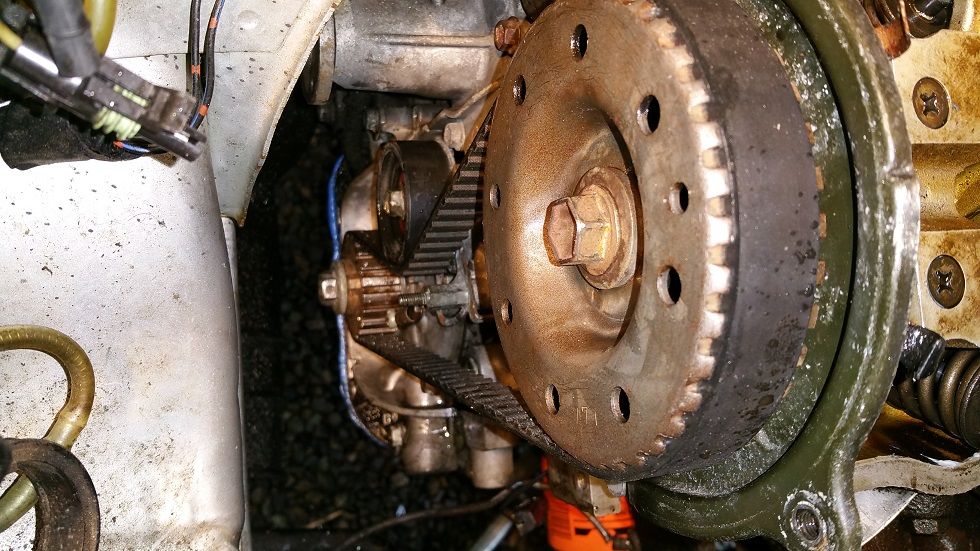

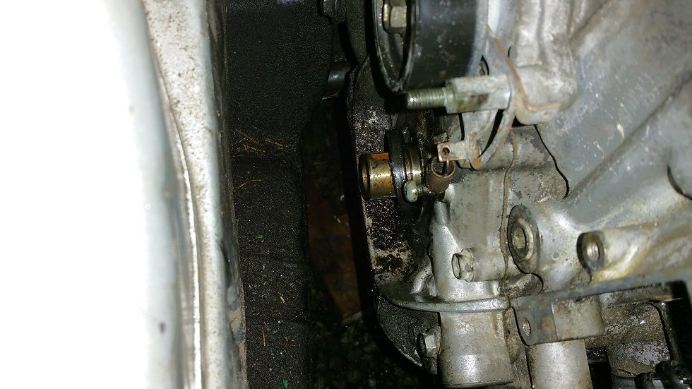

It sounds to me more like noise from the valvetrain. Wouldn't a bad wrist pin be noisier under load rather than idle?
Also, a failing timing belt tensioner can make this same kind of dull cyclical thudding noise.
PostPosted: Tue Feb 16, 2016 6:25 am
well now you might be on to something
The noise has been going on for 3 yrs most noticeable at first start up after it has been sitting for a few days or after you unload while driving (decelerating)with no load as in coasting to a stop in gear once you push clutch in it fades out....
But I never ever thought The Idler pully I'll pull the motor later today (life permitting ) and check that out

I with ya it's been rattl'n for 3 yrs
I did pull the idler and it was solid with no noise from it
I had to stop on investigating were the noise is

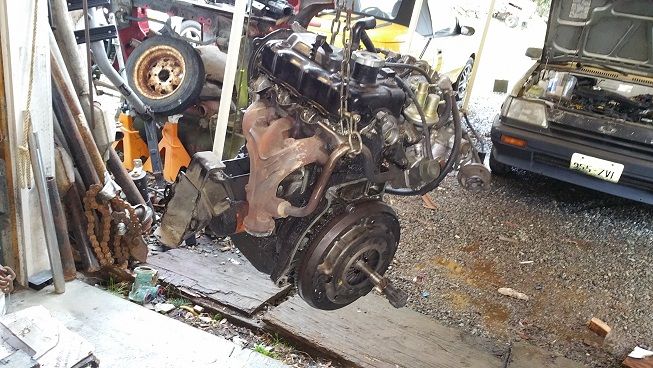

I was totally delusional thinking I could dig out a spare motor tha tI have shelved 5 yrs ago that had good compression 175-180 with 185,000 miles on & set it into a 28yr old car and it would be a go'r.
NOT

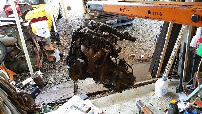

pulled old motor .put a new disc and T-belt installed spare motor Ever mount and sensor shot
27 hours later and it's a smoker..............

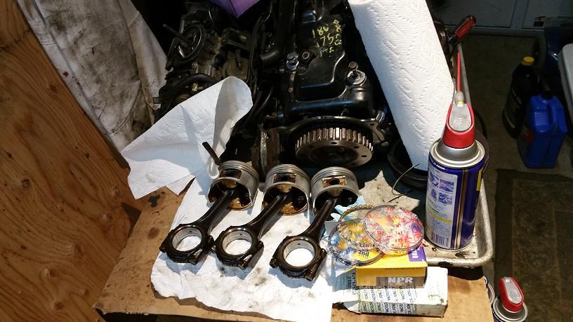

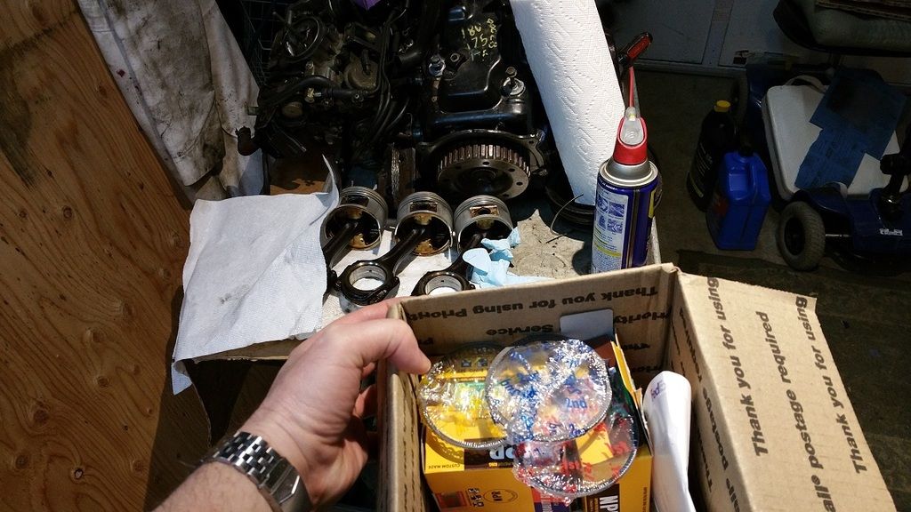

PostPosted: Fri Feb 26, 2016 11:17 pm
just got the rings I needed to put this together
Just need time

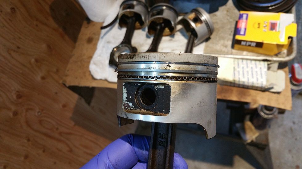

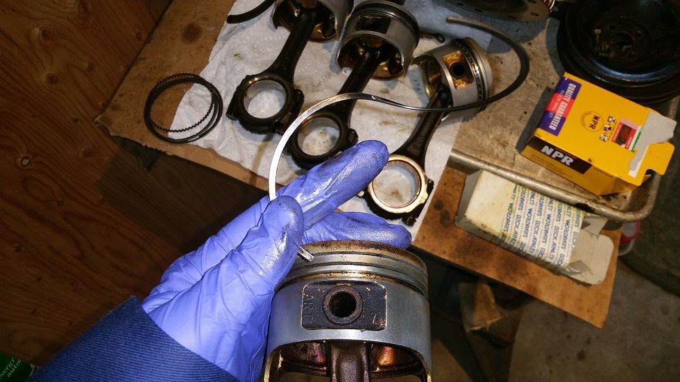

When installing Ring make sure the ring glans are clean you can use the old ring to clean the grove
you can see this piston oil ring (lowest ring on piston) is stuck in no give it came from a car that smoked
cleaning piston
Installing new Ring on piston make sure you have the Makers mark on the up side (the little "N")
UP

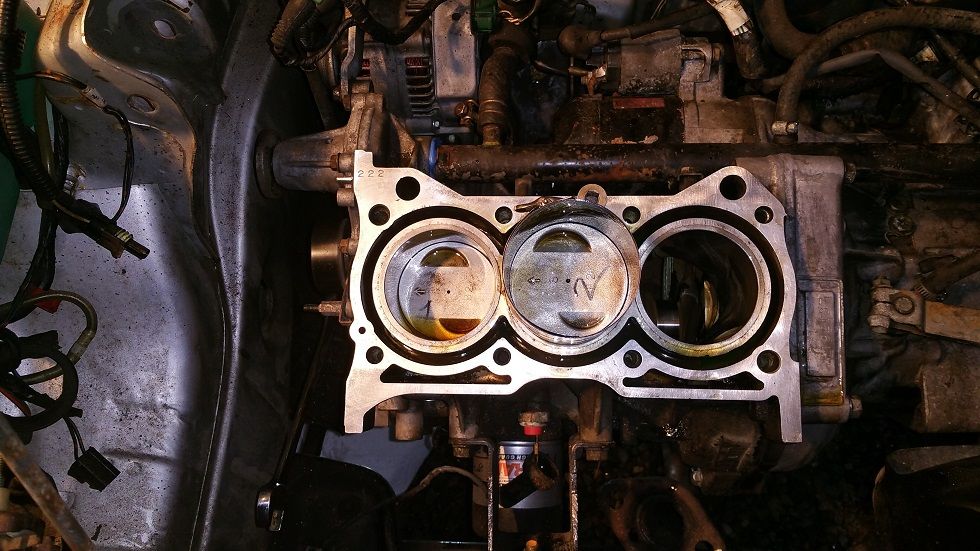

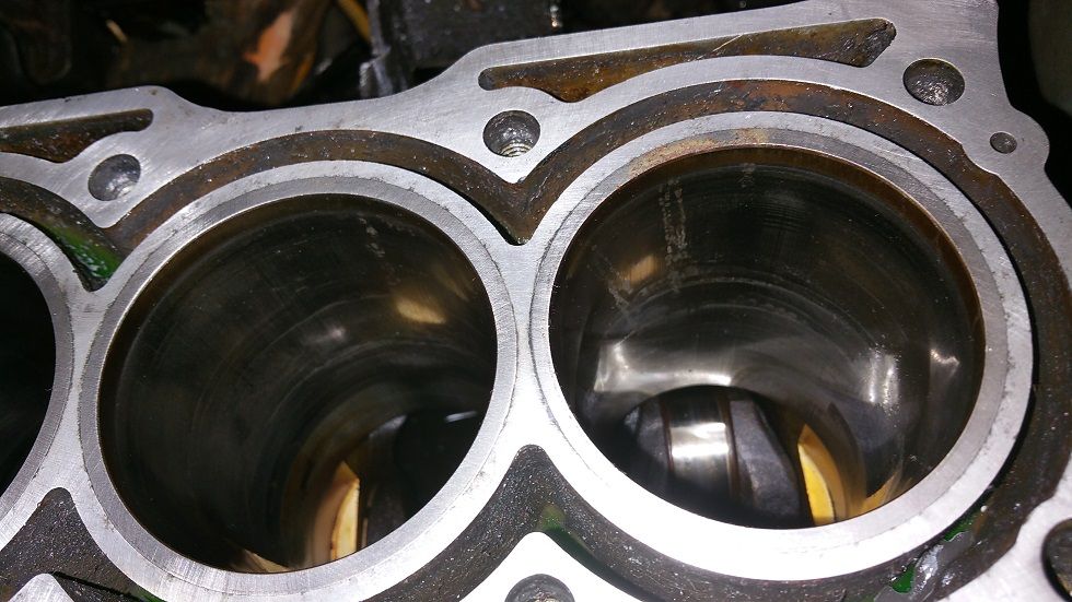

PostPosted: Fri Mar 04, 2016 11:35 pm

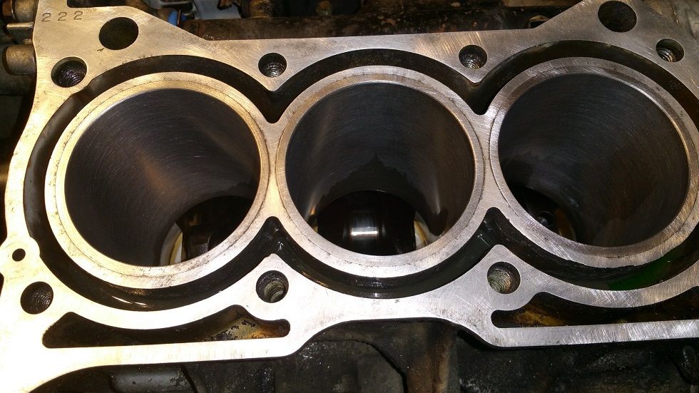

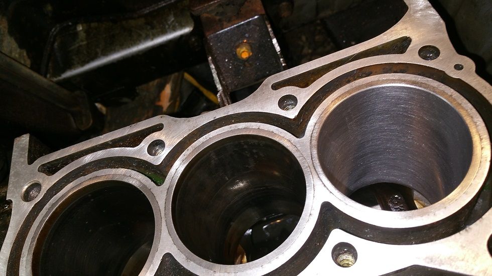

After Rings installed

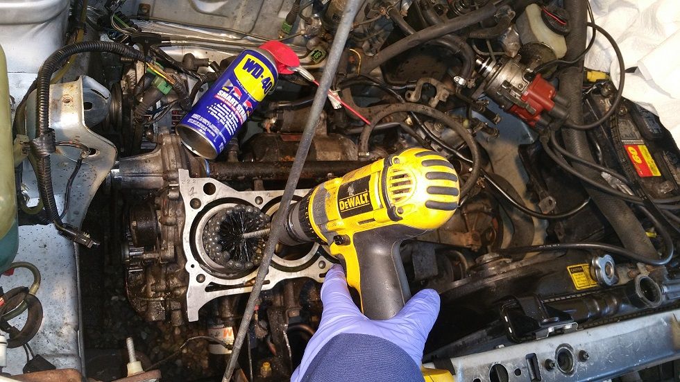

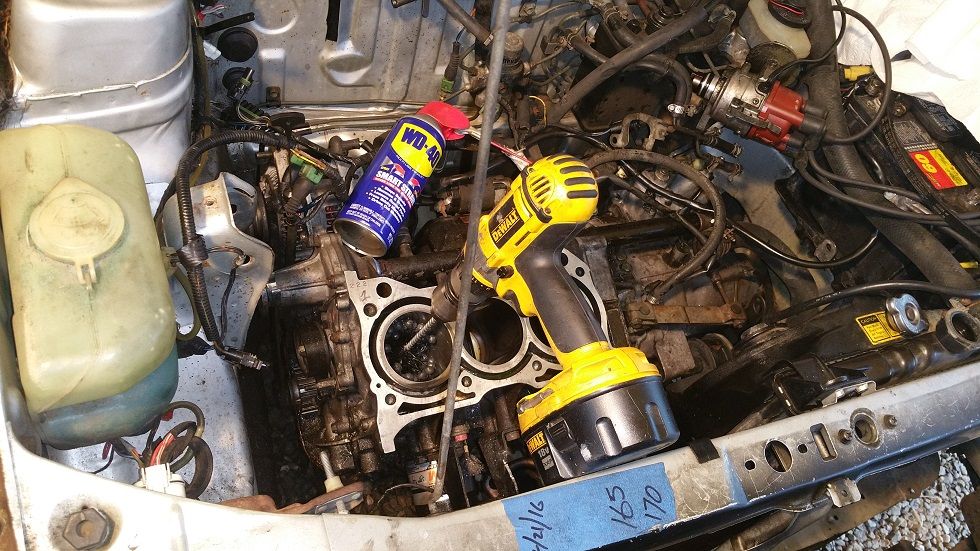

looking at the cylinder walls found no ridge but they were smooth need to break that glaze to help new ring seal
GLAZE
scuff up cylinders used WD40 then 30 wt oil the Wd40 cuts gaze agresive top off with oil to finish
after done wipe out (Clean) all cylinders with fresh oil and clean rags

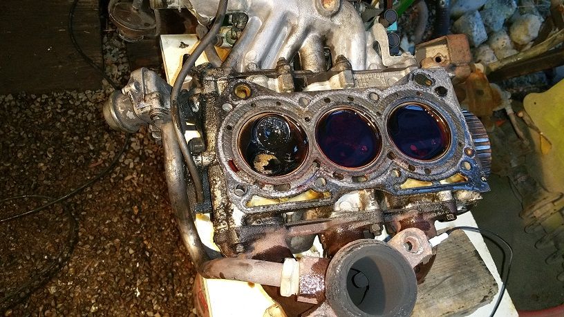

PostPosted: Fri Mar 04, 2016 11:40 pm
setting in piston with clean oil bath

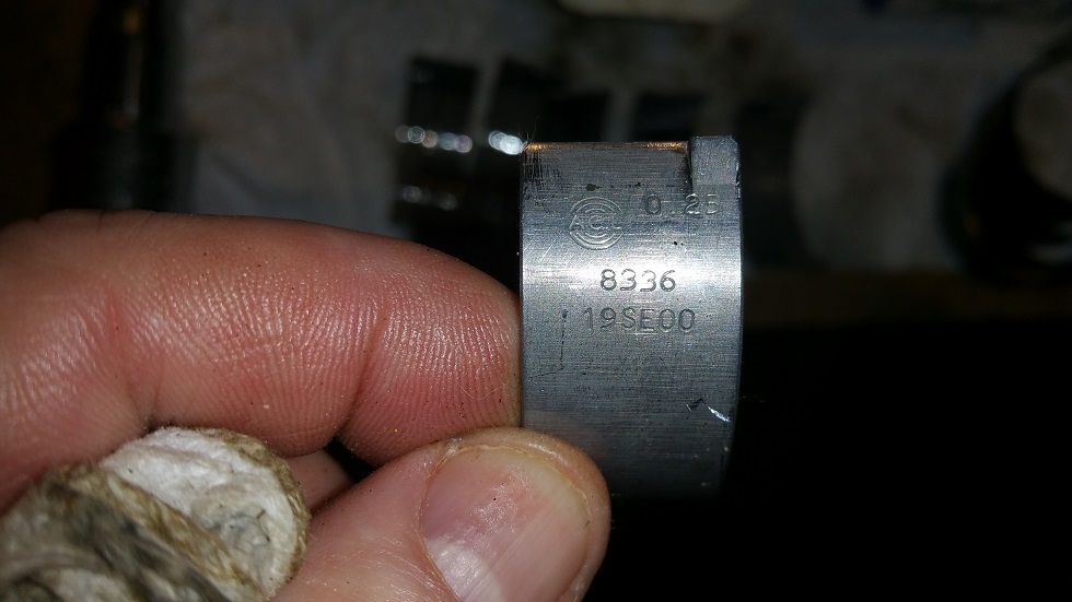

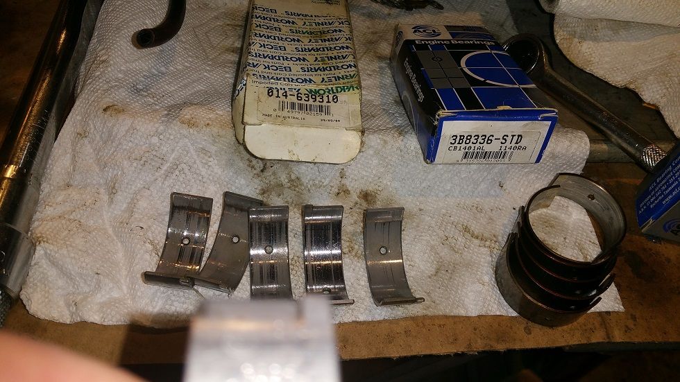

The rod bearing had a bit of wear so I changed them
with new Bearing from the white box
I lubed and put rod bearing in....... torquing them down the engine got tighter and tighter to 24lb the engine would not turn locked solid.
Removed new bearing found out they were over sized with a stamp .025
Nothing on the box and they were new in shrink rap
old rod bearing on the right
New oversized on the left
Lost 3 hrs

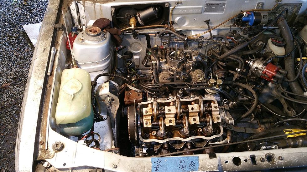

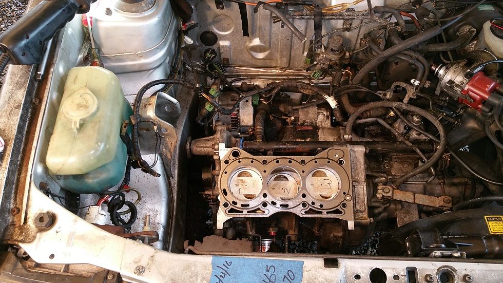

PostPosted: Sun Mar 06, 2016 9:38 pm

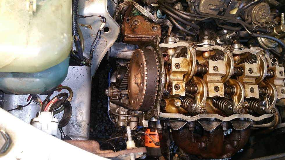

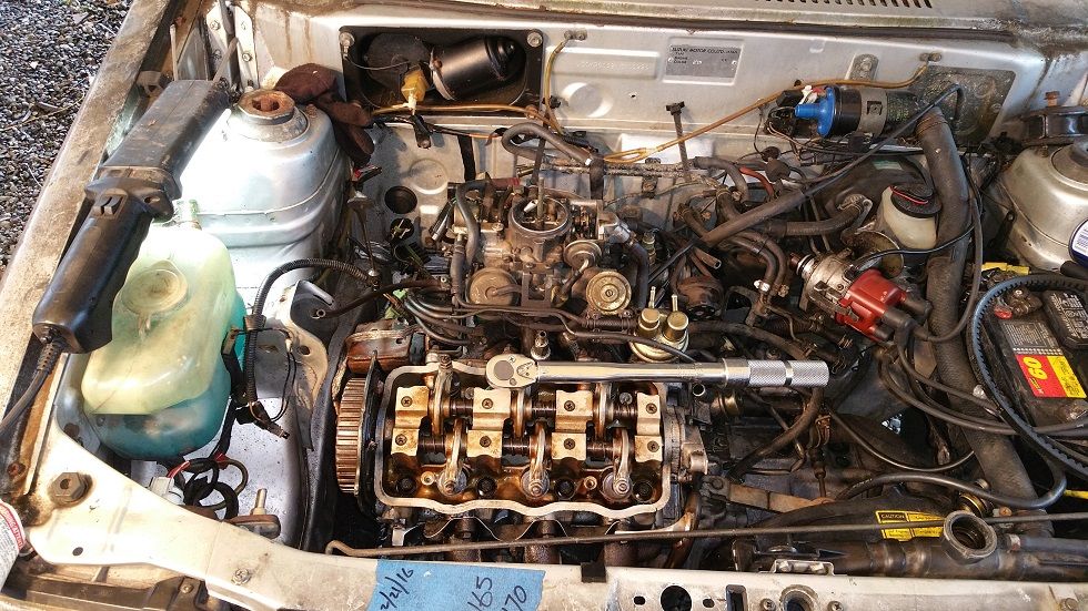

cleaning the head bolt and head gasket surfaces with degreaser
The Head gasket is on backwards (in Pic)
no reason just were I layed it when i snap the picture
I made it right before it went together

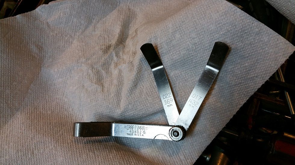

torq down the head 20- 35 -58 Lb final
reinstall the timing belt
SORRY NOT CORRECT

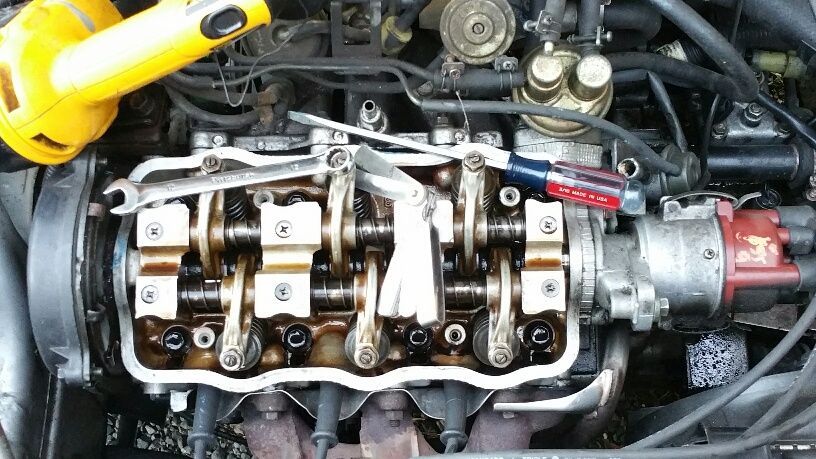

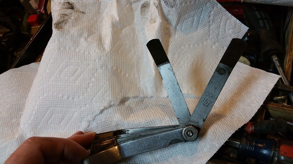

Gaping the valves COLD .017 intake .022 exhaust
actually 6 intake 8 exhaust
Put a fork in it...!
............................... It runs well Break in miles 55
Last edited by jaguar,vettes&sprints on Mon Mar 07, 2016 10:38 pm, edited 2 times in total.

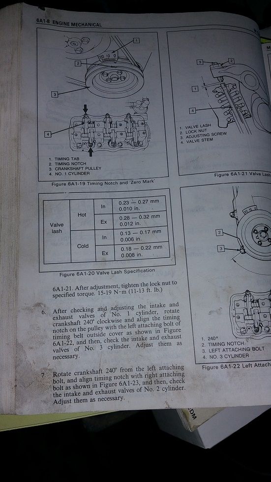

PostPosted: Mon Mar 07, 2016 7:33 am
6 and 8.
MK1 engines run fine if you set the valves at 6 and 8.
Easy to remember, same as the old Chevy V8's.
Plus, they run a lot quieter.
PostPosted: Mon Mar 07, 2016 10:45 pm
6 and 8.
Thanks phil for proof reading my post
you are correct about the valve gap I 006 & E 008..(.NOT 17 - 22)
Here is the page from the factory service manual
this is were I went WRONG
RIGHT
The Video
Before Pacapo turned me around
After adjusted valves properly
