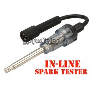

Now, let's look at 'spark'.
If you put an inline spark tester
and observe the tester during the run/fail situation you can also determine if it is a spark or gas problem.
(If the spark continues while the engine fails, you can pretty much eliminate 'spark' as the issue.)
Likewise, if the engine fails at the same time the tester shows no spark, you've pretty much nailed the problem to the ignitor.
In line spark testers are around $5. Even so, they should be considered a valuable asset to your tool arsenal.
