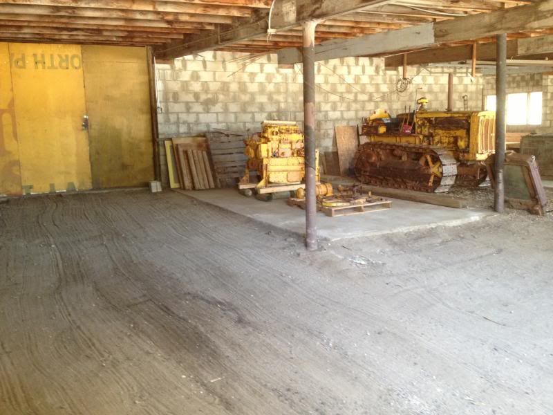

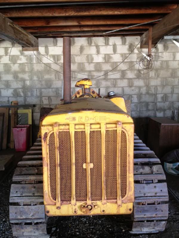

I bought a new yellow 'daily driver':
...well, maybe not new, but a helluva daily driver.
Plus, the Wife bought me a spare engine in case the D-315 kicks the bucket:
