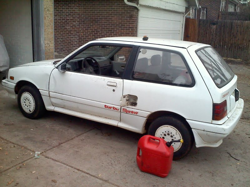

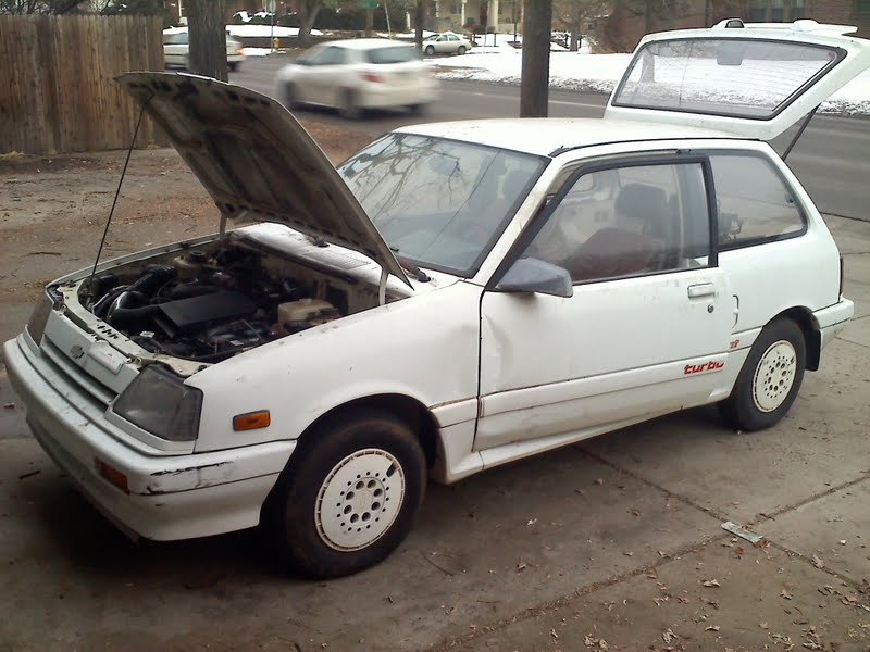

OK, hey guys. We posted, we asked questions, we got a sprint turbo for dirt cheap (and it looks it), we got it running, now we got a build thread.
Here she is in all her bone stock glory....
Previous owner hadn't had it running in over 2 years. Turns out it needed a new coil and/or distributor. But she runs today! We took it for a spin today and we were quite impressed with the grunt of this little thing with both of us in the car. And we're at 5200 ft in elevation as well. We'll be updating this thread as it comes along. We'll be asking more questions so stay tuned!

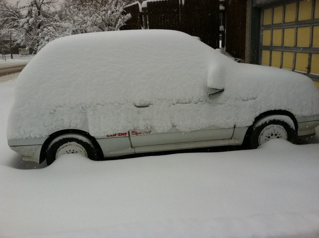

Expecting close to half a foot of snow tonight so might not get to much in the next few days. Hopefully Kinch can get it emissioned so we can take it to the truck stop and run it up on the scales for an initial weigh in.

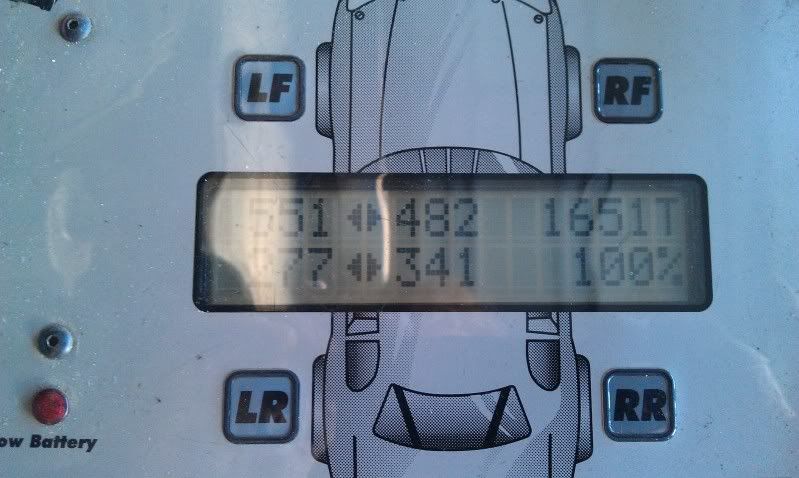

So a friend has an identical turbo sprint at his shop right now (coincidentally). So he rolled it up on the corner scales and got this....
This was weighed with full interior,stock wheels/tires, fluids, spare, jack, etc.
We'd like to take ours over and weigh it as well just to see how close ours is. I wouldn't expect it to differ much if at all.
Van

750kg .. about right on the nose for the stock car weight!!! Once you start to strip out all the stuff you don't need you can reduce it down by over 100kg's
Interesting to see the differences in each of the different corner weights

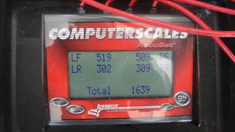

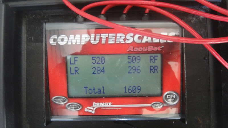

OK, so this is not really any update or progress but we borrowed some scales and weighed ours just to see where we are starting off from.
Not too bad cross-weight wise. Kinda curious as to why ours is so different than the other sprint turbo weight I posted previously. I can only guess the different set of scales and perhaps the levelness of the ground.
Took out the spare tire and jack and this is how it weighed.

Sagging drivers spring can shift weight to diagonal corners as well, I weighed mine on several different flat surfaces, and on the flat but not level floor it only shifted a few lb's around the scale, not as much as I was expecting.
Here is my corner weights to give you an idea, remember my seat, steering and pedals are on the other side and the fuel and large muffler are over the left rear, 3/4 tank of fuel (2.5 gallons) and michelin slicks, don't forget there is probably 80-85lbs of rollcage.
My scales aren't as accurate as those nice Longacre ones you are using so the actual numbers could be +/-10lbs on each wheel but the weight distribution is what is most useful, about 66/33 improves to about 61/39 when I am in the car but then the cross weight is all messed up.
LF = 456lbs, RF = 462lbs
LR = 227lbs, RR = 231lbs
As you can see the weight reduction comes mostly out of the rear, what is harder to measure is the centre of gravity, these cars are far too tall so you need to keep the weight as low as possible.

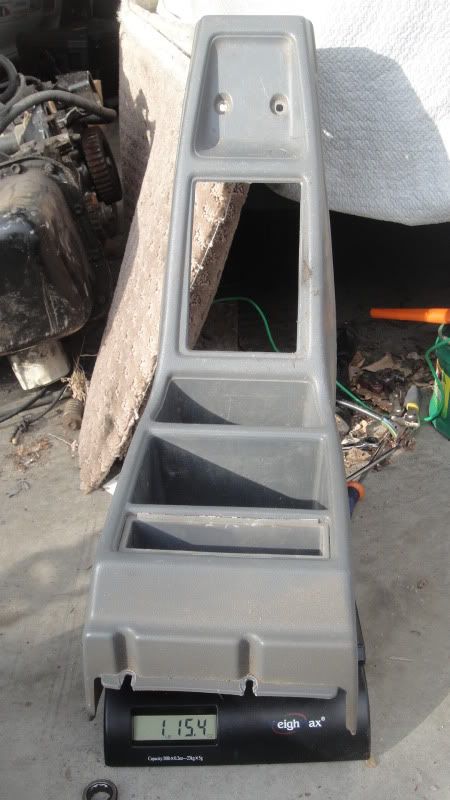

Took a few bits and pieces off and weighed them...
Center console piece: 1 lb 15 oz

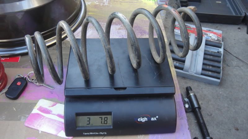

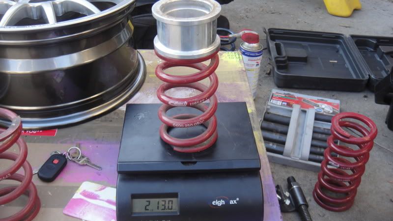

We had some random springs laying around so took the stock front spring off: 3 lb 7.8 oz
Threw on some 6" 500 lb springs with a 2" spacer: 2 lb 13 oz
We had initially put just the 6" spring on and the car looked aggressively low but after rolling the fenders and cutting the plastic liner, it still rubbed on full lock with the 195/50/15 Toyo R1R's. This was figured out this morning at the autocross so we just put the spacer back on and we'll deal with it later. Besides this is just a temp setup just for fun.

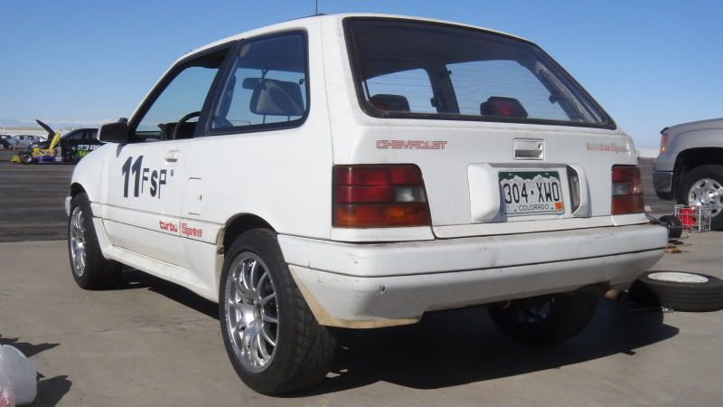

Autocross today. Car was surprisingly nimble on our tight course. Definitely, definitely need a limited slip.

Put some smaller rubber on that thing, and it'll handle WAY better.
This is our "rain" setup. Toyo R1R's are a beast in the rain vs Hoosier Wets and the Kumho W710's and at a fraction of the cost.
There is no better "street" tire that is smaller than the 195/15 Toyo R1R.
13" Hoosiers will come eventually but not anytime soon as we have other more dedicated race cars to tinker with instead.

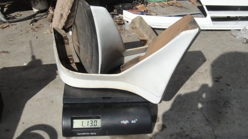

We picked up a Grant racing wheel for free. It's a 13" which is a little bigger than what we wanted but hey, it was free. Actually though, the size might be just right considering we eventually will be trying to turn big sticky tires with no power steering. We'll see though. We did save some weight which is good. Stock steering wheel is 4 lb 2 oz.
Here's the weight of the Grant. (there are others a good bit lighter though)....
