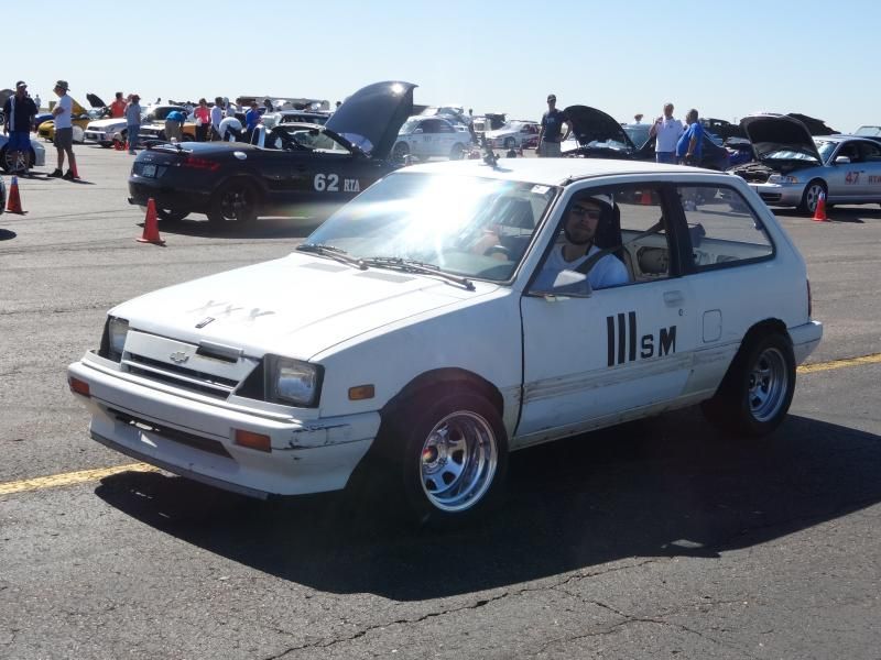

Not a picture of the LSD but the of car in all its glory today. It's pretty crazy that just yesterday, it had no shifter, no battery, no radiator, no wheels/tires, no exhaust, etc etc and then today we ran it in Street Modified (which was in 1st heat so we could hurry and get home to our wives and kids) and Kinch and I take 1st and 2nd respectively out of a class of 12. The local SM guys weren't brimming with excitement that a piece of junk car like ours beat them. :)
But to add to what Kinch said, we ended up within the same second as a former National Championship FSP car so that is promising for us. Still got lots to do. Time for us to hit the gym cause moving those tires back and forth on course takes some strength!
Van

I can't really tell from the pictures. But are those aero wheels? If so. How are they running? I was looking at a set of those in 13x7. Which is their smallest size. I would have to change bolt size to something like 1/2 inch to fit 45 degree lugs.
If those are aero wheels. What lug size and stud size did you go with? Was it hard to drill out and replace the studs?
Anyway. Nice ride. Good to see sprints can kick some butt on the track with "mild" modification. :lol:

The fronts are 13x10 Spinwerks and the rears are some 13x8 Circle Racing wheels off of Summitracing.

10's are crazy wide, I'd be inclined to try 7's on the back and move the 8's to the front, what tire size are you guys running?

We are testing out the 13x10's in the front with the 255/40/13 Hoosiers. We're going to eventually do some back to back testing with 13x8's in the front with 225/45/13 Hoosiers. I'm of the feeling that the 225's on the 8's will be more manageable and easier to turn and possibly overall faster even if they don't have quite as much grip as the 255's. With the 5" backspace in the front, it ever so slightly hits the strut. Hoping that a little grinding can take care of that. We want the wheels as far inboard as possible.
