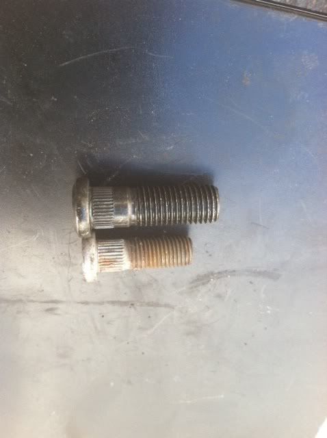

And in preparation for the bigger tires, we figured bigger studs would be safer....
Here's one in....
We gained 0.6 oz per stud (1.4 oz vs 0.8 oz) but the 9.6 oz gain is well worth it to us.

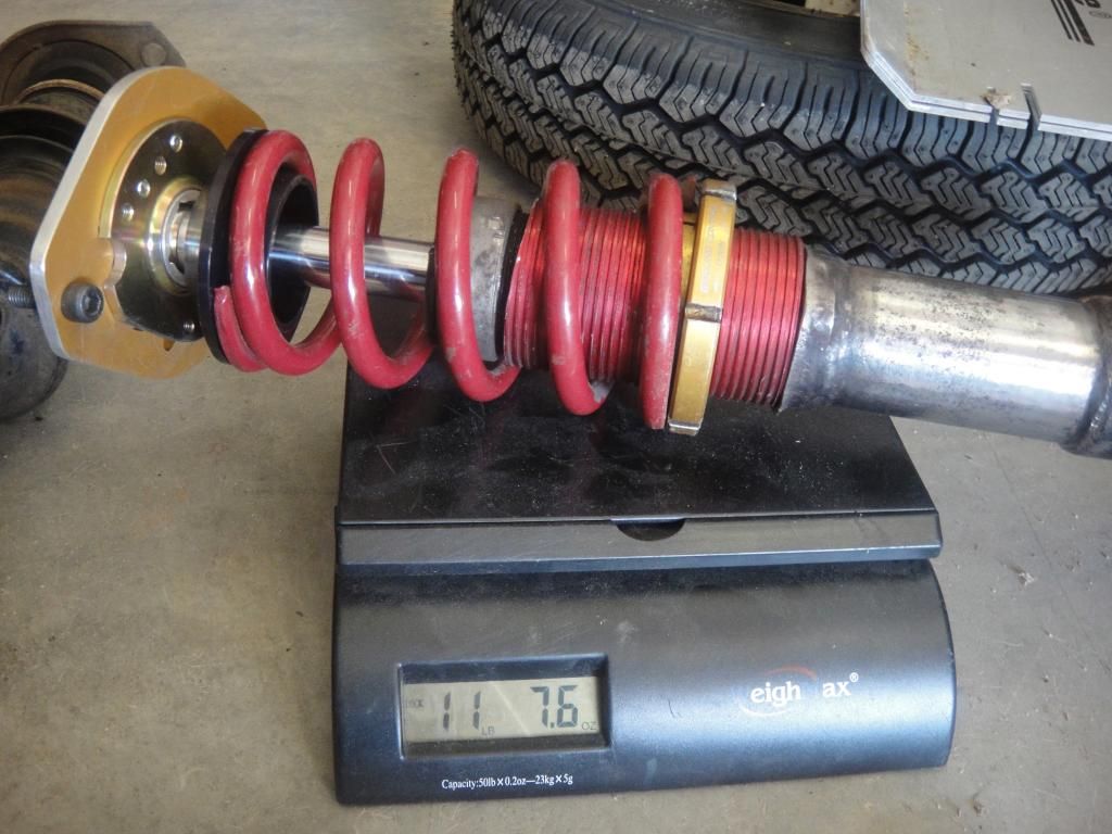

We're working on a height adjustable coilover for the front. Slowly but surely. Sorry no pics just yet. Will try and get around to that later. Just throwing the idea out there.
We're using MK1 VW struts because those take on koni inserts almost perfectly. We've got a couple different length double adjustable inserts to play with. The VW MK1 bottom strut bolt holes don't quite line up with the Sprint so that will take some fudging to work but it shouldn't be a big issue. With the top bolt hole lined up, the bottom one is only off by about half a hole.
The Koni piston rod is slightly thicker than the stock shock but that's nothing a little drilling of the upper mount can't fix.
Hopefully more updates soon.

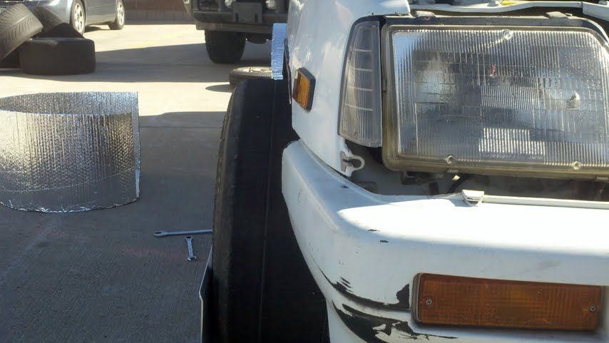

The class we're building for doesn't allow gutting. We can strip certain trim pieces though which we've done. The rules do allow us to swap parts between any 85-87 sprint so we have been weighing various parts between our ER and our turbo.
Notice we have the recessed headlights instead of the composite ones standard on the turbo. Saved us 3 lbs of weight in front of the axle. Little things add up!
Radiator swap eventually. Gonna weigh the rear bench vs split seats. The turbo hatchlid is slightly different. Not sure if there is much weight to be lost but we'll check.
Still got to get the race seats installed and the 3 lb battery (vs 34 lbs for the current stock one). Once those are in, we should break under 1500lbs.

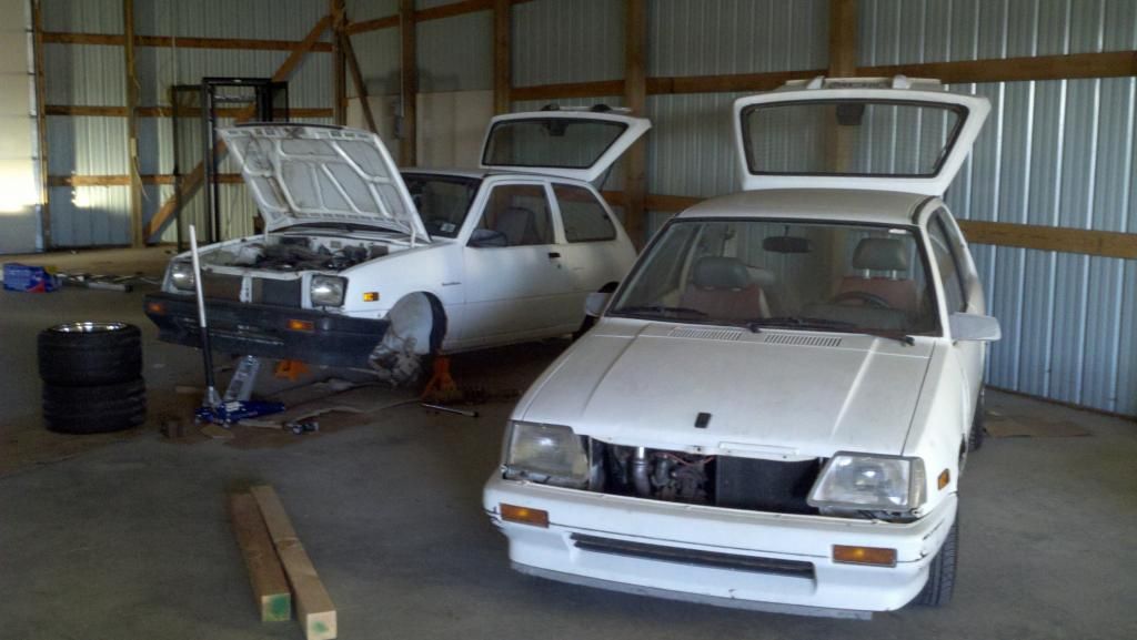

Since I mentioned we have a parts car, here is a pic of it alongside the racecar which I've dubbed the "tetanusmobile".
Van

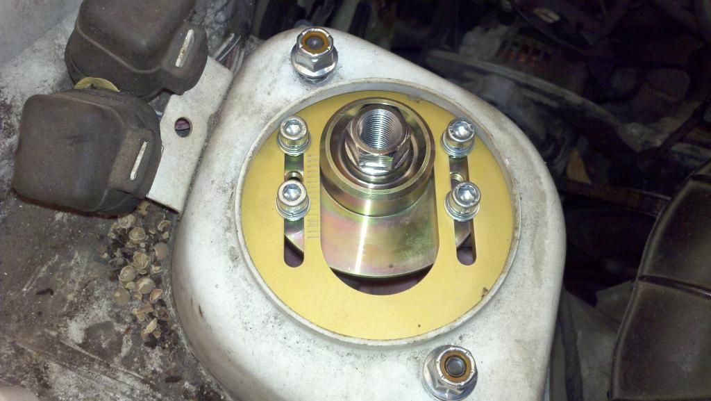

Oh hello there, camber and caster! I don't believe you and Mr. Sprint have ever met?
Van

Not only do we now have ride height adjustability, 2-way Koni adjustability and camber and caster adjustability.....it weighs a couple ounces less than the stock spring and strut setup. Boom!
Unfortunately, we were bottoming out at our last event so we're gonna need to redo these so we can run it as low as possible and not bottom out. The temporary fix was to raise the ride height a few turns. We want the car as low as possible.
Van

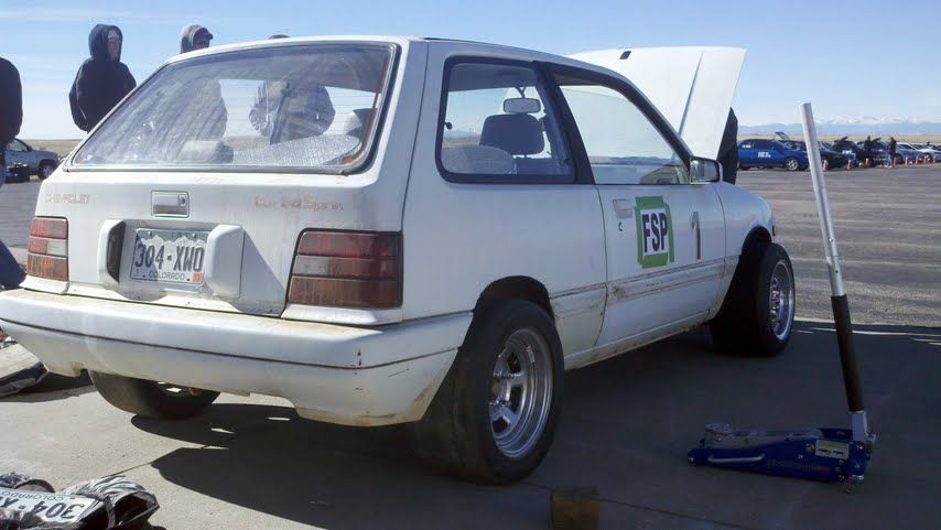

Yes moar tire please....
Camber is bueno....
Van

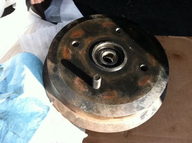

Noticed a bit of brake fluid on the ground. Thought I must not have tightened it after bleeding them. But that was not this issue. Not sure how the shoe on the left got off of the cylinder but it did. And it looks like the fluid was coming out of the shoe on the right side. Time for a major cleaning and repair.

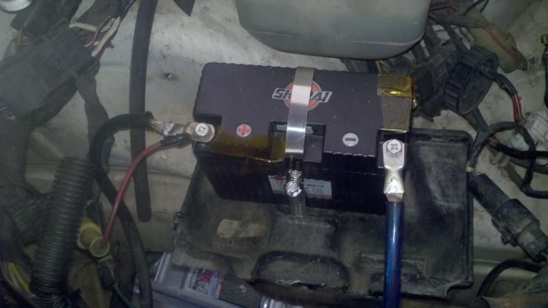

Did some more fiddlin' around with the Tetanus Turbo today.

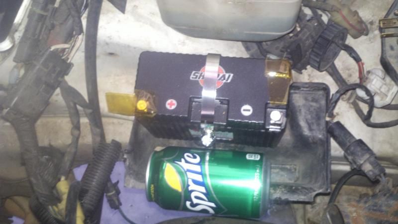

Got the lightweight Shorai battery installed. Cranked the car up no problems. The battery weighs in at a hefty 1 lb 15.8 oz!! The stock battery was around 34 lbs. We also lost over a pound swapping out battery cables and a few ounces by cutting down the size of the battery tray. I was gonna cut it down to size but we decided to leave it a little bigger in case we go back to a bigger battery in the future for some crazy reason....
To put the size of the battery in perspective....(sorry for bad phone pics)....

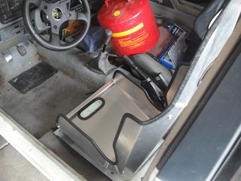

We also got the race seat installed. Can't remember the exact weights on it but we dropped about 8 and a half lbs from the stock seat and we kept the slider. Unfortunately it's pretty darn flimsy so we'll need to brace it a little better. This is a picture without the seat cover.
Right now the car is sitting around 1500 lbs with full interior still! Class rules don't allow stripping of the interior so we're dropping weight where we can.
