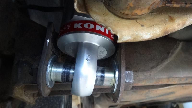

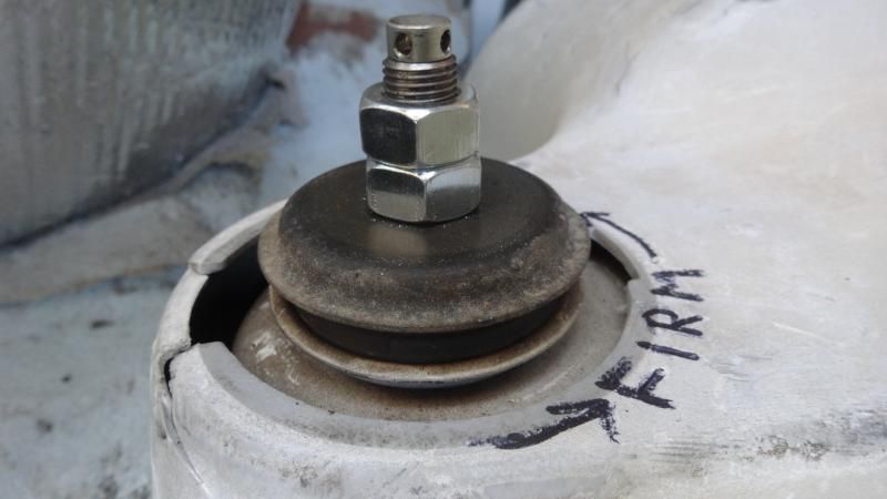

Long time no update. Sorry. Not much has happened since last October. We haven't raced it since then. But....we finally got some pimp rear shocks! The OEM junk shocks were more than likely blown and still I was able to do well in the car last year. But the lack of rotation on the rear end made for a pushy car and a difficult time turning the wheel as well.
Double adjustable Koni race. Compression on the bottom. Passenger side is very easy to get to. Image
Driver's side is not as easy to get to. Luckily it's just a turn of the knob and clicks so should be able to adjust on the fly if we need to.
Rebound up top. Doesn't use the standard Koni knob. Just a small allen wrench or whatever to slide in the hole.
Memorizing which way to adjust rebound? Aint nobody got time for that!

pimp rear shocks!
That is a very nice setup! Thanks for updating/sharing.

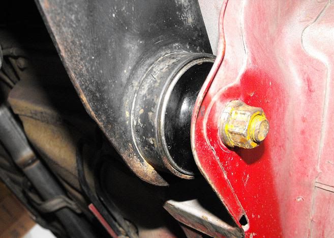

You may try pressing in a new rear bushing...
Rear Trailing Arm Bushings - Front Position Whiteline W61456 W61456
http://www.ebay.com/itm/141189615736?_trksid=p2055119.m1438.l2649&ssPageName=STRK%3AMEBIDX%3AIT
I love your adjustable rear spring perch, you've gone leaps and bounds in
fine tuning your OE rear suspension, that is really cool the way you have the rear
set up.

Ha thanks. The adjustable perch is actually kinda ghetto but it works. It just slides into the OE perch which has been grinded out a bit so that it will fit. Every time we jack the car up we have to make sure the adjustable perch lines back up into the hole. Not a big deal though.
And yes, we do need to get around to doing bushings. Last year Kinch ended up 2nd in STC at nationals so again this year he has been focusing on the Civic more so than the sprint. So sprint has been taking a back seat as far as driving, development, etc.
