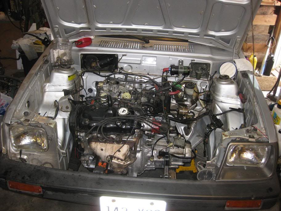

Support the engine with something. I used my Hill Billy rope to tie it back to a secure area pulling the weight toward the passanger side.
Sorry, the image did not resize properly. Can you see the rope to the bottom left?

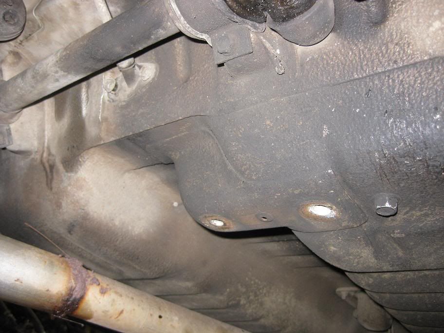

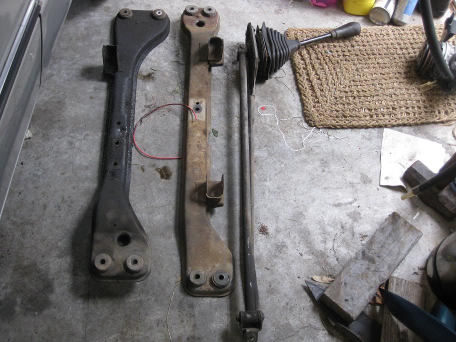

Now then, as you may have noticed, the cross member on the automatic looks different and mounts in a different location (a few inches closer to the passangers' side) than the manual one does. No need to panic! The bolt holes for the manual crossmember are already on your automatic! As a matter of fact, the 2 crossmembers actually share 1 common bolt hole.
Now, my car was pretty rusty, so I had some rust accumulation built up in the bolt holes where my new crossmember was going, but that didn't cause any problems whatsoever for me; do keep in mind that you might possibly have to re-tap these threads. One of the bolt holes will be covered by a filler (dead) bolt and possibly undercoating. You will have to uncover this hole by removing this bolt that appears to have no purpose. What you should have in the end are 2 bolt holes at the back and 2 bolts holes in the front parrallel to each other just like the manual donor car.

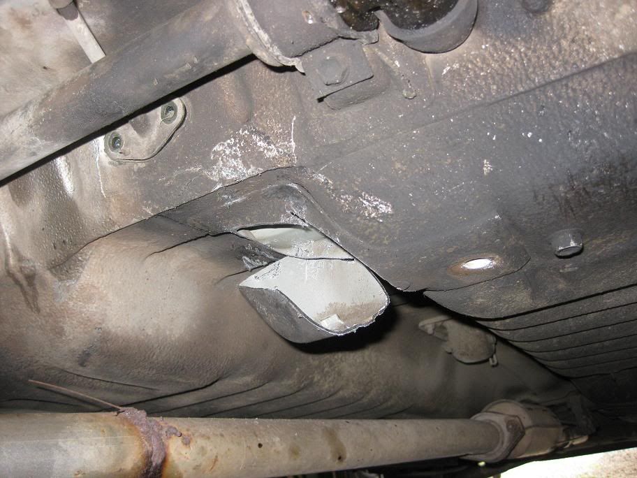

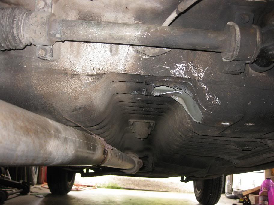

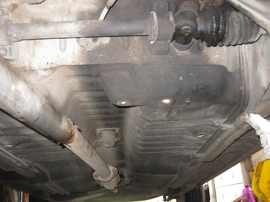

Now here's what I meant by the point of no return. Have a look at the picture that jaguar,vettes&sprints took to illustrate the part that has to be cut out to allow room for the new shift linkages.
Use a reciprocating saw and or a grinder to cut this old cross member mounting point out, don't try to hit it or chisel it out or you will end up putting holes right through to the interior of the car (not that anybody would try to do that). That's it.

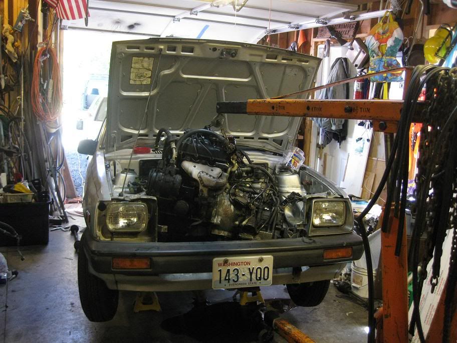

I wanted to add some more picture's to an exlent post
this is a 1985 Suzuki Forsa (chevy sprint) 4DR
OUT
IN
Here is the hump you need to cut out ( notice the bolt just to the right you have to remove to use the stdrd Tran cross member
after the cut
.Here's the cross members the one on your left is the AT Crss Member (note the kick over on the mounting bolts
The one on the right is the one you need for the manual trans
they are acually turned around the hole for the radiator in the manual crss Member is in the back
.........jv&s
