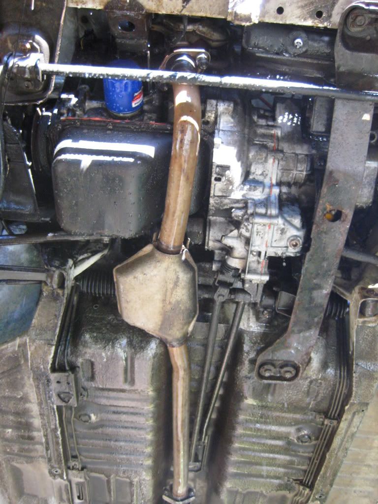

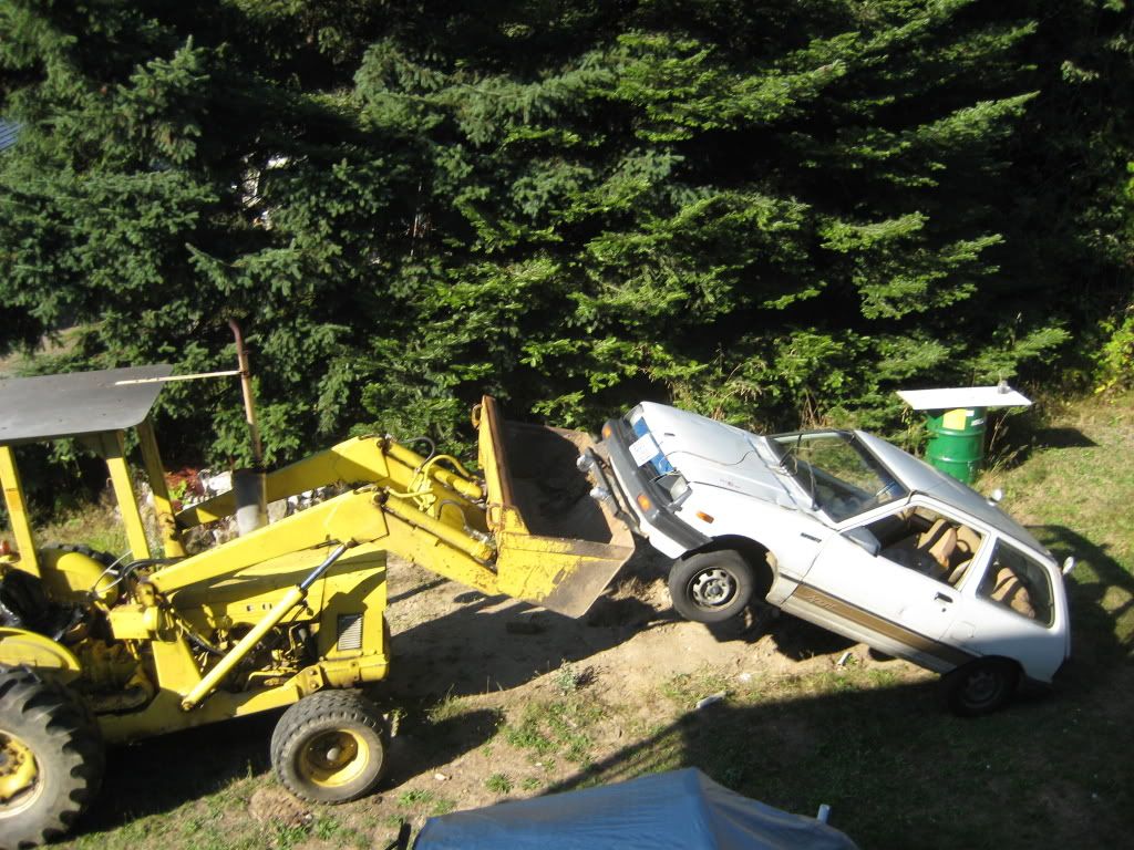

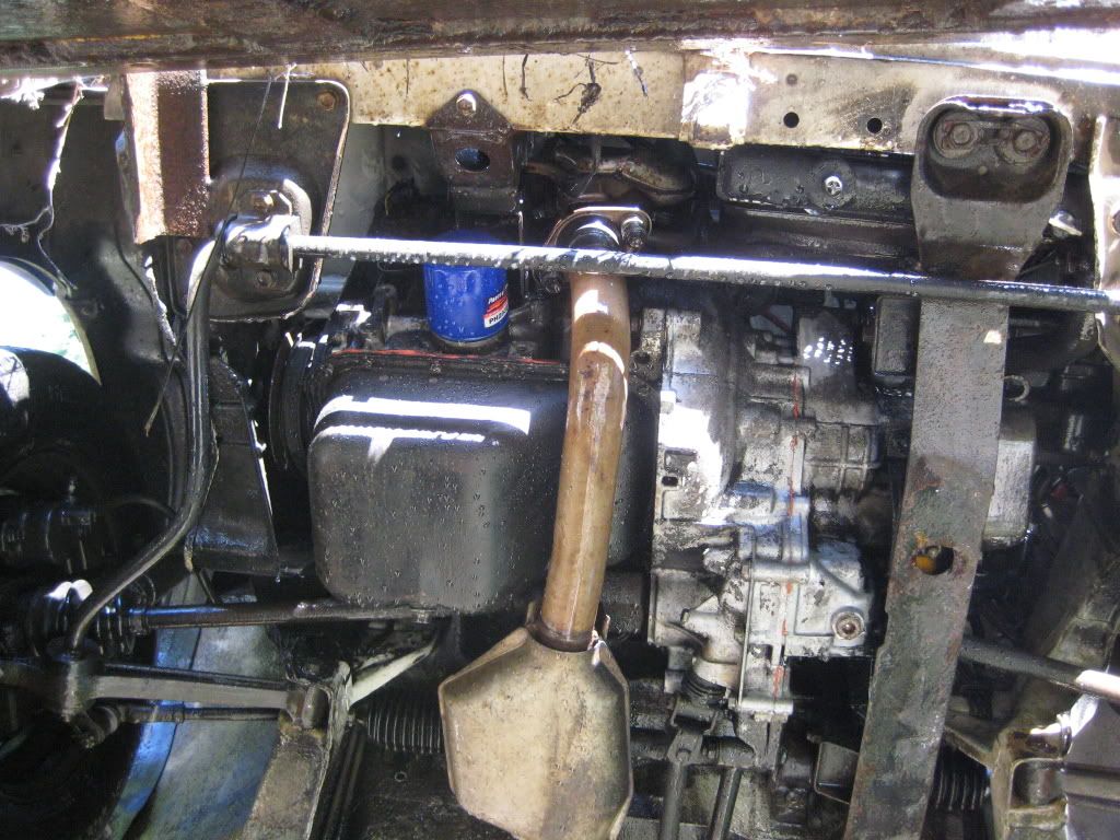

I needed to wash the oil and grime off this car before I took it apart
woorked good I could get in all those little pocket underneith
No jacks thats way to dangerous..
This is how I roll

You got another one? I dont remember seeing that one yet.
I did the engine bay of my sprint this spring, makes it soo much nicer to work on. Though I didnt have the fancy schmancy lift you've got, I had to use steel ramps.

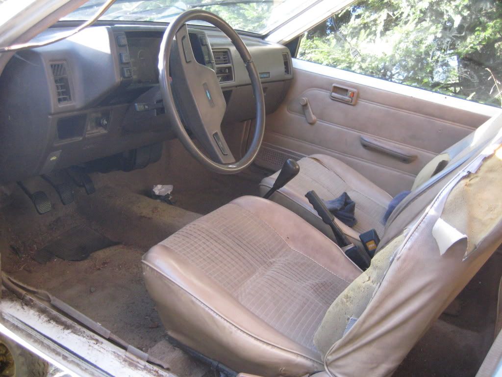

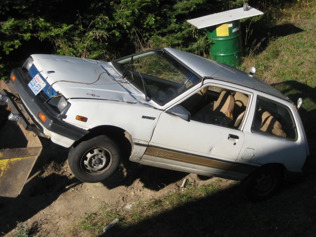

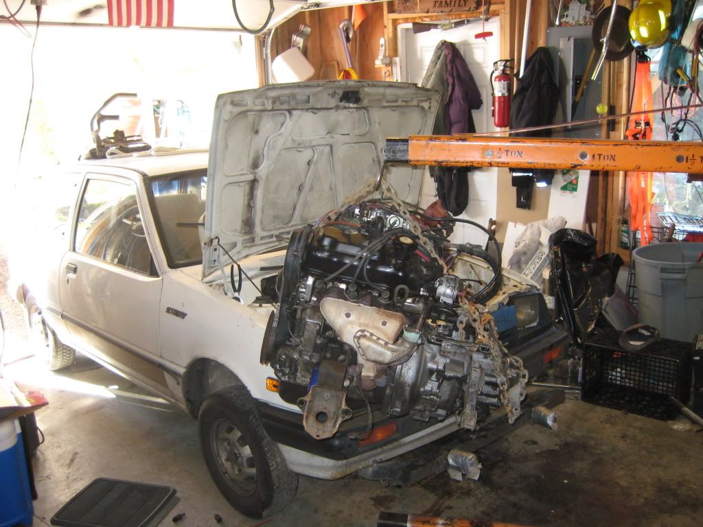

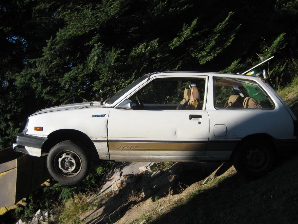

remember a few month ago when i said I wasn't going to get any more car..because i had to many already..??
Yea I lied..!!
this car has over 387,000 miles on it ...some one loved this car to death talk about getting your moneys worth
last year they put alow milage engine in it out of a 88 sprint compression is 180-175-180
and the ECM is all I'm taking the scrap man well get the rest

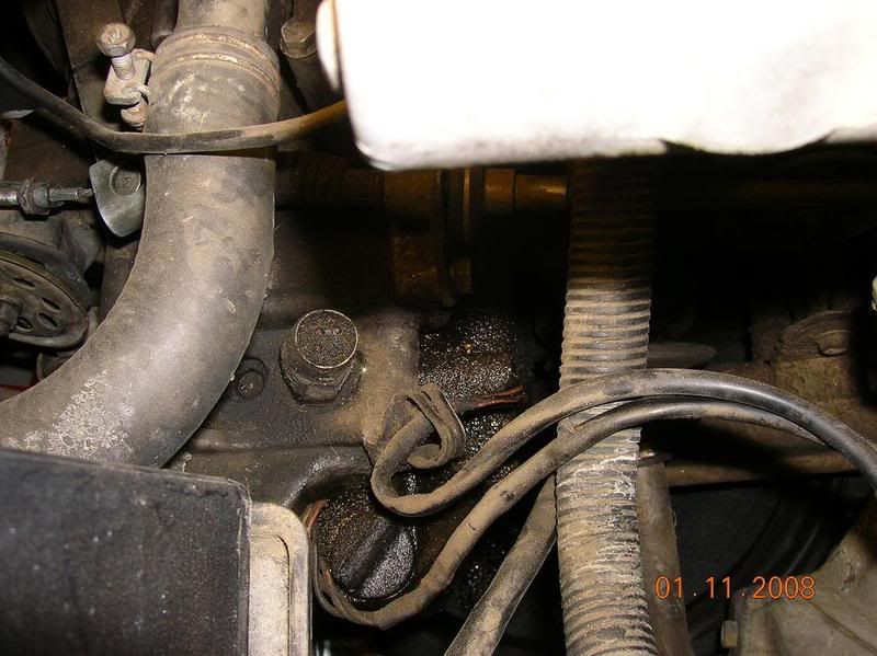

Believe me you don't want the tranny it runs but sloppy check out the goober in the gasket area
PostPosted: Sat Sep 13, 2008 5:54 pm
Yeah, I saw that orange crap.
Typical of a lousy rebuild.
Someone used some real icky gasket sealer, eh?

Does it have a shift light?
If so, I'm thinking it will have a couple of these that are intact:
Shift up switch in center of photo has the wires sheared completely off.

no sir that switch is for the back up lights....
PostPosted: Sun Sep 14, 2008 1:25 pm
Well well well...
I finally gotcha.
That is the switch which tells the gear it's in.
Either 3rd or 4th, depending on whether the button is down or up.
There are two of em.
One works to tell if it's in 1st or 2nd.
In the pictures, you can see numbers I, II, and III.
III is the back up switch.
I think number one is the high range (third and fourth gears) and number II should be the low range gears.
When they're all on/off (forget which) you should be in 5th, so no need for the 'upshift light'. :wink: :wink:
They were pretty clever back in the old days, eh?
My high range is caput. Either I find another old one with wires attached, or fix the one I've got....

You can easily fix that sheared wires on that switch. Just use a Dremel with a little carving point and remove material from around the two wires. Then using a soldering iron solder two new wires in. Once you finish, get some JB weld or Marinetex, mix a little and cover completely the top section of the switch and voila you have a repaired switch. Have done this many times with excellent results.
Hope this works. Thanks, luiso16 :D

Thanks luiso16.
I had thought about fixing it just that way, but haven't done it just yet.
Will post the results when I give it a try.
Again, thanks!

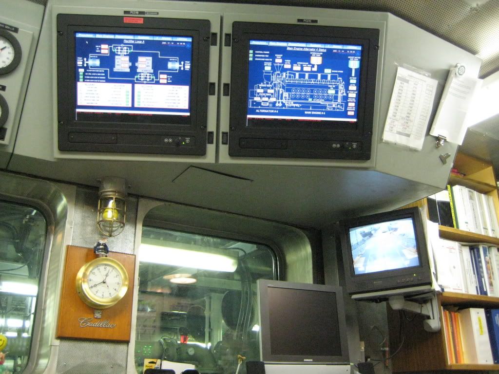

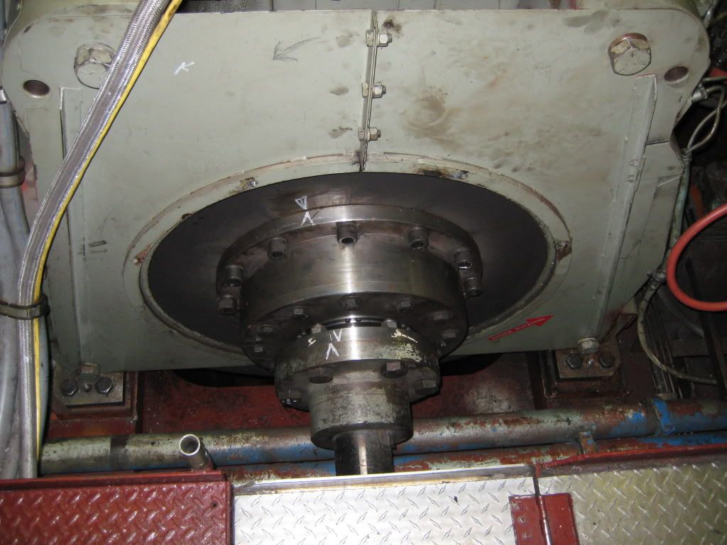

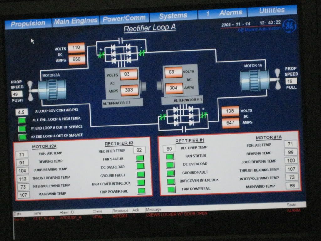

And spending Mo time at work

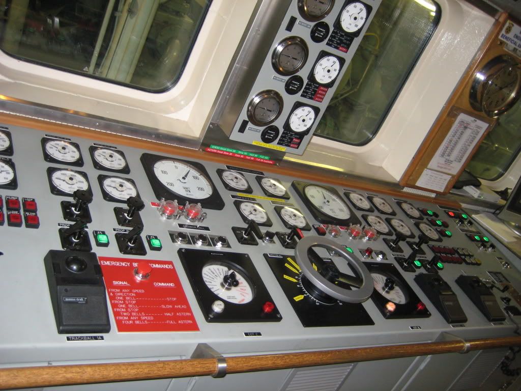

My other dashboard

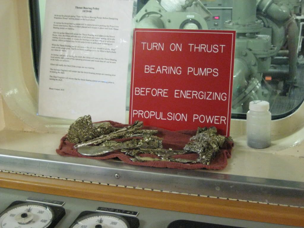

Talk about having a bad day
(not my handy work)
