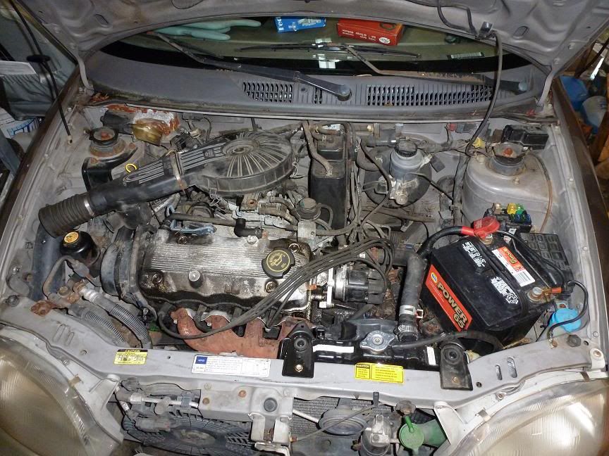

Recently my '97 1.3L TBI (110k miles) has been stalling during operation and/or failing to start. After a stall, it may take up to 10 minutes before the motor will start.
I checked that there was spark (which there was) and took the opportunity to replace the plugs, cap & rotor. I also replaced the fuel pump and checked that the fuel filter (which was replaced two years ago) was not clogged. I started the car and it ran for about four minutes before dying. This continued with the motor sometimes restarting or taking a good 10-20 minutes before it would start.
While it was failing to start, I took the air cleaner off and watched the injector while a friend cranked the motor. There was no fuel coming out of the injector - even at full throttle. I checked the electrical connections for the injector and the ground on the throttle body but there was no change.
Before I order a new injector, I'd like to eliminate any other culprits that could be causing the injector to fail. Any ideas?

Okay, so the issue has still not been resolved and I'm starting to get a bit frustrated. To recap, here is what I've replaced:
1. Distributor Cap & Rotor (Replaced)
2. Ignition Coil (Replaced)
3. Fuel Pump (Replaced)
4. Fuel Filter (2 years old, removed and blew through it - no restrictions)
5. ECM / ECU (Replaced)
6. Fuel Pressure Sensor (Replaced)
7. Ignition Ignitor (Replaced)
7. Pickup Coil (Replaced)
8. Idle Air Control Valve (Replaced)
9. Fuel Injector Resistor (Finned Aluminum behind left shock tower with yellow connector)
I have done the following diagnostic work:
1. Cleared the fuel and return lines.
2. Checked and cleaned all grounds.
3. Checked fuse sandwich box (under dash)
What could be causing the motor to shut down after 20-30 seconds of idling? Again, I am able to restart after 15-20 minutes but the same thing will happen. It dies quickly as though the fuel stops. Could a faulty TPS sensor be shutting off the fuel? Injector?
What do y'all think?

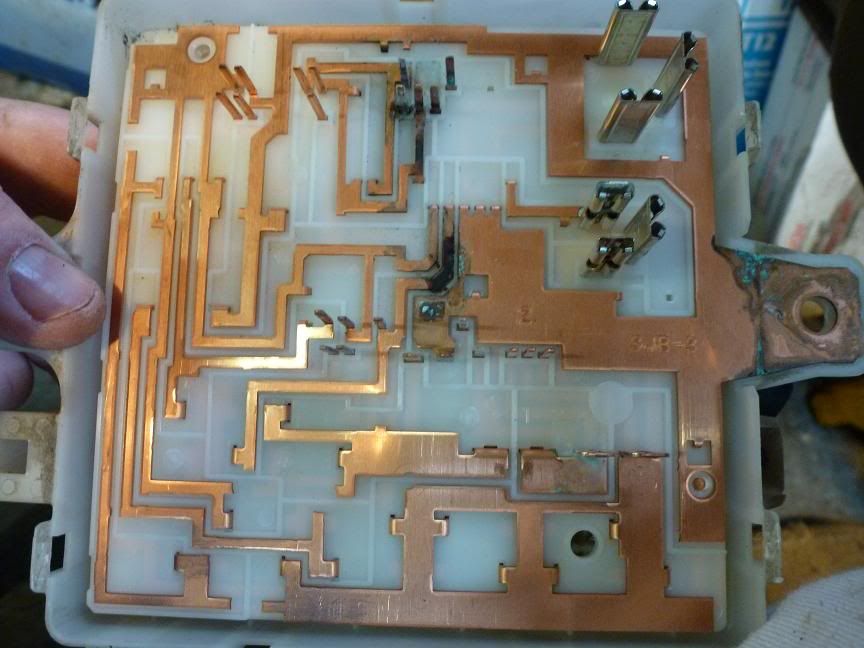

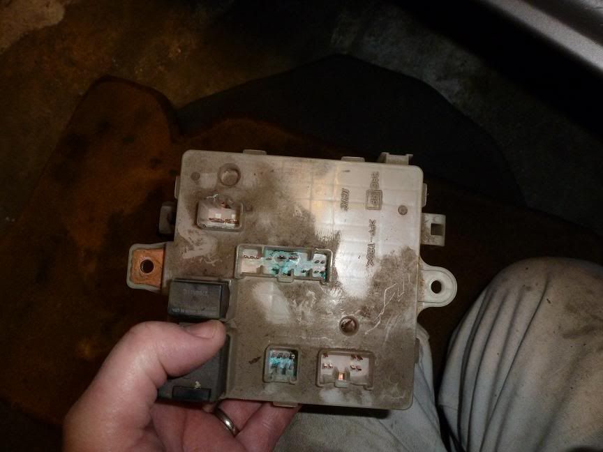

I had similar symptoms a few years ago to yours. After intermittent failures shortly after cold start/warm up, I checked everything other than the fuel injector itself. After a few weeks of inconvenient stalling in traffic, I bought a used injector, and took the old injector out and took them both to a fuel injection/turbo service shop. They tested and confirmed the old injector was shorted. (explains why it took a few minutes after engine warm up before failing). They disassembled my used injector and did a cleaning for about $30 and did not charge me for testing the old one. I now keep a known good injector in my parts bin for this sort of test scenario. (Pic n Pull charges I think $7 for a used fuel injector)
PostPosted: Tue Dec 23, 2014 12:17 pm
Joined: Wed May 12, 2010 9:30 pm
Posts: 53
Location: RedState4Ever
That was it! I pulled the injector (right) and the housing was collapsed, the o-ring disintegrated and I imagine the unit was shorting causing gas to back-up. I pocketed a used injector out of a junked Geo at Pick-A-Part (left) and popped it in. Viola! Problem fixed. Thanks.
