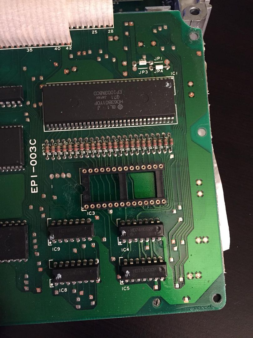

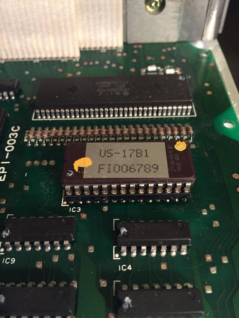

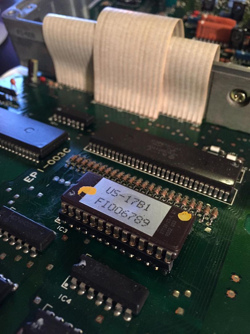

I just did one of these recently and took a few photos. If you are ever doing this job and need a reference here are some pictures.
This is where the socket goes...
And this is what the final result will be:
If you look at these pictures closely you'll see that the chip in the socket here is the original chip, I just wanted to point out that if you do the job correctly the original chip will not be destroyed and is still available as a backup if you ever need it.
