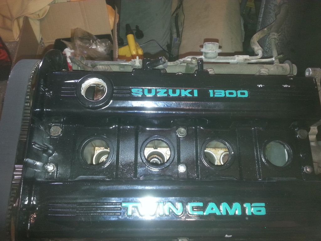

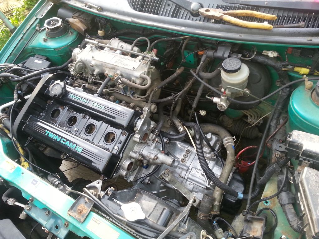

so I am swapping a g13b from an 89 gti into my 95
fully rebuilt, arp rod bolts, arp head studs, .5mm overbore flat top pistons. bd10 profile cams
g16 oil pump
after 2 months of working on it in my spare time, a friend came over and the motor is finally in!

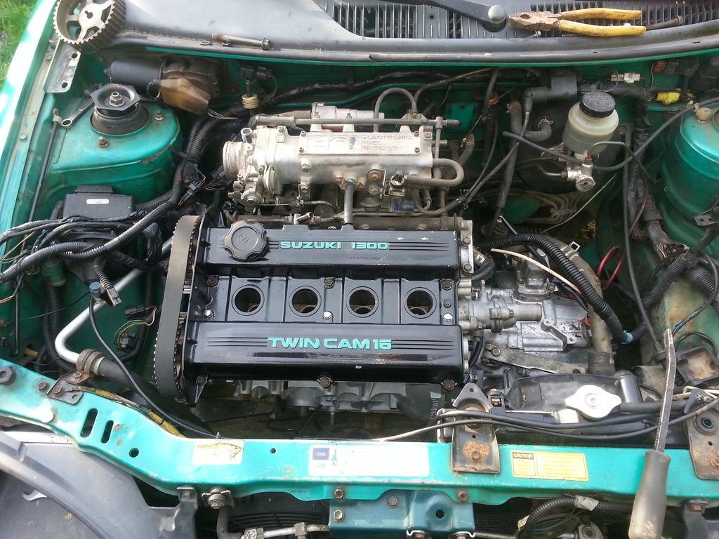

Microsquirt for engine management, so I will be working on the wiring next. I also have to modify the trans mount on the drivers side as only one stud from the mount lines up with the trans bracket.

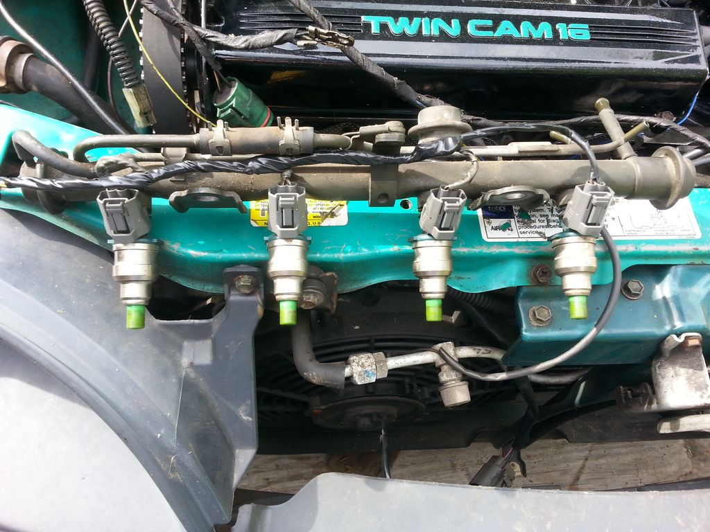

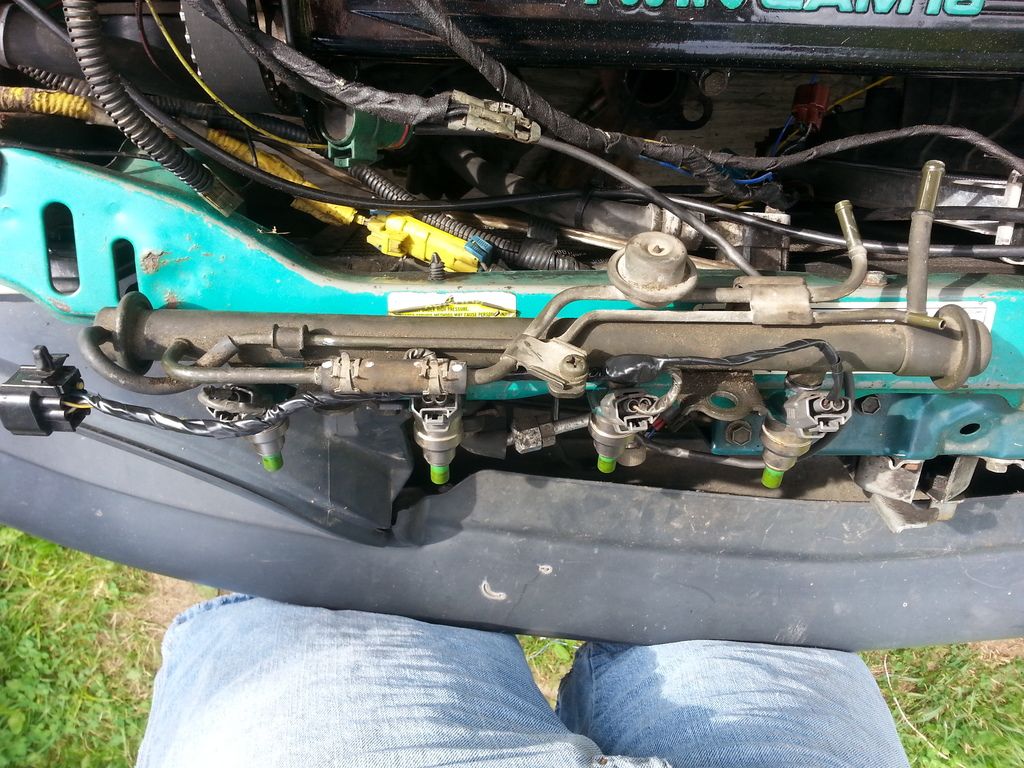

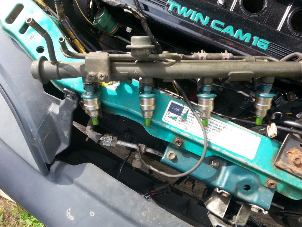

have made a little more progress on the car, microsquirt can only drive one low impedence injector, or 4 high impedence injectors per channel. stock gti injectors are low impedence, so I would have to run resistors, or swap to high impedence injectors. I opted for the latter, selecting a set from a 97 suzuki esteem. I used the harness from a 2000 esteem, modifying the injector clips so that it would have a single disconnect to ease in possible future troubleshooting. the injector pintle caps I wasn't a fan of, so I removed the pintle caps from the stock gti injectors, and used them with the new injectors.
anyway, on with the pics
