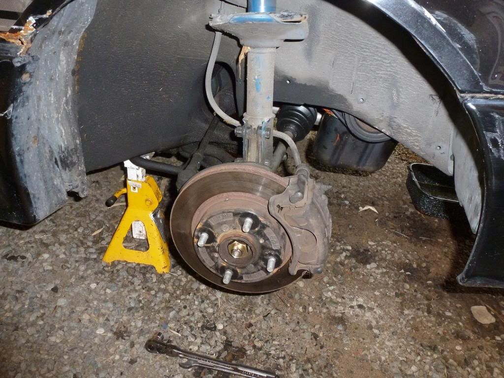

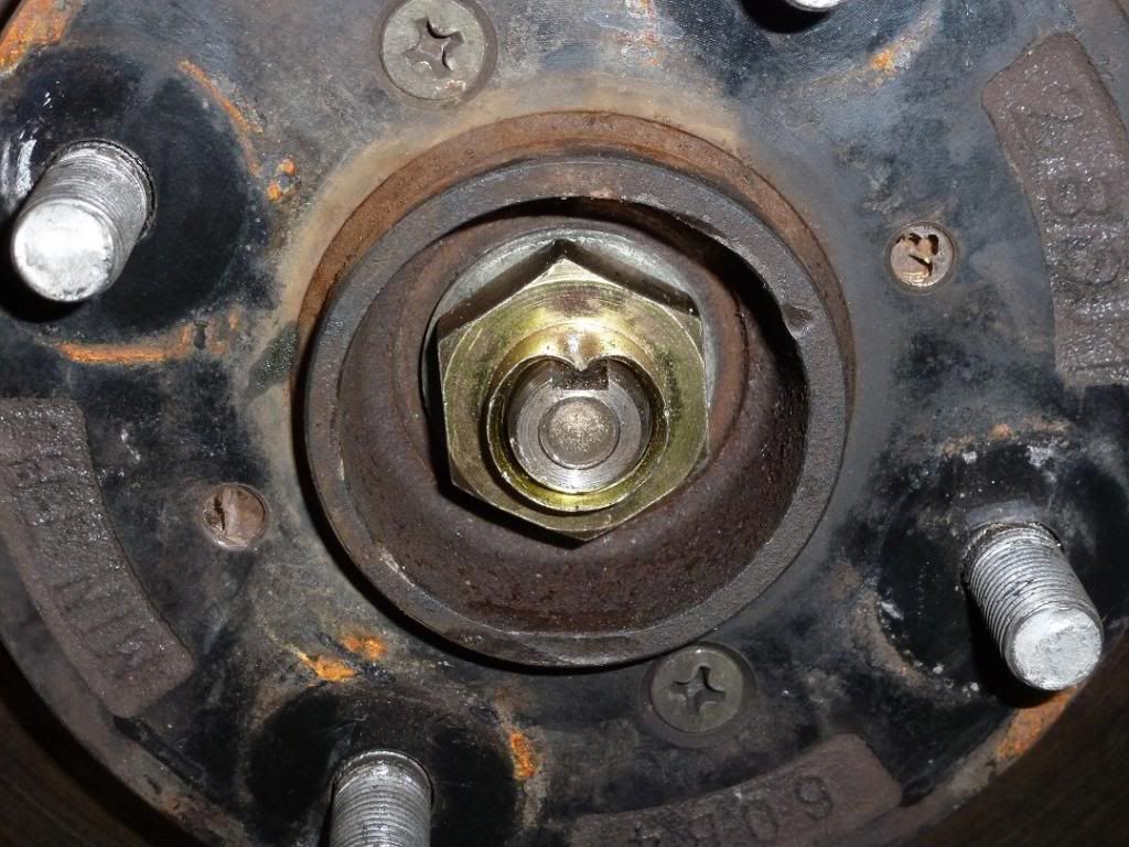

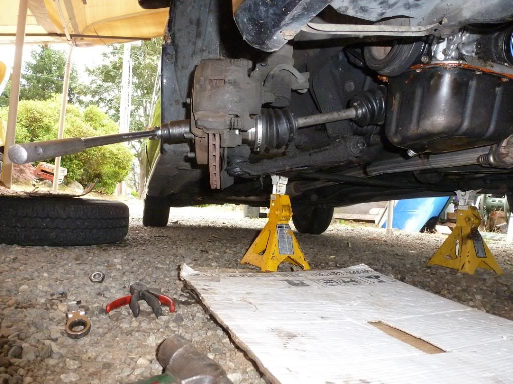

remove center axle nut with 30mm socket
loosen lug nuts 17mm socket
jack up car remove wheel

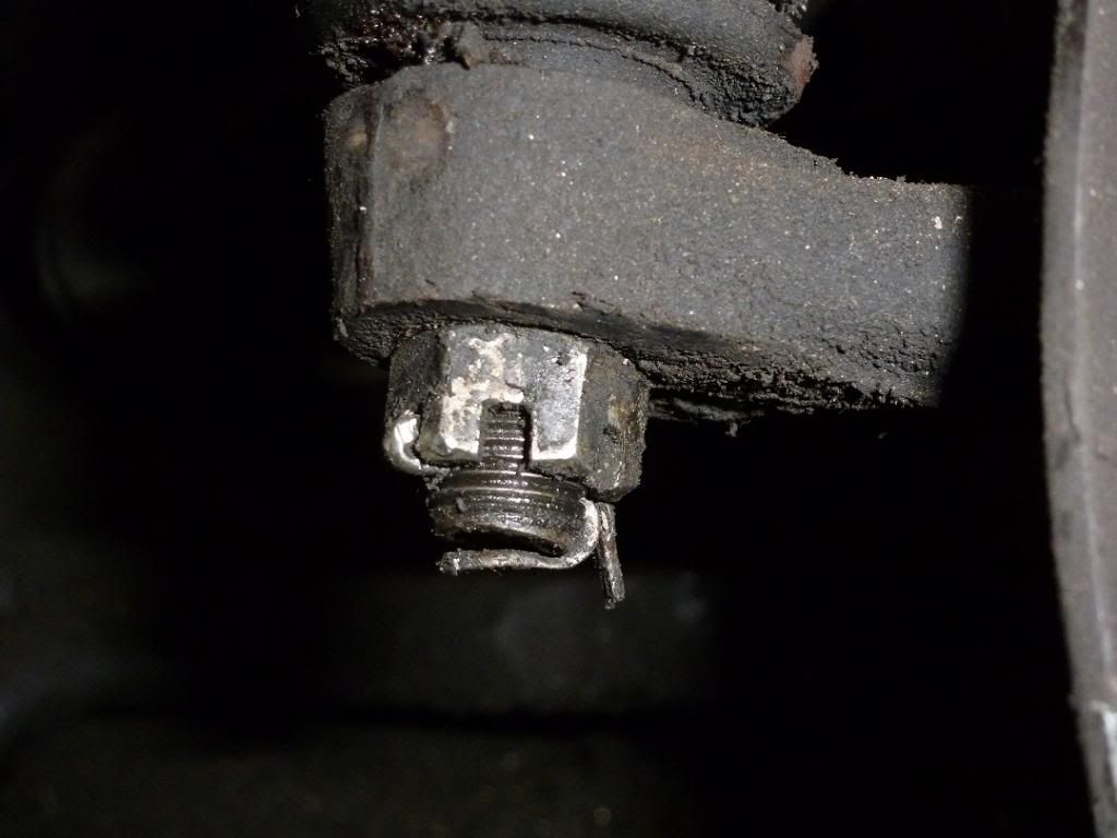

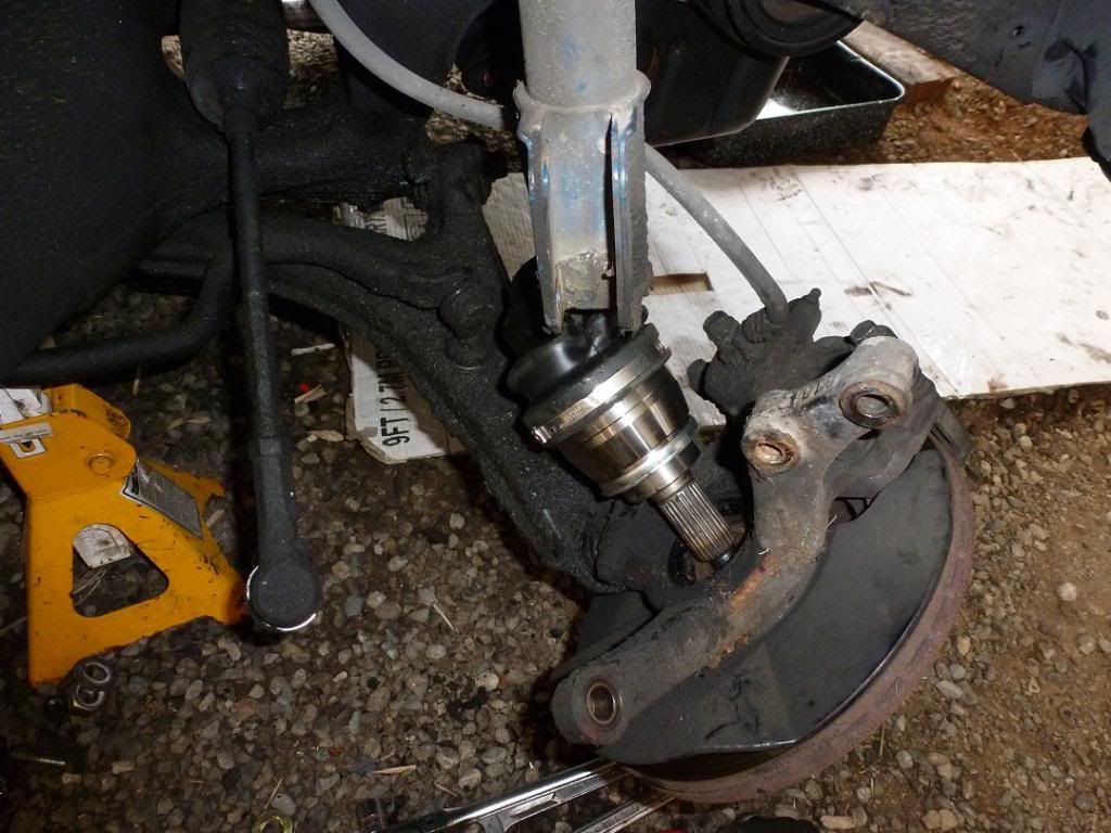

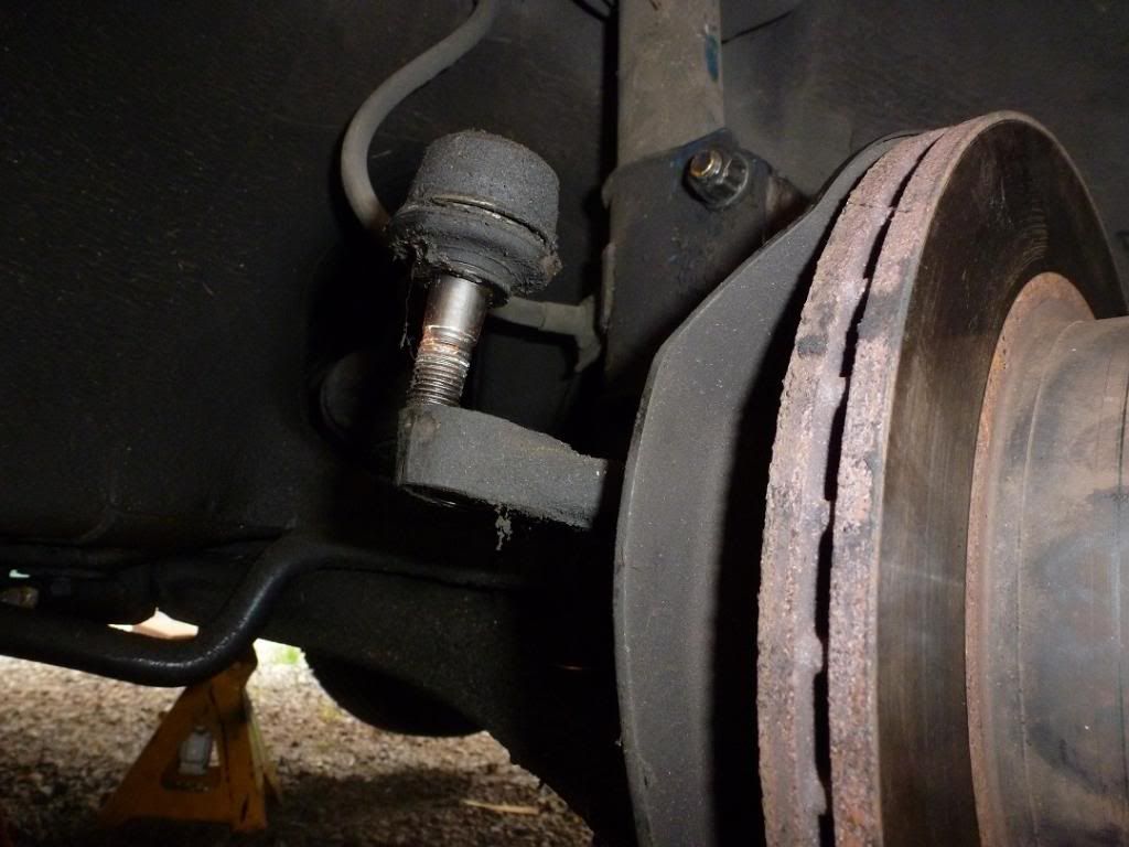

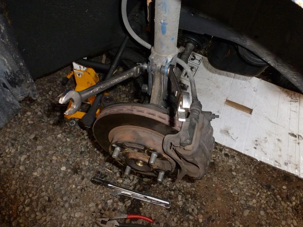

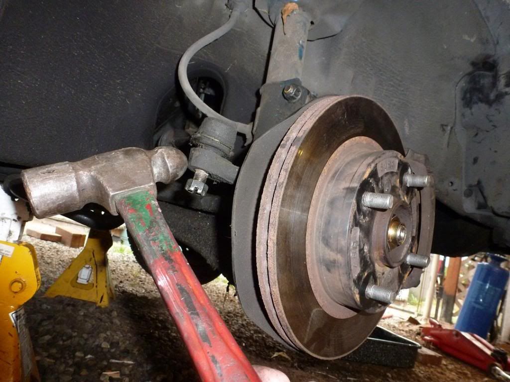

Tie rod remove cotter pin loosen nut 17mm .Hit tie rod arm with hammer tie rod should pop loose

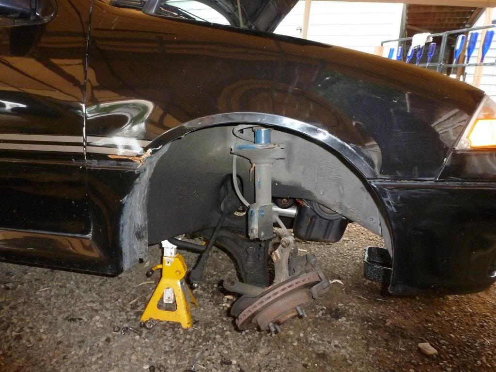

remove two bolts on strut tower swing away wheel knuckle asmbly

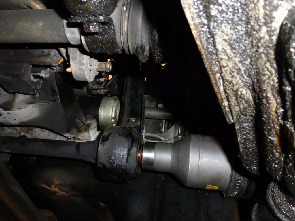

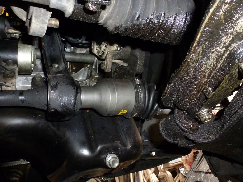

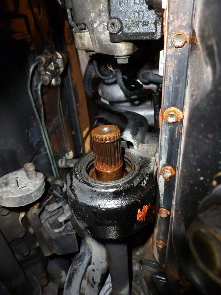

Under Car pry axle out of axle carrier pull axle out

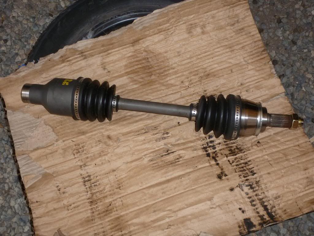

Install new Axle set larger end in carrier section push hard till you hear a snap verify that the axle is set in
the carrier
the other end place into the wheel knuckle asmmbly
place the two blot back into the strut
place the tie rod back into the tie rod arm tighten nut install cotter pin

hand tight the outer axle nut w washer

troq the axle nut to 75 LB and center punch nut inplace tighten lug nut to 50 lb
