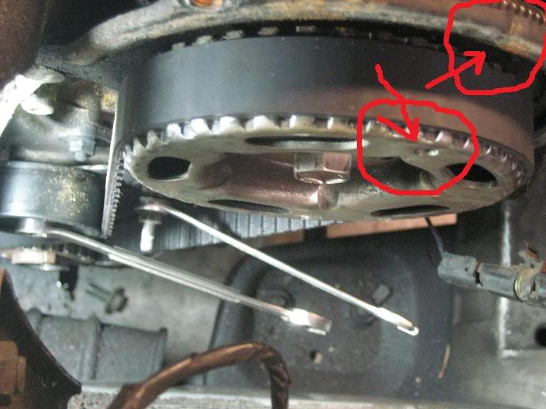

I am about to replace all the belts on my sprint, but I kind of know how to do the T-belt Ive read the manual but haven't actually replaced one before. It says turn the #1 piston to TDC, How will I know if I have it turned to TDC?

on top of the little tin plate (very top of head)there is a knotch like a stanp indent
on the cam gear ther is a line or extra hole line those two up look at the valves and cam the valve will be closed if you rotate the cam gear by hand you will see the exhause valve begain to open
let me see if i got a picture

Awesome thanks! that helps a bunch
