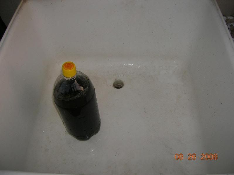

If you soak those pistons in 'Simple Green'
overnight you won't need to clean any carbon out of the ring grooves, because the solvent seems to dissolve it all away.
Also, you won't need to hit the tops up with a wire wheel, but just an old toothbrush.
I'm not sure if the solvent attacks any special piston coatings, but I don't think so.
How about this for an 'Okie Hot Tank':
It's just a 2 liter soda bottle which has been cut about 270 degrees around the top, allowing you to drop the whole assembly in.

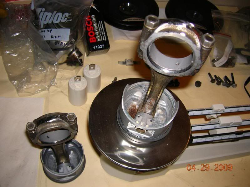

Here's a set that sat in a 2 liter soda bottle:
And they never saw anything harsher than a toothbrush to finish them up!!!

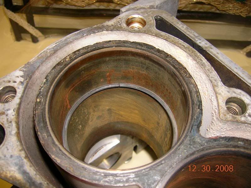

JM mentioned the ring gap testing.
Here's a picture of the before:
and during ring end gap measurement:
It can tell you how much life is left on your block.

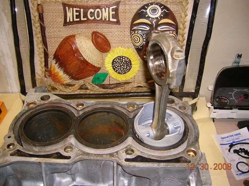

One of the nice things about JM is he uses the exact same technique as I do with the wooden handle of the hammer trick:
