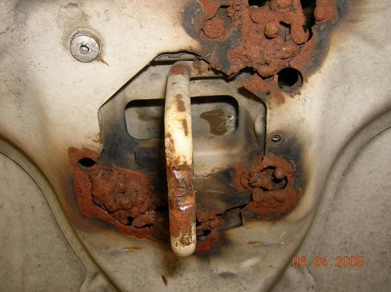

PostPosted: Mon Apr 06, 2009 2:13 pm
xrw44 wrote:
check hood latch welds for cracks.
Gee, do you think I should fix this?
PostPosted: Mon Apr 06, 2009 4:36 pm
Joined: Tue Apr 29, 2008 8:06 pm
Posts: 1445
Location: Atlanta GA 30052
the pop rivet looks secure.
