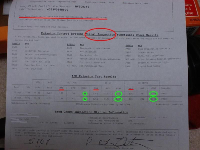

PostPosted: Tue May 10, 2011 11:52 pm
Car: 1987 Chevrolet Sprint 1.0L, naturally aspirated.
-California Air Resources Board (CARB) catalytic converter (Magnaflow)
-New MCS in carburetor
-Timing at 9 before TDC
-no vacuum leaks
-fairly low compression:
even so, she blew pretty clean.
viewtopic.php?p=372368#p372368
This car was not in a special 'test only' category, but like the man said, these tests seem to be 'coming soon to a theater near you'. Using your home tools, some careful thought, and some luck, you can pass any test they throw at you!
It blew lower than average in all but the low RPM HC.
CO was 0.00/0.01 (low RPM/hi RPM)
NO was 108/42
Tech who ran the car was pretty impressed with how clean it blew.

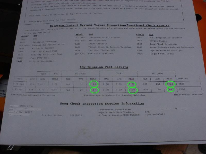

Now let's test a DOHC:
Today, this one blew about the same as the three cylinder above (HC 84/42 vs 99/57)
and the NOx is about the same.
It has a brand new CARB compliant cat, just like the one above.

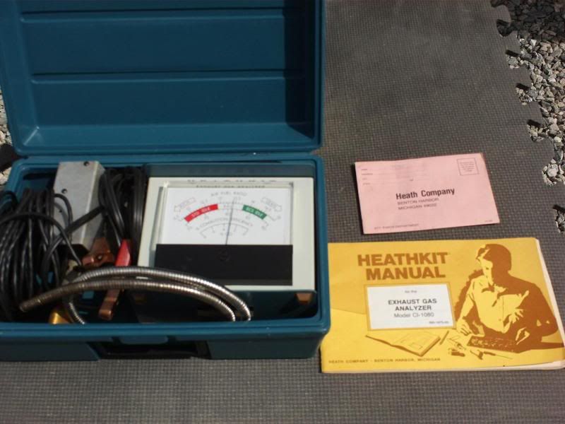

Try using one of these:
to check the CO coming out the exhaust before you run it down to the smog shop.

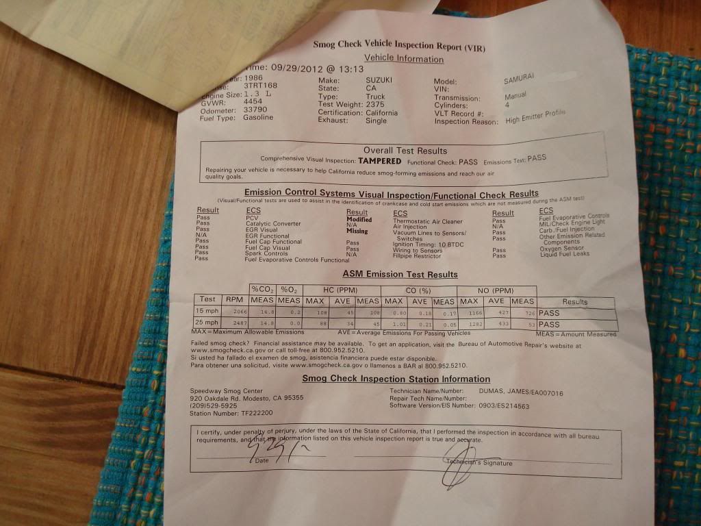

Vehicle: 1986 Suzuki Samurai, 1.3l 4cyl with Hitachi DFB306 carburettor.
MY first try. I failed due to the vacuum check valve missing on the vacuum line going from the TCAC thermostatic control to the intake manifold.
I replaced the check valve and returned promply.
The only things I could see causing these emissions is the original 26 year old MCS and an EGR valve that has a minor leak. Otherwise, I welcome your criticism.
1986 Suzuki Samurai - in the works
PostPosted: Sun Sep 30, 2012 4:14 pm
Thanks for adding to our database with your 1.3L '86 Samurai test results.
Not bad for a 26 year old vehicle!
How old is the cat?
PostPosted: Sun Sep 30, 2012 9:47 pm
Joined: Sat Feb 04, 2012 10:00 pm
Posts: 41
Location: Modesto, CA
The catalytic converter is probably original. When I had the exhaust apart the back end of it looked clean and white. I could not see the front end at the time. By now you probably all noticed the 108ppm HC on my first 15mph run. I cringed when I saw that the max was 108ppm for HCs. :shock: fortunately it did better on the second run. 8)

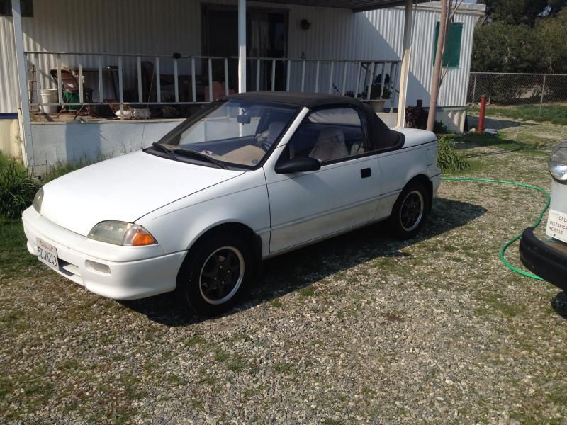

PostPosted: Tue Sep 20, 2016 1:08 pm
I'm worried that California will confiscate my vehicle after yesterday's smog test.
It's almost an electric car type result!
Here's the vehicle:
93 Geo Metro.

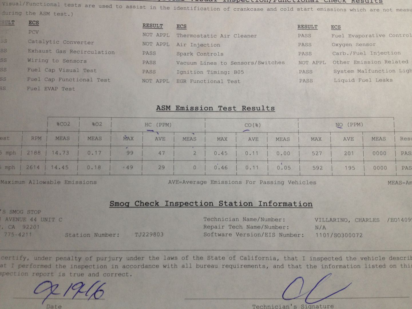

Here's the test:
A few months back I replaced the timing belt.
Over the weekend, a new Magnaflow 332005 converter was installed.
Otherwise, the vehicle is bone stock.
Additionally, I had a new resonator installed because it has been running a straight pipe in that location for a few years - (we couldn't afford one previously).
It has been fed Mobil 1 since the rebuild back in 2007.
No regrets, looking back.
And I'm NOT a big vert fan.
But this car chooses to burn clean as a whistle years into the rebuild and 184,000+ miles on the clock.
Low speed: HC 2 parts per million and nothing in the CO and NOx.
High speed: 0.05 parts per million CO and nothing in the HC and NOx categories.
:shock:
And - engine noise is practically nil at highway speeds.
That's one heck of a catalytic converter.
$200 installed.
How low does your engine blow?
:twisted:

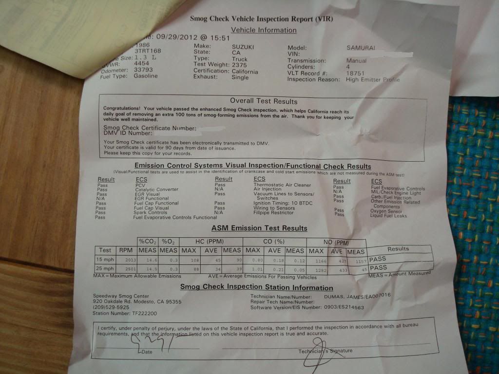

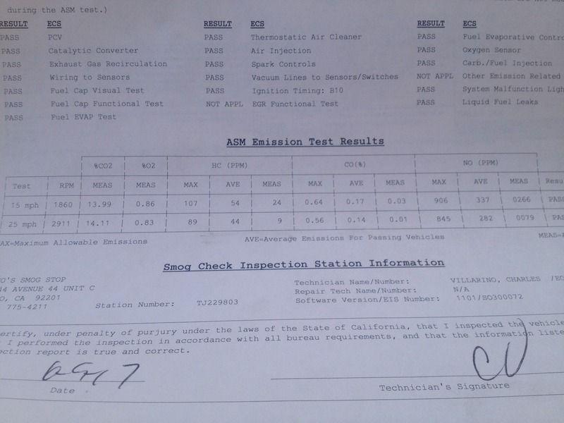

His HC 12 vs. my 24 at low speed is significant. His high speed HC 6 vs. my 9 doesn't make me feel as bad, but the State of California smog sniffer told me what I suspected:
even though the car runs smoothly, there is room for improvement and an obsessive compulsive mechanic/technician would swap in a fresh carburetor.
HC is the unspent/unburned gasoline coming out the tailpipe. If I can get that down, it should translate to better fuel economy.
Most people use the dollar sign to dictate what to do: if I put a rebuilt carburetor on the engine, how long will it take to pay for itself?
Let's estimate a rebuilt carburetor would increase my mileage by 5 miles per gallon.
Using 10 cents a mile as a normal ballpark operating figure, a 6 gallon fill up would net a savings of about $3 per tank.
To get $300 in savings, I'd have to drive a good 100 tanks.
Figure 300 miles per tank times 100 tanks, that's 30,000 miles to break even (if I paid $300 for a rebuilt carburetor).
Now you see why the majority of the NA versions were driven into the ground.
People were less concerned about fuel economy, and would only change carburetors if they caused severe driveability issues.
Continuing with the test results:
His CO .01 vs my .03 at low speed is almost the same. High speed we again almost tie: his - .00 mine - .01.....very close.
Carbon monoxide is low on both cars, so we almost tie.
Last the NOx, which is the bane of many a DIY enthusiast.
His Nox 117 vs my 266 at low speed probably signifies my cat is getting old. The high speed results of (him) 4 vs. (me) 79 are quite significant.
Probably my catalytic converter has been working longer than his, has processed more exhaust, and may be losing its original efficiency.
(Like me, ha!)
To be fair, with test results like that, both catalytic converters work fine, and do not need to be changed.
You could conclude that my car's cat has lost 30% of its efficiency.
Thus, looking at a smog test result when purchasing a car can tell you if you will need to buy a catalytic converter.
Smog test results are also an impartial 'third party' way of finding out the overall condition of your powerplant.
You would think the more powerful Turbo would burn dirtier than the humble NA, but you can see from the above results that although both burn pretty darn clean, a turbocharged engine can indeed outperform a carbureted version both on the street and in the laboratory.
Wizewun, thanks for doing such a great job under the hood, and congratulations for winning this round!
