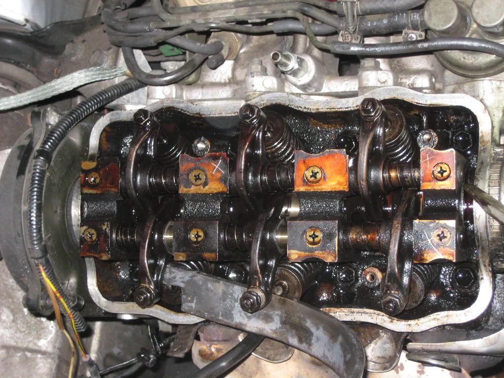

1987 chevy sprint
137,000 miles
Compression was 150-160-150

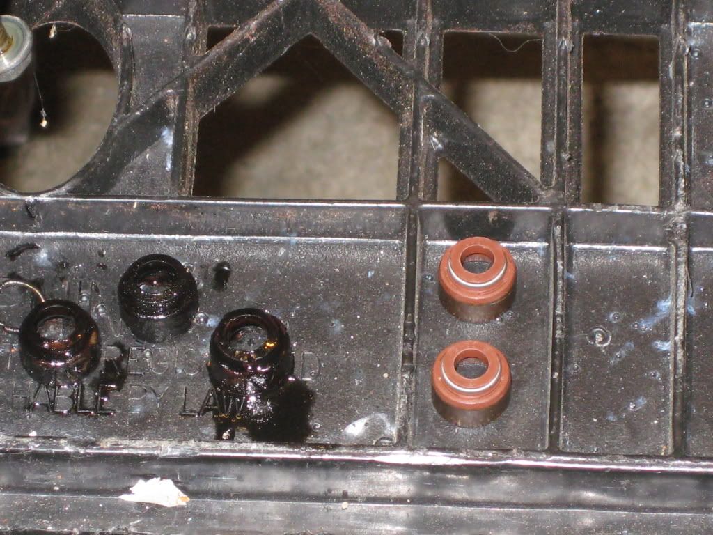

smoked on start up oil looked like gue
New and old seals

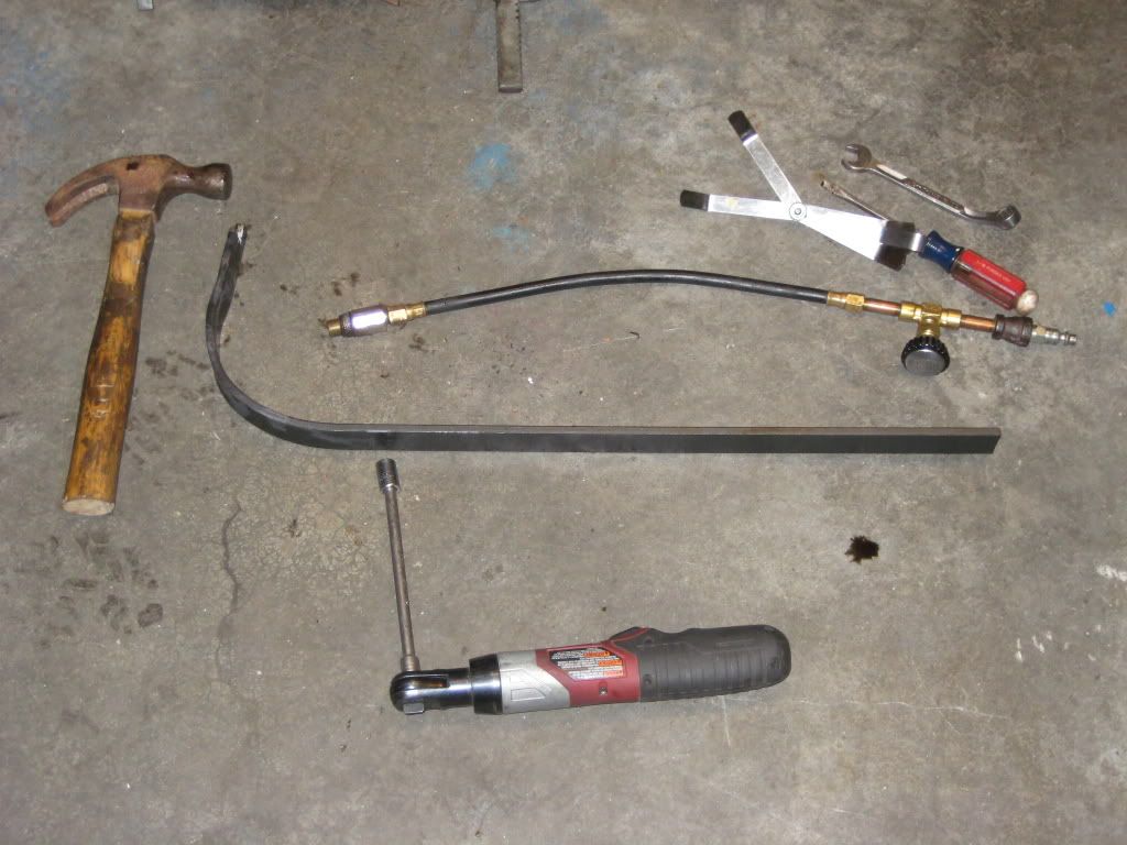

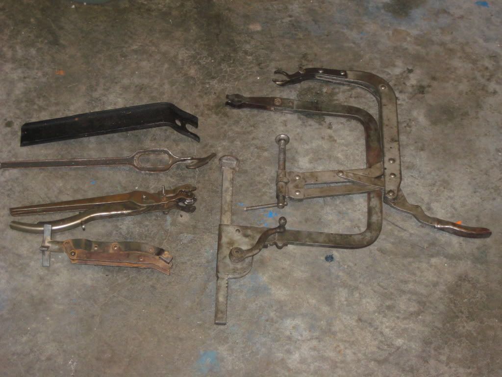

I had a bunch of valve tools but nothing would work for this job
So I made a spring compressor out of some scrap steel
here's all the tools it took to do the job
Remove the Valve cover..

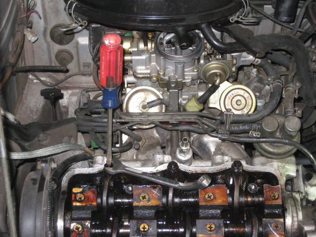

back off the tap it nut (valve adjustment nut) With the 12mm Wrench and the Screw driver

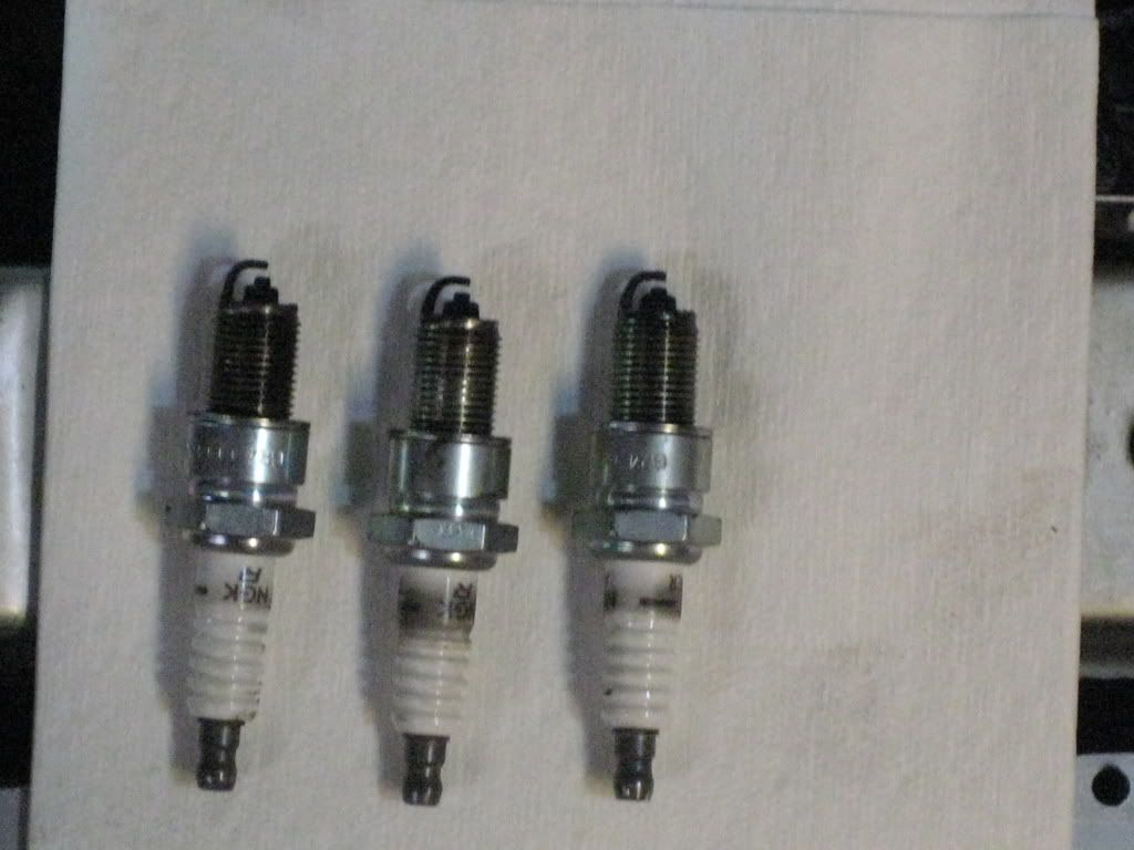

Remove the Spark plugs and screw in a hose that you can hook up to a Air compressor
so you can apply air in the Cylinder to hold the valves up while removing the svalve springs
Hit the top of the Valve spring to loosen the clips
Then use home made valve spring compressing tool
Remove the Clips and Valve spring

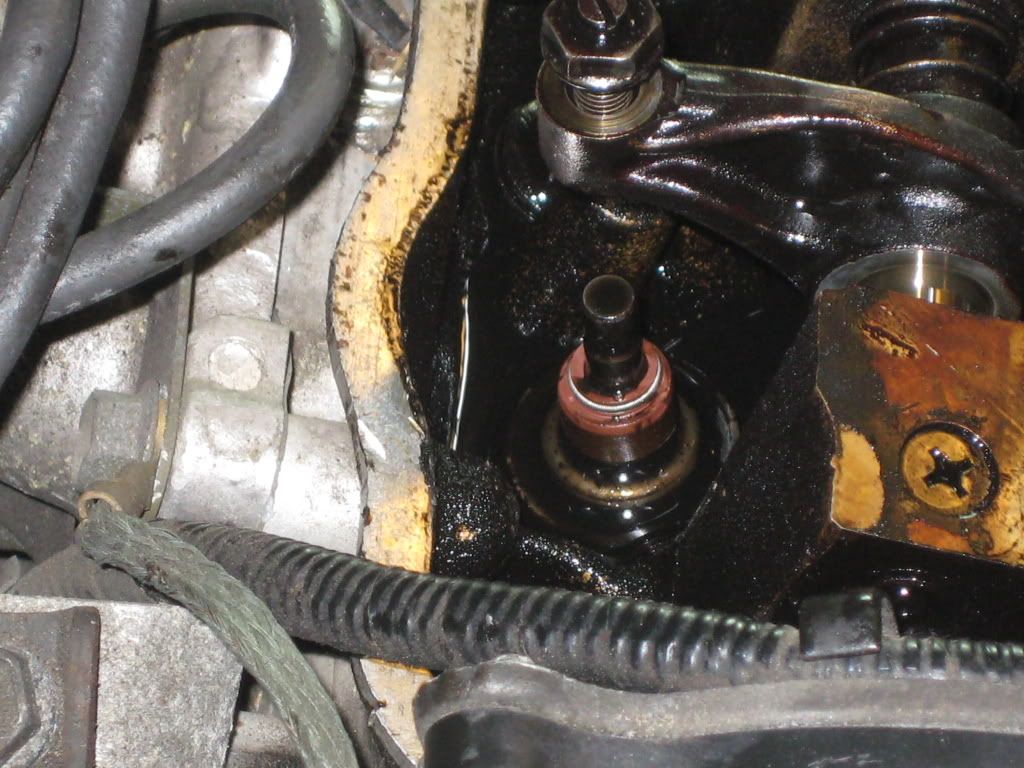

spry off the old seal with screw driver install new seal
reinstall valve spring and install clips

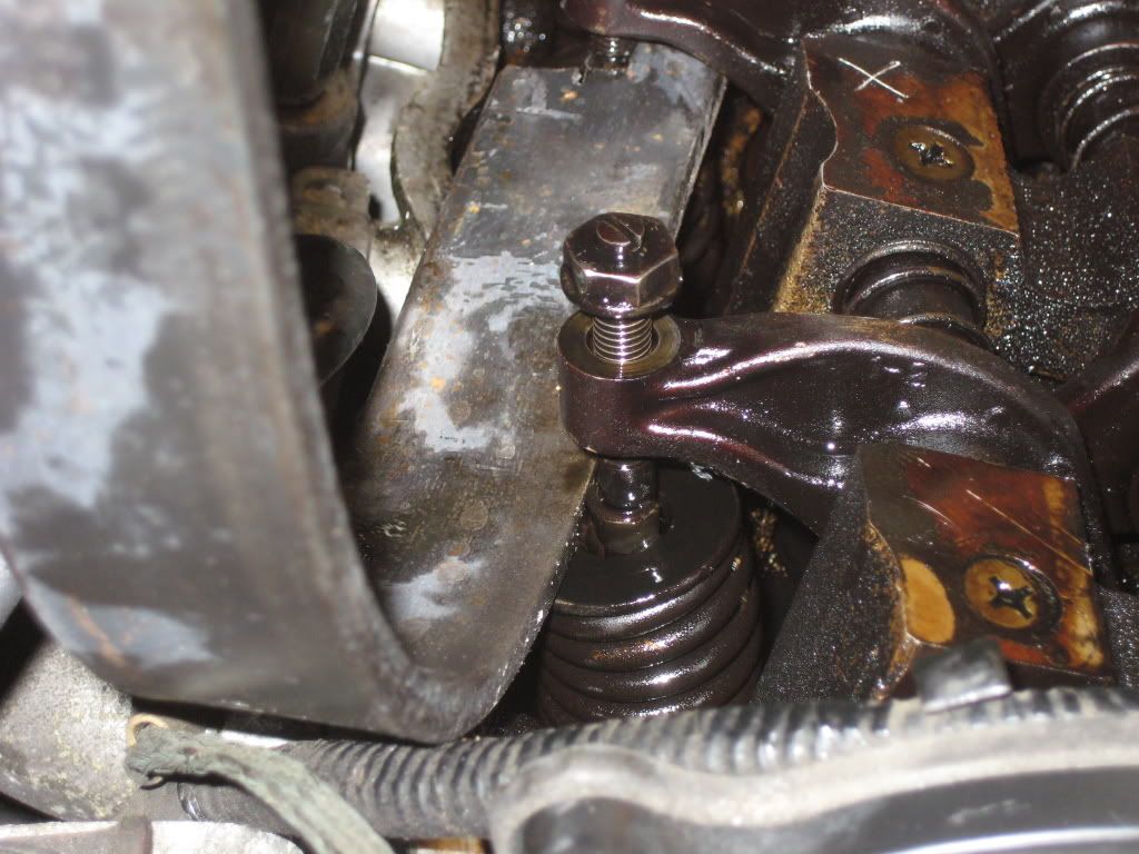

Tighten valves down to spec using a feeler gage
While the car is in gear you can roll the motor slightly to make sure the valve's are not on a camshaft lobe
Intake...-.017
Exhaust..-.022
reinstall the valve cover

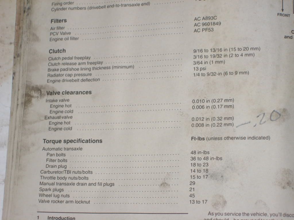

Nice write up. Now, after you did all that, did it stop the engine from smoking on start up like it did before you changed the seals?
And it's a little tough for my simple mind to remember your 17 and 22 values, as I was thinking 6 and 8. Now I remember why:
My manual shows it at ...
Intake...-.017
Exhaust..-.022

I have the same manual an it saids I-.017 and E-.022 too. Nice write up though and with good pictures. How much were each vavle seal?

And to think we just adjusted Dale 50000's valves at 6 and 8 :roll: :roll: :roll: :roll:

In all fairness to Dale, he had the valves set around 8 and 10, so once we tightened em up to 6 and 8, wow! It was sure quiet. His 85 has the following shift points in miles per hour:
