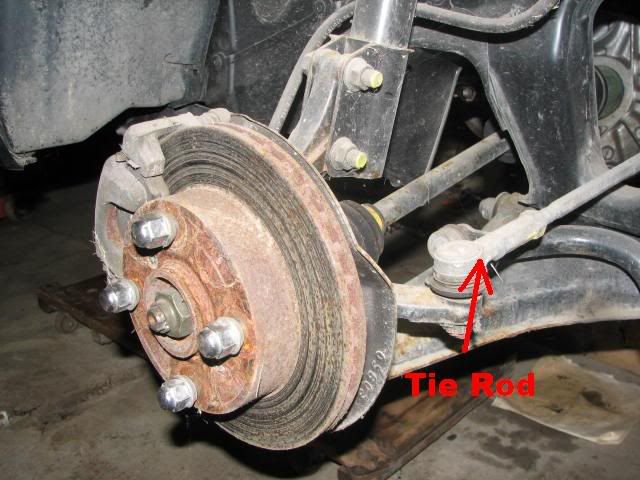

Reference pic below..................
Now you are done under the hood for now. Next thing is to get to the axle shaft removal.

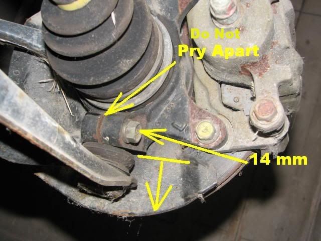

Remove the lower ball joint pinch bolt (14 MM bolt)
Use a chisel to spread the pinch area and pound down on the control area to separate.
Pull the complete knuckle outwards and push axle through until free

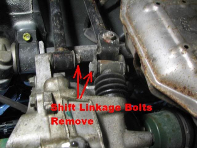

Directly behind the trans under the car, you will find the shift rod linkage and the brace. These may look like ordinary bolts and nuts, but I found out removing these were actually the hardest part of the entire job! These are actually pins going through a bushing and if they are seized up, use lots of penetrating oil and strike the housing part (eye) many times with a hammer to break up the rust. The shift rod link a double joint (not the kind you roll) and you can take it off from either location. Heat is not recommended and don't even try whacking the threaded side with a hammer unless you have a nut on it flush.
After getting this far, it's time for a short break to collect your senses and thoughts so you don't screw up.

You totally don't need to remove the axle nut... both halfshafts can be attached to the knuckles while you do this. I've done a trans removal several times with no removal of axle nuts. It's a little awkward to make sure the shaft is in the right spot, but it saves you havin' to break out the impact hammer... In fact, i see you removed the brake caliper and pads aswell... again, unnecessary. If you just remove the two bolts that mount the strut to the knuckle, all this becomes superfluous, and you are left with your knuckle intact. It's connected by the brake line, and that's it, so it's easy to maneuver the knuckle to position the shaft.
This thread has an excellent write up, albeit lacking in those quality pics that yours had. I've used this walkthrough whenever i've done tranny work, and it's quite efficient.
http://www.teamswift.net/viewtopic.php?p=82299#82299
Anyways, good write up, other than those unnecessary steps :D

I took a couple of pics of the shift linkage and also the ball joint pinch clamp before being taken apart:
Shift linkage:
Ball Joint Clamp:

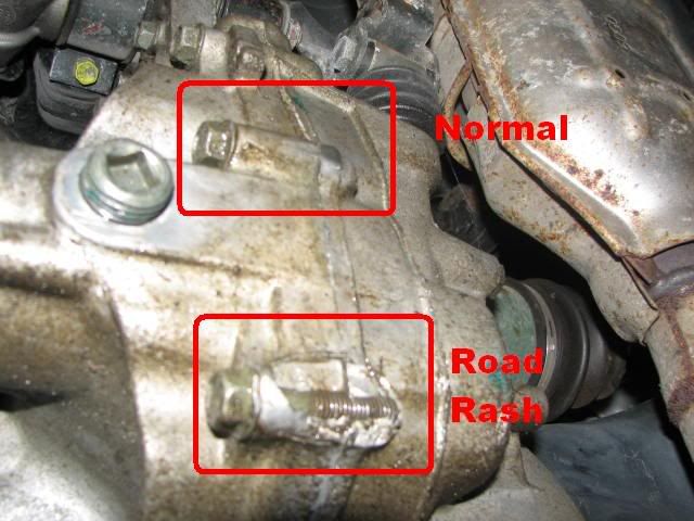

One more question: the car is a rebuilt salvage. I'm taking the transmission out because the bearings are making noise. I really didn't want to because the case has road rash:
I really do not like the idea of taking it apart but I have no choice. Should I try to track down a case from another trans or can I get away with using sealant on the case seam? It wasn't leaking before and isn't now. That drip on the good bolt is from draining the fluid.

PostPosted: Mon Jul 13, 2009 1:22 am
You should try and track down another case. Once you split it, I don't thing you'll be able to get it to seal like in the 'old days'.

Thanks. Good point. The shop that rebuilt the car had me check out the damage before they put it in. We talked about it and rather than put the money into another transmission, we figured that since the case wasn't leaking, the odds were I was going to drive the car for years before I would ever need to take the trans out, if ever. Of course the input bearing started making noise on the ride home. Go figure, right? =)
I ended up taking the motor and trans out together and have them separated now. I am considering installing them separate, transmission first, then fitting the engine to it. If I do it this way, I can easily fit the axles back in, attach the trans to its mounts and then lower the engine gently to mate with it with my hoist. Being supported by the hoist I can use one arm to rotate the crank to get the splines to match up. Still thinking on it though. It's a little hairy with the hoist when I had both engine and trans coming out. Any thoughts on this?

PostPosted: Mon Jul 13, 2009 2:55 pm
Yeah, two.
First: If you are working alone, you might try to lift the front of the car, and slip the engine/transaxle combo in from underneath. It's a bit easier, and not as hairy as dangling the whole mess 6 feet in the air.
If you've got the set up, fine, but if not, slipping it in from below is slower, but safer. You will need to clear all the suspension, but if you don't have the manifolds on, it's a piece of cake. Measure it first to be sure.
Second: Deebee came down from Oregon and wanted to learn to split a case. So we set a pallet on 4 upside down trash cans, put the case on top, and using hand wrenches took 60 minutes working slowly to completely take apart the transaxle. He stopped along the way so I could take pictures, but you can read all about it here:
viewtopic.php?f=9&t=42589
So if you decide to get any junker tranny and split the two cases, you should be OK. Just follow that thread; there are no tricks. The second tranny should take you about 20 minutes to split...honestly.
It's also a good idea to replace the input shaft seal while you've got the cases split. It's a cheap seal, but it can ONLY be changed from inside the case.
Not trying to hijack Mullet the Man's thread, but once you get the trans out, you might need to split your case. So there's a link on how to do it, complete and with expert comments from our friends in the Southern Hemisphere, who can split those cases in 10 minutes!
Sorry you ran into transaxle problems. Just like a bad engine, a bad transaxle can ground a car, too.

I do want to note that I dropped the control arm on the passenger side per fordem's recommend and I think it helped a lot. I also tied up the hubs on both sides to the spring to keep pressure off the brake hoses.
