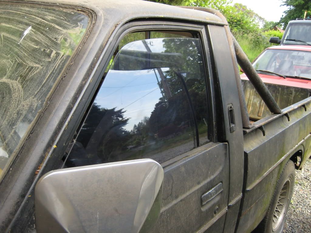

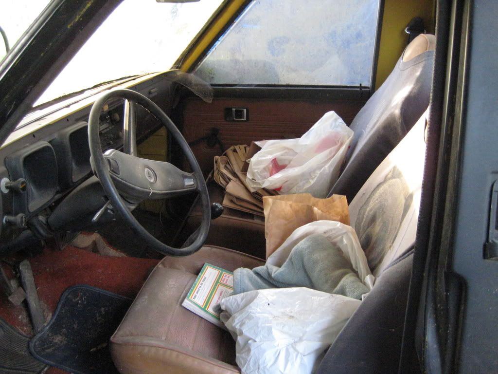

I put some low grade tint on my 1975 toyota p/u in 1988 (20 years ago)
beside the dirt and scratches the tint is ok...heres a dirty picture
----GV&S
 Post subject: Re: Tint your windows
PostPosted: Sun Jun 01, 2008 8:35 am
here's some more pictures of a tint job I did in 1988 (20 yrs old)
on my 1975 toyota P/U
still looks good today a little scratched and dirty but ok
(Note how far i cut the edge on the tint)
it worked just looks amaturish but in my defence the tint didn't delaminate :D

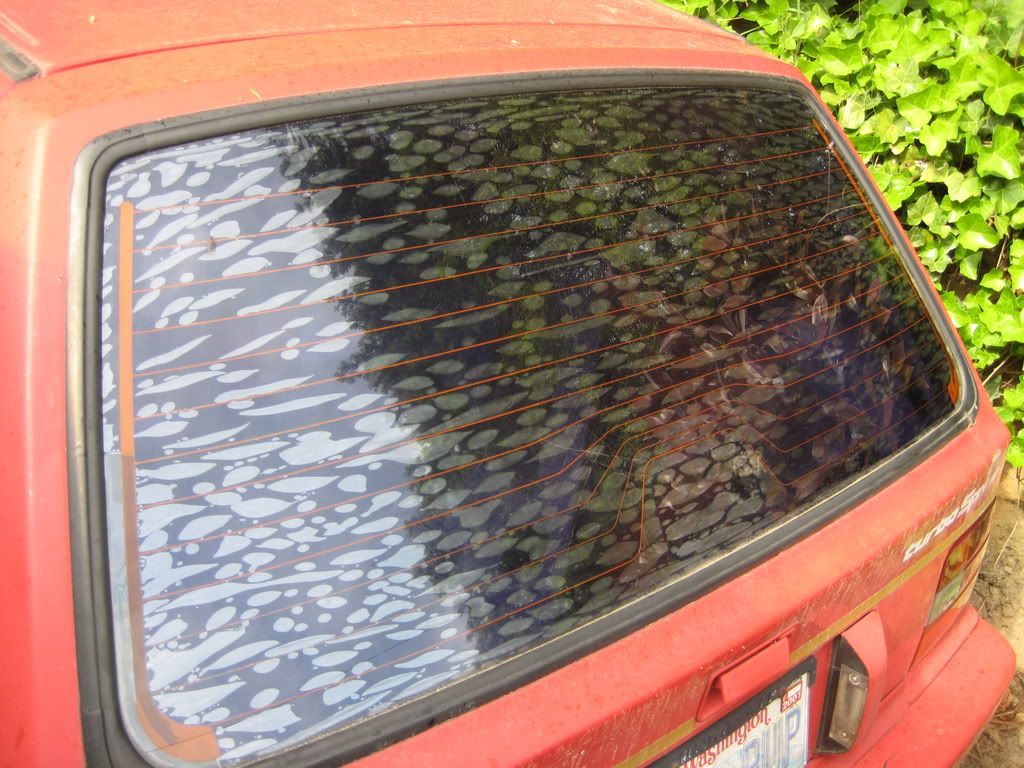

Here's a picture of a MK1 i just got this is what happens when you don't get all the water out when installing the tint on the windows... this can be taken care of (remove the bubbles ) you can use a squeegie and a heat gun but because of the age of the tint it will be distorted after its fixed !!

The bubbling on the Turbo Sprint is what happens if you leave a nicely tinted car in the direct sun here in the desert, day after day.
My concern would be the rear window defogger.
How can you remove the tint, and not hurt that defogger?

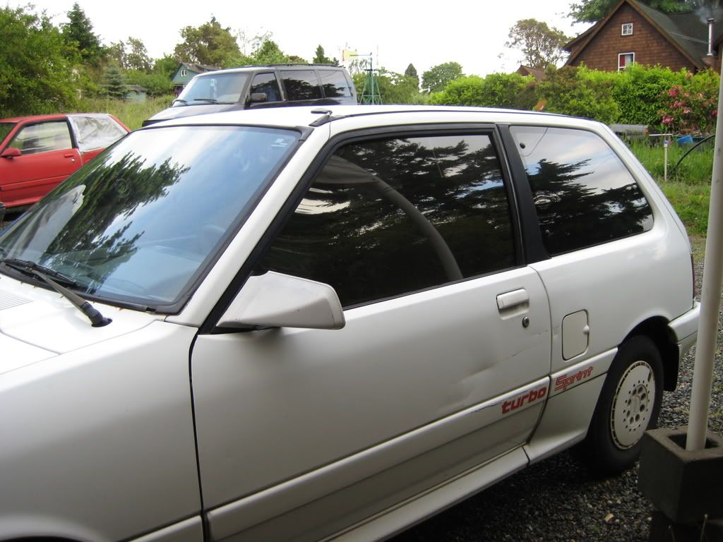

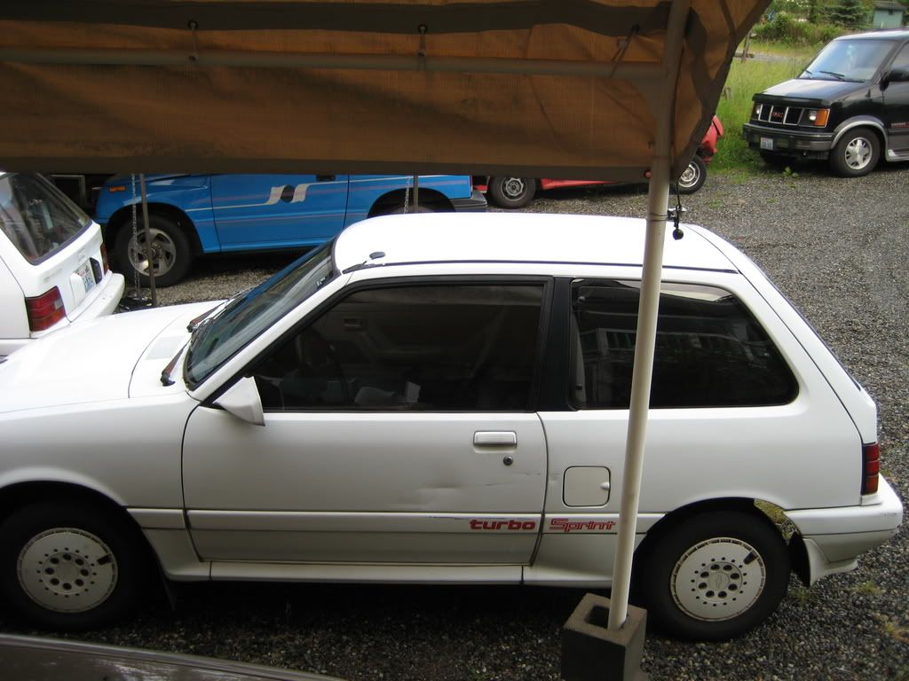

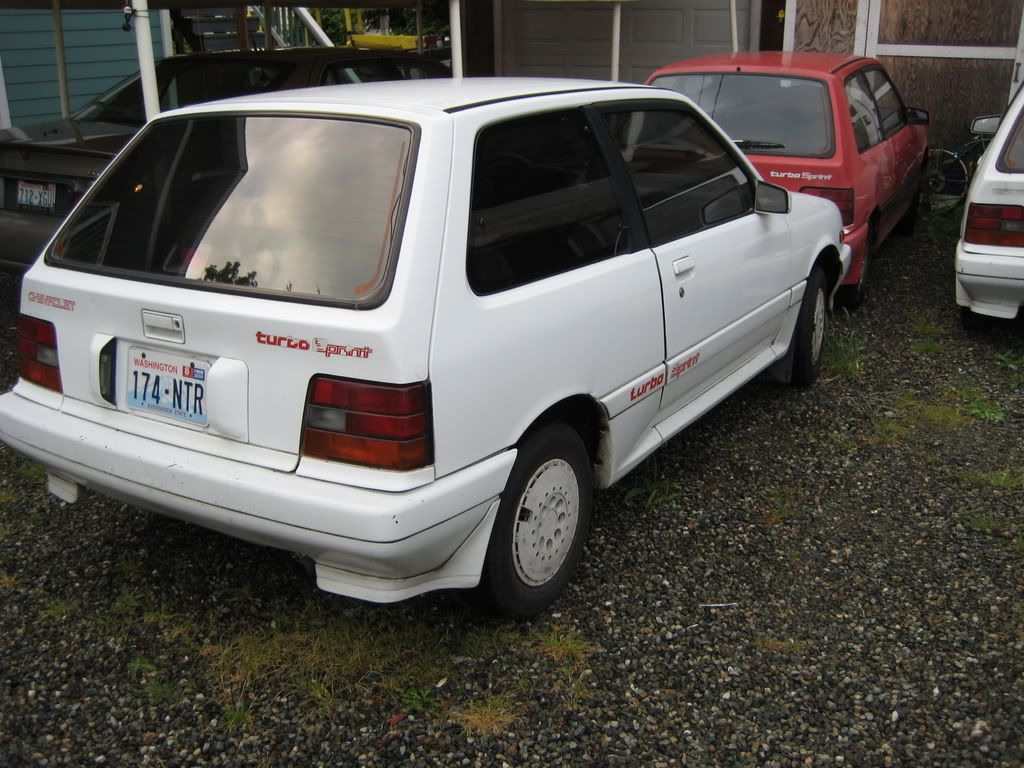

I finally finshed the tint job
Here's the latest pic's
