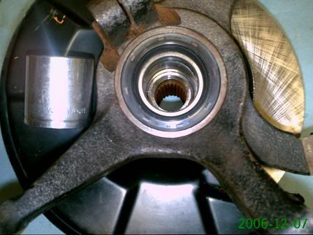

One way to do it involves removing the tires, etc until you get to this:
One of the tricks to get to that point is to remember the raised portion in the center (centre) of the hub which is not removable. You will need to punch out the old bearings using this technique:
You can put the first bearing in like this:
The final seating can be done something like this:
but be careful not to damage the plastic seal cover, and tap down the inner and outer race evenly until the bearing seats against the inner knuckle raised portion.

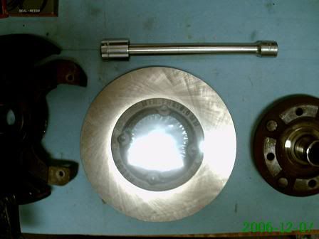

And that lets you get the hub ready:
You'll need to install the rotor at some point. This might be a good time.

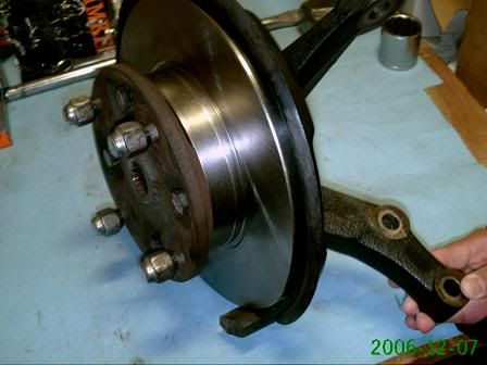

Get a new rotor:
And you can easily attach it:
Then you can use a 1 1/4 inch socket to tap it back together:
Leaving you with this final assembly.

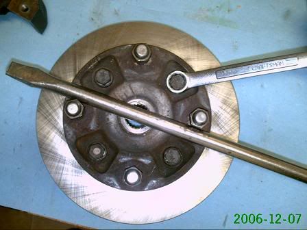

Once you get the hub assembly out
you should see the spacer. It needs to be moved. If it moves freely, fine. If not:
You can use a "C" clamp to move it far enough off center to get a rod on the inside race of the lower bearing. In your case, you would want to flip the assembly over to get the outside bearing. This shows the process for the inside bearing. In many cases, it is the inside bearing which wears out.
Now we see the spacer out of the way, and the clamp removed:
This should allow you to either press the lower bearing out, or for those either in a hurry, or not rich enough to own their own press, you can tap out the lower bearing.
Note the placement of the metal rod; it is below the spacer, and on the inner part of the bearing. Once you get good at this, you can pop em out without even damaging the bearings.
